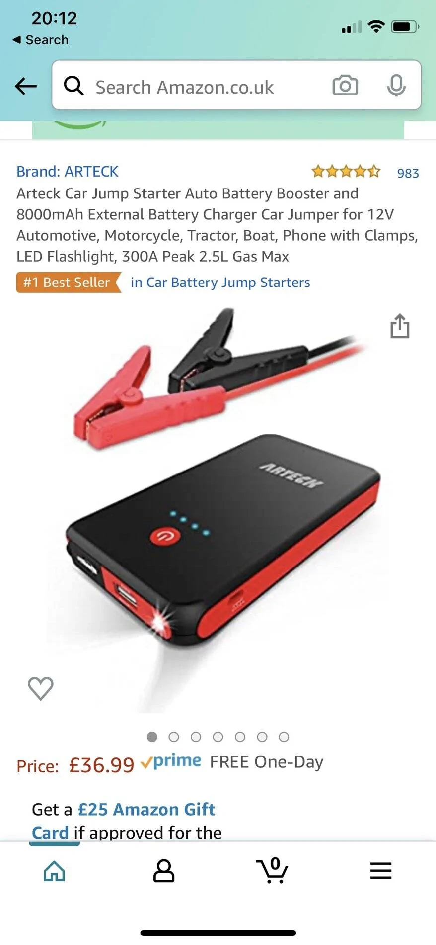

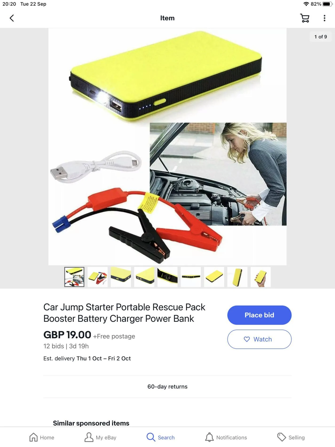

I have one of these in my glove box, had it a few years for other things and as a power bank for the kids. I think it’s a good insurance policy that I never have to use to jump the Taycan.
Perfect. Just ordered something similar, like you I’ll keep in the glove box charged up.

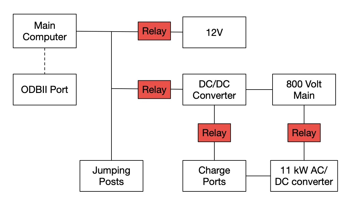

this picture is conceptually accurate - but technically simplified and may lack exact details…
Porsche Taycan Car is Dead Screen Shot 2020-09-30 at 10.49.44 AM
once the car is dead - _ALL_ the red-boxes are computer controlled relay's that have "tripped" - meaning they have disconnected their components from the electrical bus - they will _NOT_ receive any power from the main 12V bus until the main computer "resets" the relay and reconnects those components to power…
the jumping posts are the only documented method to "power" the main computer to reboot the taycan - and it's not clear/documented that you can provide enough power via the ODBII port to reboot/power the main computer…
so far the _ONLY_ documented method to recover the taycan (Porsche's own documented process) is to provide a 12V external power source via the jumping posts in the frunk…after that gives power to the car it recover's itself…
again I stress jump starting a Taycan is NOT charging or jumpstarting the 12V battery - it's providing power to the Taycan's computer which reboots the car and reinitializes everything and which point the vehicle recover's itself, and will charge the 12V battery if it deems it necessary with power from the 800V main battery.
