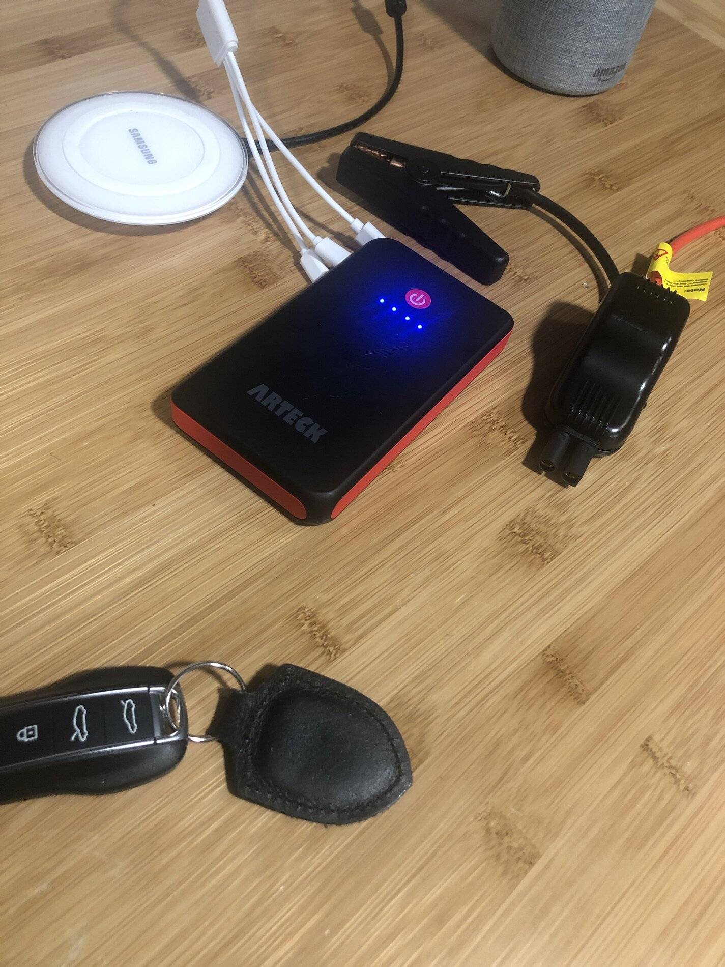

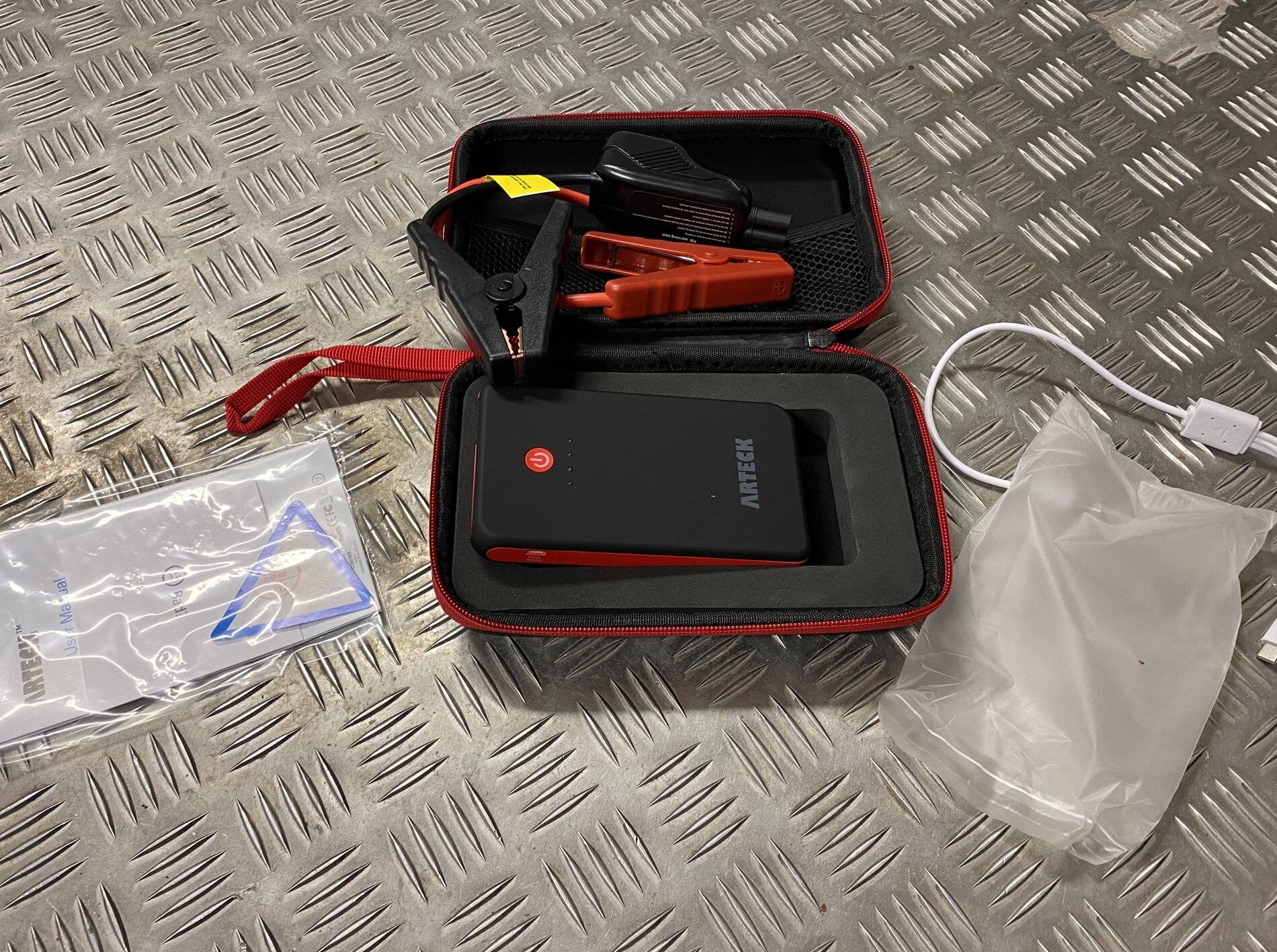

Got to love Amazon Prime! All I need now is a car......Last seen sitting at Emden!
