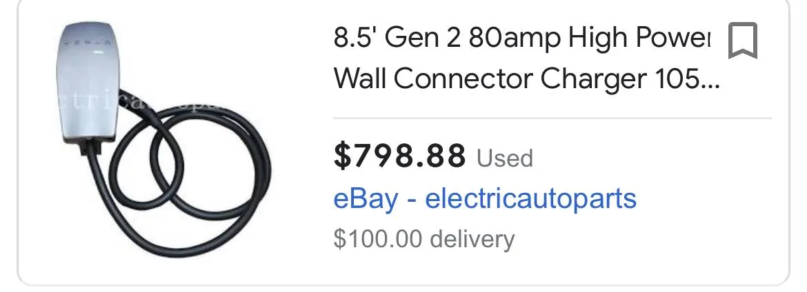

Those would typically be 2nd hand though, right? Meaning no 30% tax credit. Plus the need to purchase an 80A Tesla Tap.
My EVSE was $840 (with the credit).
Porsche wall charger would be $1110 with the credit.
I didn’t look extensively, but it appears Tesla Gen 2 HPWC is around $800 used plus a Tesla Tap @ $250 puts you around $1050. Plus the cable is only 8.5’ (probably okay for me actually; not sure for others). And I’m not sure what the warranty situation would be on the used equipment vs new either.
Porsche Taycan My EVSE is DEAD! - UPDATE 4: reinstalled 4D2125A5-3A34-4F25-A02C-C83D61826342
I do recall someone recently buying or at least looking at one of these on eBay or something and I think it said it was still new/unopened. That would still qualify. I don’t remember the price, but assuming it’s still around $800, that’s $810 with credit and tap.
I think the Porsche Wall Charger is the best plan for anyone looking for a basic 19.2kW EVSE right now (unless they want load sharing or something).
Fair — I forgot about the tesla tap. I already had several Tesla HPWCs when I purchased my Taycan, so for me the TeslaTap was by the the best option.
