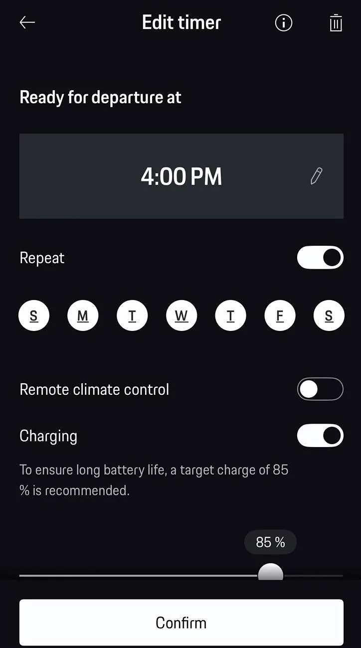

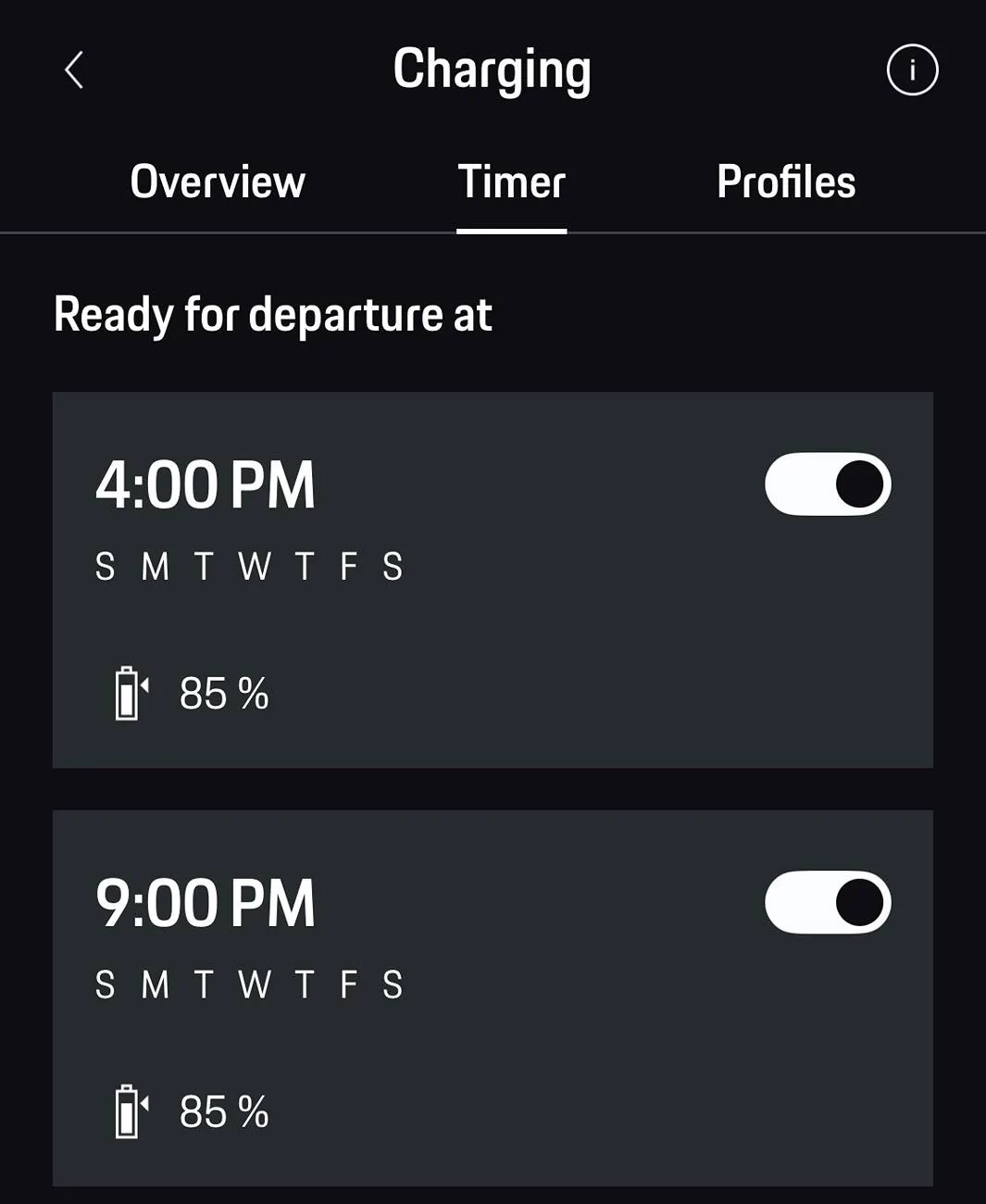

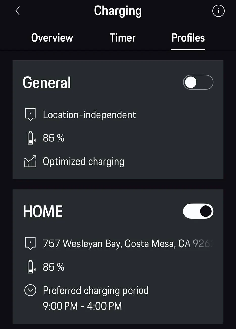

I’ve had no issues charging from 9PM to 4PM every day to 85%.
I’ve attached my charging profile & timers screenshots.
With these settings I am able to plug in my 120V Porsche charger and it will stop at 85%.
Whenever I want to increase the charge to 100% before a long trip I just change the charge percentage and then save it to my vehicle. It works every time. Good luck!
I have similar settings, but it started going crazy all of a sudden. Will try to use your exact settings (except the hours), will check in the following period (since it's very complicated to test them thoroughly). Thanks

Unfortunately it doesn't work. I want to charge only between 08:00-17:00 and only untill a max target of 85%. These are the settings I used, based on yours. At 20:42 it's still charging
The only way it works is this:
This method charges above only between 08:00-17:00 and only until 85%. It worked ok for the past weeks, however, as mentioned, last night it started acting weird: started charging at random times, between 05:15-07:20, then 07:25-07:35, then 07:50-+onwards
(screenshot is taken from my energy meter app)
It looks like you have your home setting at 25% not 85%.
This setting is for the charge percentage you want it to stop charging so this setting is defeating your home profile because you’re telling the charger to stop at 25%.
That's the "minimum charge" setting. If I set it at 85% (like I did based on your settings) it will not stop charging at 17:00 and instead it will continue ignoring my preferred charging time. You can see that in the first row of screenshots
