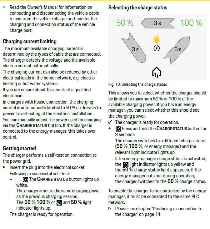

It can be adjusted, it’s just a very simplified interface. There is no transformer componentry inside the PMC+ to actively modify the current. That button is just taking the numeric amperage associated with the attached pigtail, dividing by two and communicating that number to the vehicle when negotiating a charging session.

We can debate semantics, but for the last time - the PMC+ is adjustable, to 100% or 50% of the current associated with the connected pigtail, by pressing the 50% button.
Also, if you have a NEMA 14-50 socket in your garage, on a 50A circuit, and you obtain an EVSE with a NEMA 14-50 pigtail, the most amperage the EVSE will allow the vehicle’s charger to draw, will be 40A. This is a regulatory thing - in the USA, a circuit can’t have more than 80% of its max current under constant draw. My PWCC is hardwired to a 100A circuit, supporting max 80A draw.

the breaker is _NOT_ the problem - Porsche's PMC+ _IS_ the problem - and you if want to downgrade it's settings you need to use the 50% button!

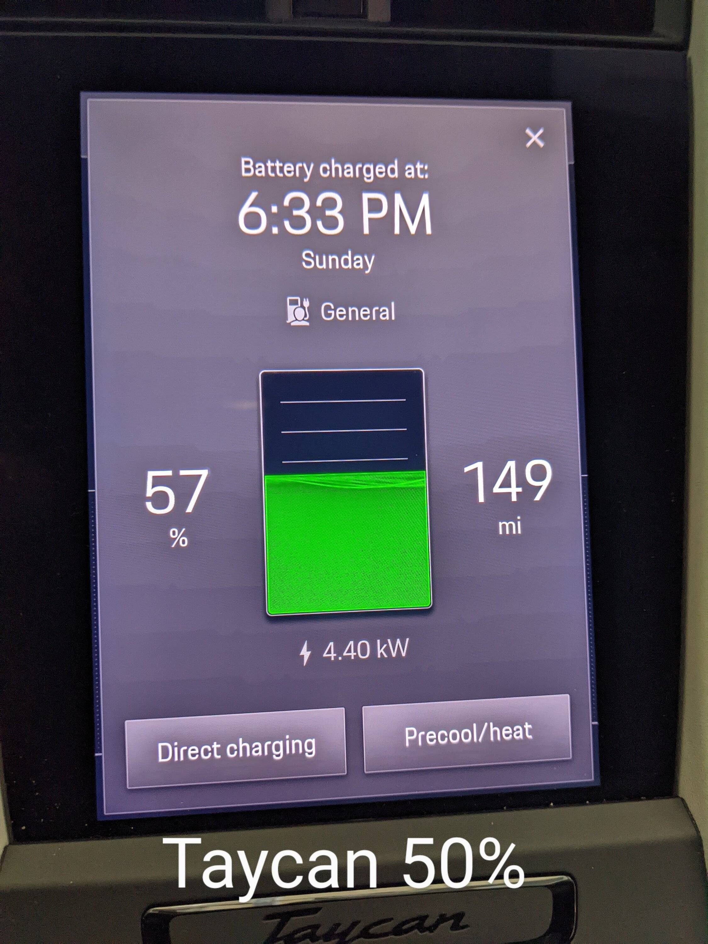

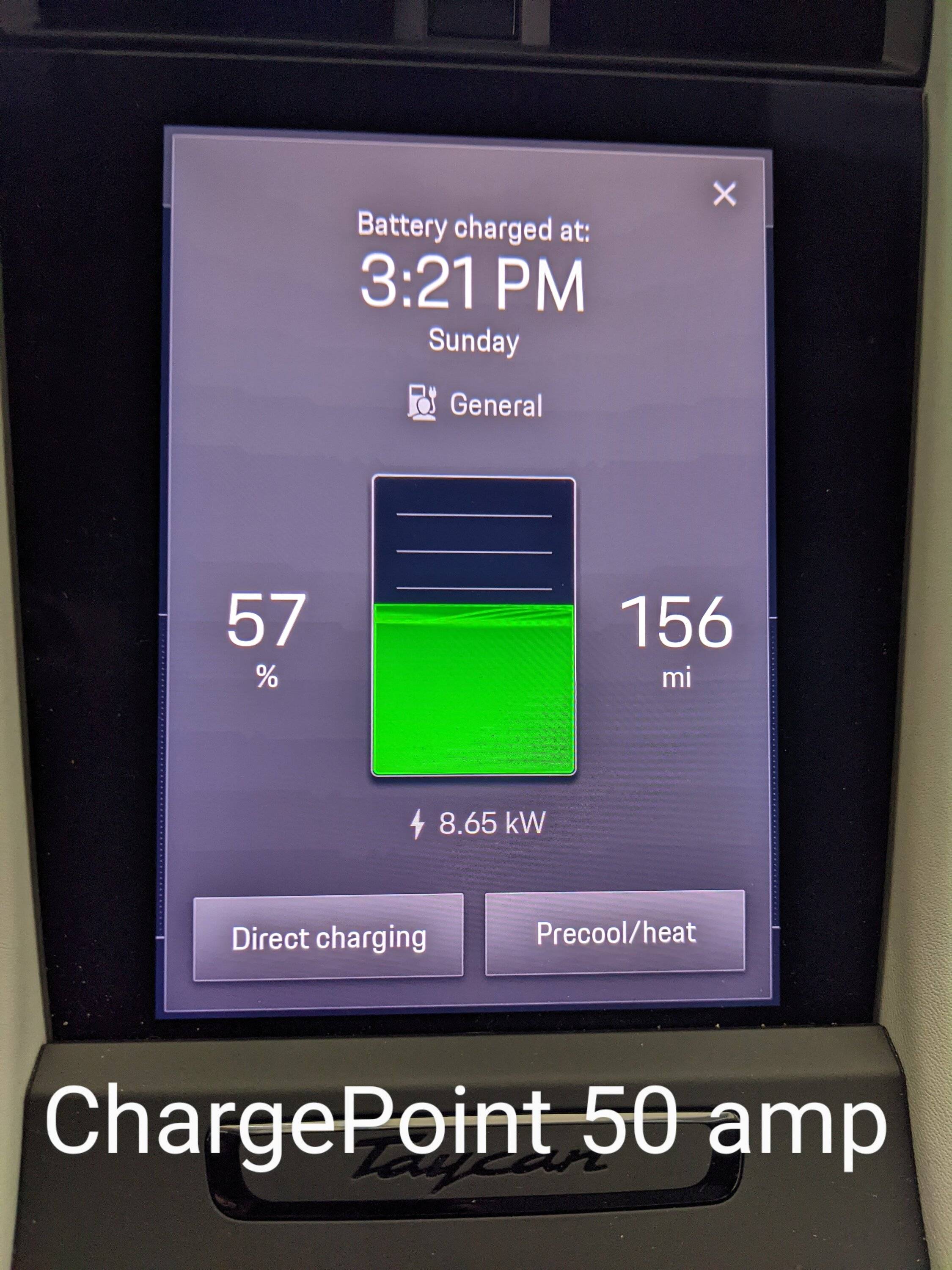

Another reason why the charger which came with the car is still in its original shrink wrap packaging while a ChargePoint EVSE charges the Taycan @50A without any issues.
Did some research and picked up a ChargePoint Home Flex 6-50. Make sure you go 6-50! This comes with the 6 gauge wire - LONG cord. It definitely handles the 50 amp charge. The ONLY way to use the default Taycan charger is if you step it down to the 50% setting. I took some pictures to show an example of the time difference between the Taycan charger and the ChargePoint.
In summary, the ChargePoint is 3 hours faster going from 57% to 85%.

The 50% setting worked perfectly. No errors in charging. So this definitely is the solution IF you want to use the Taycan charger. Just poorly designed.
After doing this and watching the posts, I researched the non-Porsche EV chargers and settled on the ChargePoint Home Flex 6-50. It comes with the 6 gauge wires and handles the 50 amp charge perfectly. Going from 57% to 85% was 3 hours faster than the Porsche charger set at 50%.

You can also change your breaker from 50 amps to 40 amps. The 40 amps will give you 32 amps continuous and you can set the Porsche charger at 100%. It should perform slightly better than the Porsche charger at 50%.
@mhockett This is not correct. You can’t swap a 50A breaker to a 40A breaker and run the PMC+ or PMCC at 100% on a 14-50 supply adapter - it will trip the breaker. Breakers do not regulate current in any way other than by breaking at their amperage rating.

AS NOTED IN OTHER POSTS - this is _BAD_ advice.
the PMC+/PMCC can not magically "detect" that you've swapped a breaker - there is no such mechanism - the PMC+/PMCC maximum amp charging rate is based on which supple cable is connected to the unit - _NOT_ based on some mythical ability to "know" what size breaker is on your circuit…
Porsche sells/provided 5 separate PMC+/PMCC supply cables for North America
  • NEMA 5-15 (included)
  • NEMA 14-50
  • NEMA 6-50
  • NEMA 14-30
  • NEMA 6-30
based on plug type from the supply cable the PMC+/PMCC sets it maxium charge rate in AMPs as follows:
  • NEMA 5-15 - 15 amp breaker - because building code for this type of plug - 12 amps
  • NEMA 14-50/6-50 - 50 amp breaker - because building code for this type of plug - 40 amps
  • NEMA 14-30/6-30 - 30 amp breaker - because building code for this type of plug - 24 amps
