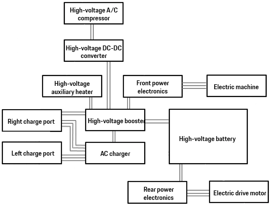

From what I learned so far, the AC charger does get involved in DC charging a bit, as it is responsible PLC communication between the DC charging station and the car. So perhaps the dealer is thinking since DC charging works, the AC charger (sometimes referred to as "High-voltage charger") is ok. Below is a Taycan high voltage block system diagram I found during my research.

For anybody interested, it was a bad onboard charger. My net suggestion is that if anything seems funky about charging, you need to do the legwork yourself and tell them what the problem is.
