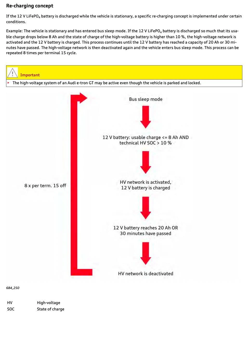

From here...
That is a bit of a strange diagram.
A SoC of a lipo battery is usually measured in voltage cuz voltage tells how much the individual cells are charged, typically 3,2-4,2V per cell when fully charged.
You can't measure Ah cuz it's a capacity, not a consumption or SoC.

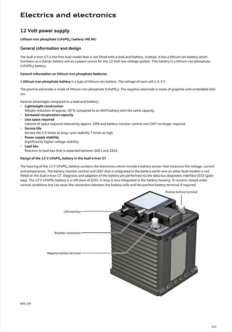

…maybe it’s how the protocol that runs over the Linbus from the LifePo battery BMS back to the rest of the car communicates its SOC? Dunno.

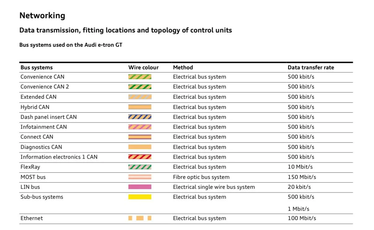

The car is at CAN-Bus idle (sleep mode) 15 minutes after switched off so no, it's not that active.
PS Taycan doesn't use LIN-Bus.
Do you want to make a bet? ?

Interesting - out of interest how does the system know when to start the 30 min charging of the 12 Volt ? which it is meant to do up to eight times if the Audi diagram is correct for the Taycan ?
This is what Audi say (should be identical for the Taycan)...
Re-charging concept
If the 12 V LiFePO4 battery is discharged while the vehicle is stationary, a specific re-charging concept is implemented under certain conditions.
Example: The vehicle is stationary and has entered bus sleep mode. If the 12 V LiFePO4 battery is discharged so much that its usable charge drops below 8 Ah and the state of charge of the high-voltage battery is higher than 10 %, the high-voltage network is activated and the 12 V battery is charged. This process continues until the 12 V battery has reached a capacity of 20 Ah or 30 minutes have passed. The high-voltage network is then deactivated again and the vehicle enters bus sleep mode. This process can be repeated 8 times per terminal 15 cycle.
