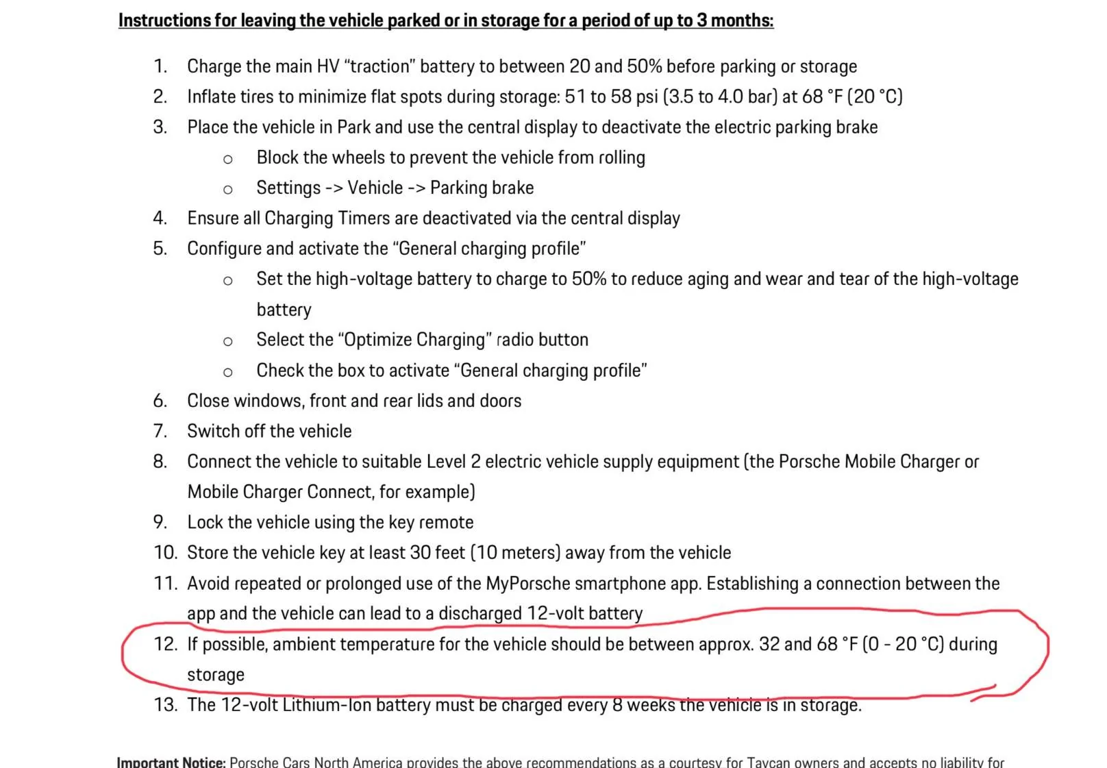

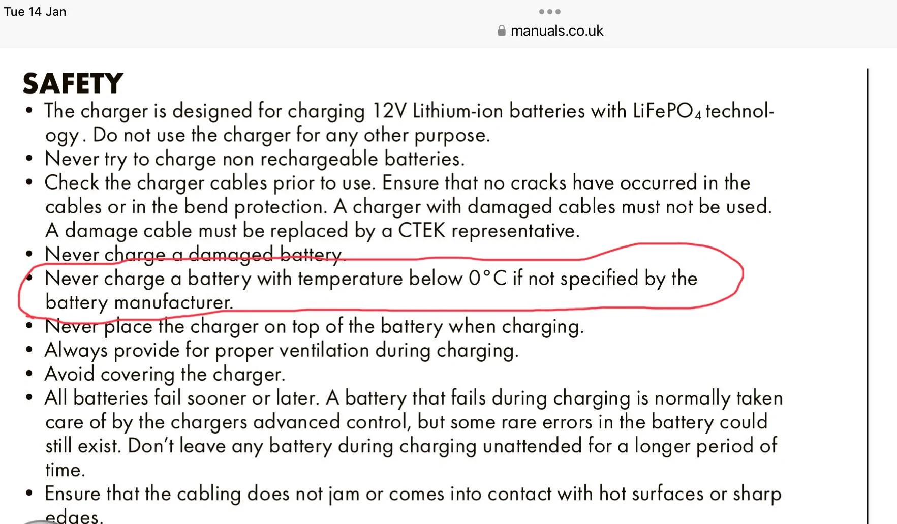

Interesting that the recent problems with 12 Volt battery seem to all have been during cold weather - not heard of same problem in warm weather. Obviously it is fairly rare but significantly heard of at least three during recent cold weather - I know this type of battery does not work well in cold weather so maybe the main battery does not charge for long enough on each of its eight charges - I notice that both Porsche and CTEC give rather vague warnings about charging below 0 degrees C (see attached) however plenty of Taycans are sold in colder countries than here !

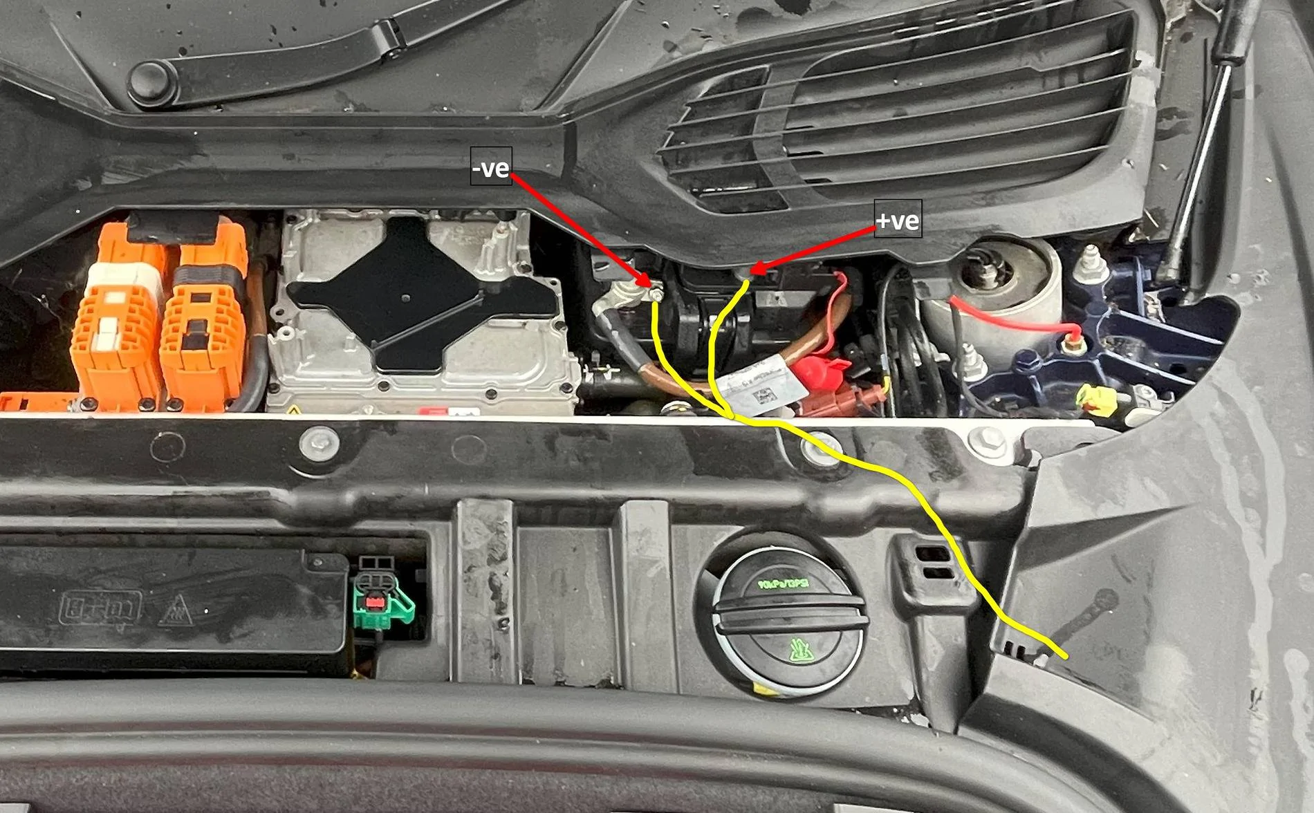

I had wondered how to route it too. I think this is the way to go for RHD cars. The terminal should exit under the plastic cover - I think there's enough room so it does not pinch it at this point. I'm going to fix it with double sided tape. It's then just a case of lifting the bonnet and plugging in the Ctek.
Porsche Taycan Electrical System Fault + 12V? Routing Ctek

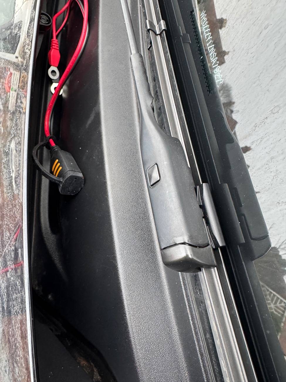

Porsche Taycan Electrical System Fault + 12V? IMG_2708

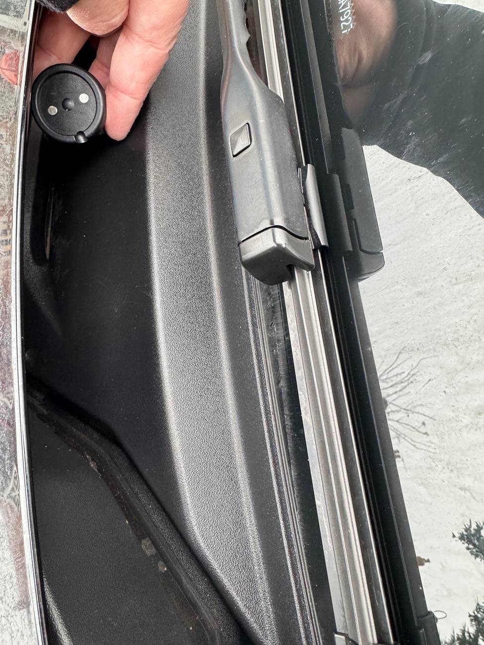

second option is a loose connector here, with cable drilled through and a grommet for protection. We just need to be sure it doesn’t fly up and foul the wipers.
Porsche Taycan Electrical System Fault + 12V? IMG_2709
Any suggestions welcomed of course.

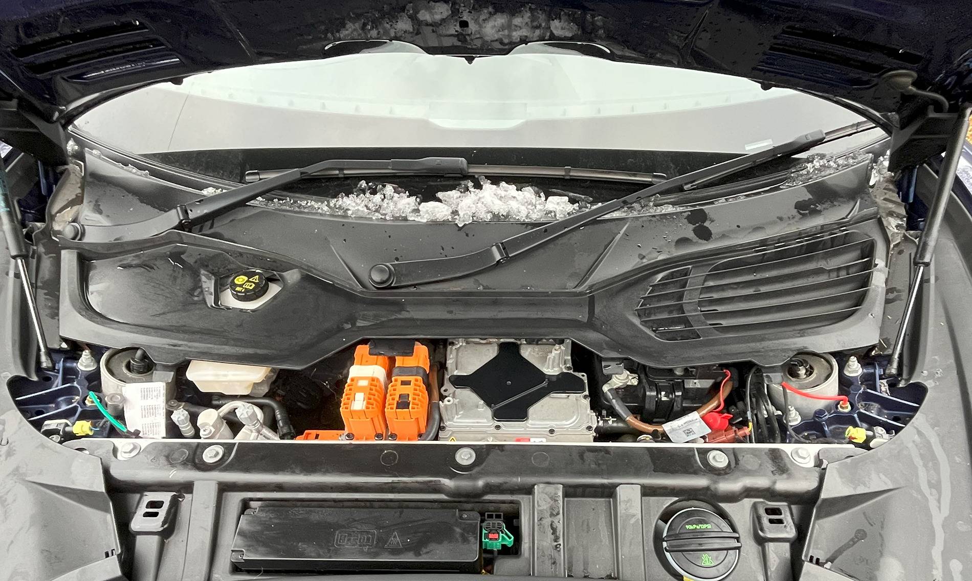

Looks like a reasonable location for a Magcode socket if it's waterproof. Your photo is taken at a different angle to mine (taken in the recent cold snap). I think I would rather keep it away from somewhere that could get wet and potentially interfere with the wipers. It may also be more difficult to get the wiring for the Magcode tucked away behind.
Porsche Taycan Electrical System Fault + 12V? Under bonnet RHD
