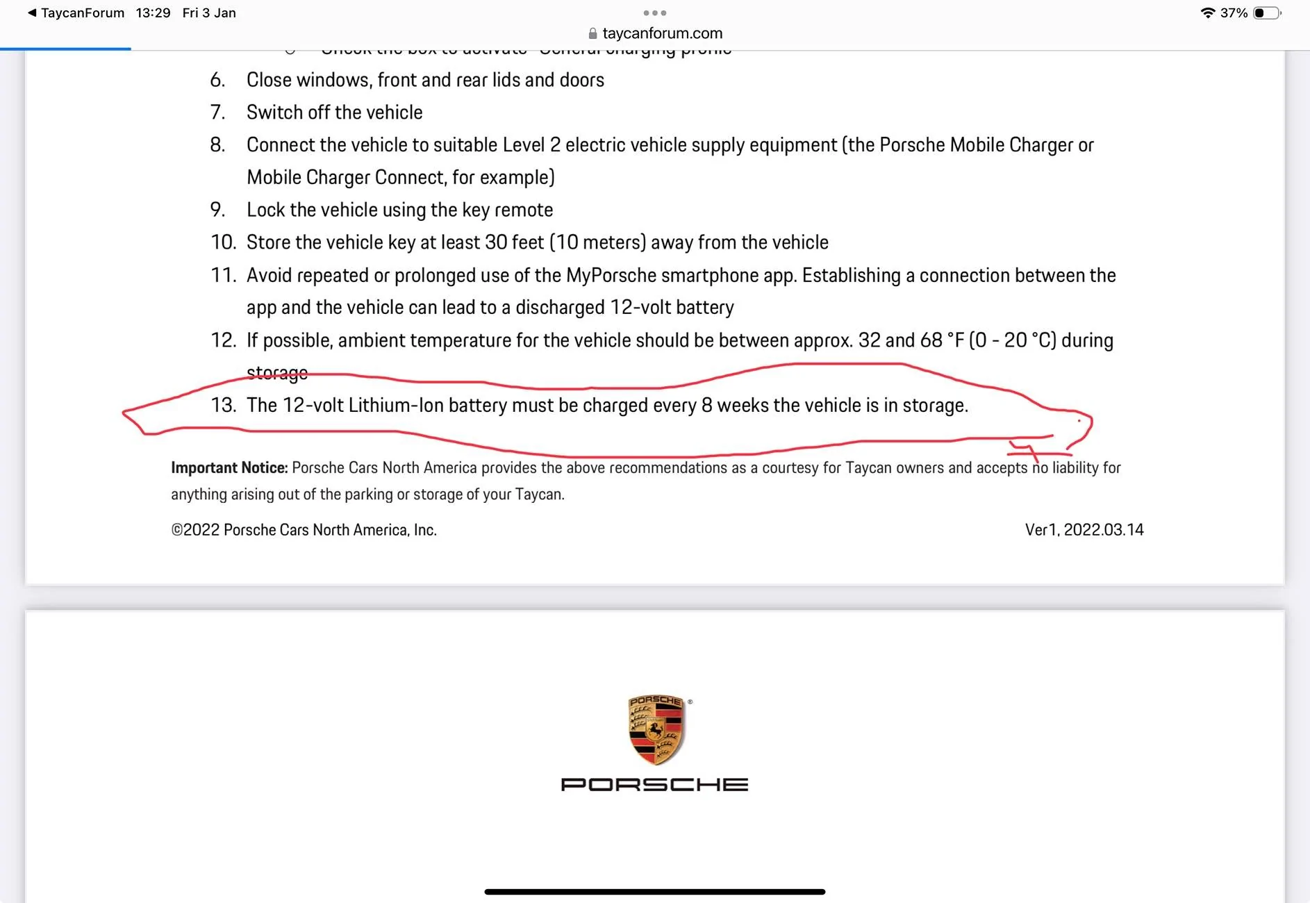

It is interesting that Porsche maintains that the car can be left for 8 weeks using the big battery charging the 12 Volt without outside charging but we find that occasionally a problem exists after just nine or ten days.

I've had this issue over xmas as well, it was left plugged in to wallbox but not charging as was on 39% and I was waiting for octopus greener days later in the week. I had driven about 3hrs/100 miles on the Saturday, but on Monday night I got a tracker alert, went out, 12v dead as a dodo. Ran through the rigmarole of getting it back up and running then charged the main battery for an hour hoping that would help. Left for another week and again, flat. This time I left the car door open and kept going to it every 20 mins or so to prompt/keep it turned on. I could see the 12v was charging between 13.6 and 14.6v on the display. I'm hoping this isn't a bigger issue as it looks like a 12v replacement is about £1k! Ordered a lifepo4 trickle charger, however, a week sat stationary shouldn't cause this even if it was -4 degrees should it? I've owned this car and treated it like this for a year so this is a new development.

Yes, several on this forum and elsewhere have had exactly this.
Looking at ICE Porsche forums it seems this is a "normal" issue with Porsches (and indeed Audi etc). Too bad the manufacturer hasn't addressed in design either by charging properly from the main battery, or by giving us an external socket for a trickle charger.

I think the trickle charger will sort it out ! Unlikely to be a faulty battery as they last a long time by all accounts but really don’t seem to like the cold weather which seems to find any problems in the software that is meant to keep them charged by the main battery for at least eight sessions.
