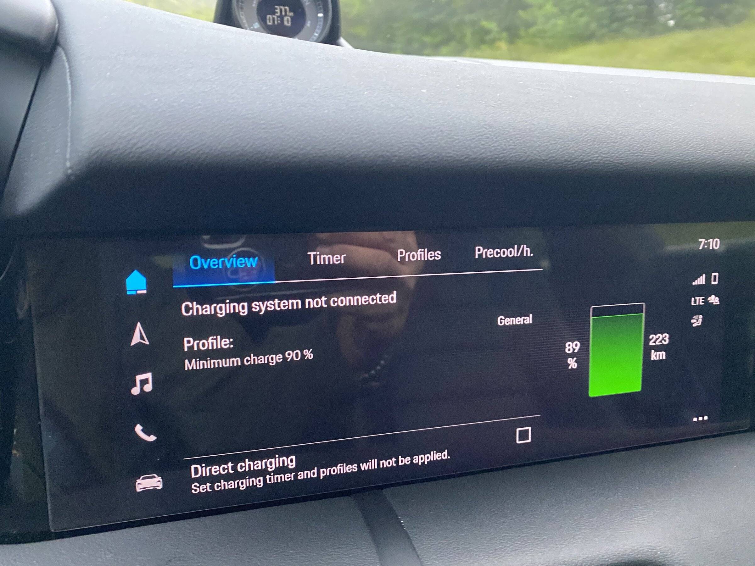

I have a Wallbox Juicebox and it works great. Recently set my profile to 90% and it gives me 236 miles this AM when I got in the car. About 1/3rd into work had pretty good range remaining after only about 8-10 miles.
Porsche Taycan Charging immediately to 85% IMG_8383

So I’ve been back from travelling and have managed to test a couple of times this weekend. I think I’ve figured it out but will continue to test. I’ve been effectively aiming for two things (1) charging during off peak hours, and (2) charging to a preset maximum soc of 85%.
Until now having both (1) and (2) has been challenging.
The installation engineer was back while I was away and not sure what he did. I’ve figured out that it works with following settings
(1) Wallbox set to off peak schedule
(2) Taycan timer set to end 5 minutes before the off peak schedule on the charger ends
(3) Taycan general profile turned OFF
when I come home before off peak time I immediately plug in. The car will attempt to charge and ultimately fail, with red error light in charge port and “charging not possible” message in car and Porsche app. Ignore the error. When the time is right the charger will start and the car will go green.
I need to play some more with this as when the car doesn’t need to charge continuously until the set departure time it will stop charging after about 30 minutes and the charger will report an error. Also ignore that error… all should work automatically and the car should have the target Soc in time set in the Porsche timer.

For some reason, my setting with general profile and not timer on min of 85% does not work and the car charges beyond 85% until I manually stop it
Can you post your settings? Are you using optimized charging or preferred times? It needs to be set to optimized if you want it to stop at the min.

I am not 100% on this stuff as I don’t have a car yet. But the “min” for the The general profile is the soc that the car must be below for the profile to take effect. Not the soc that the car will charge to. Right? May have to wait till morning for the regulars to comment.
The profile min is the value the car charges to immediately when plugged in.
That's incorrect.
Profiles are location based apart from the General profile and if enabled is always active.
General profile can be used in isolation without a Timer. Charging occurs within the parameters set and will charge up to and including the set target charge assuming the state of charge (SOC) is less.
It is doing what you are telling it. But it is confusing. Try this video.
I think you need a timer to control max charge.
You can charge to a set amount using just a profile if it’s set to optimized. Many people, myself included, change this way.
