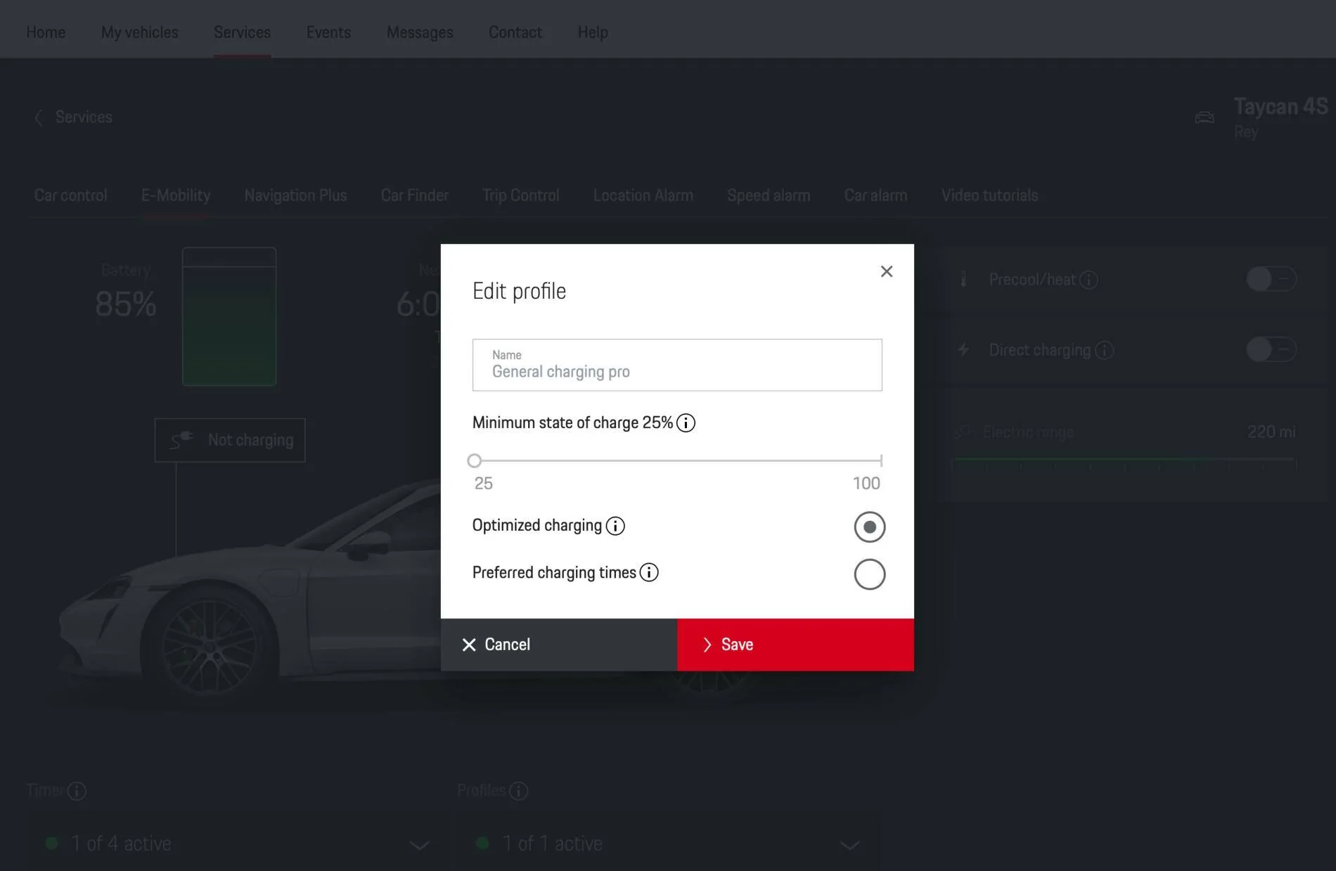

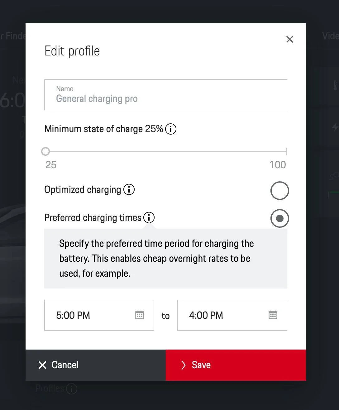

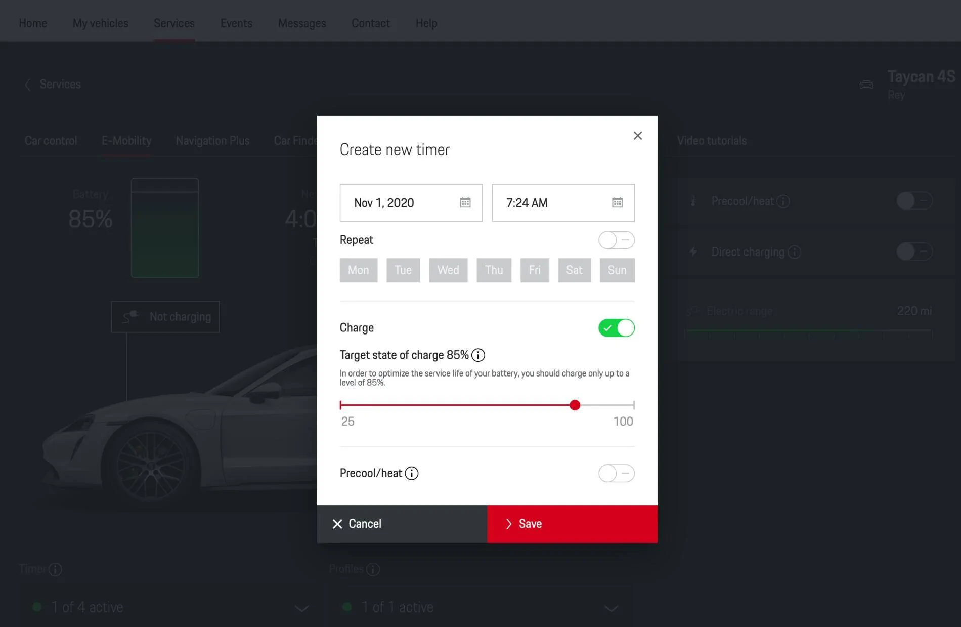

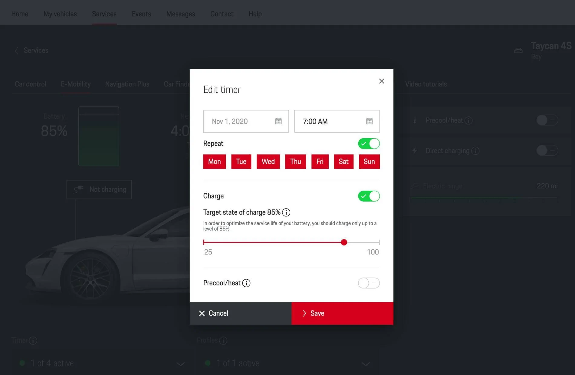

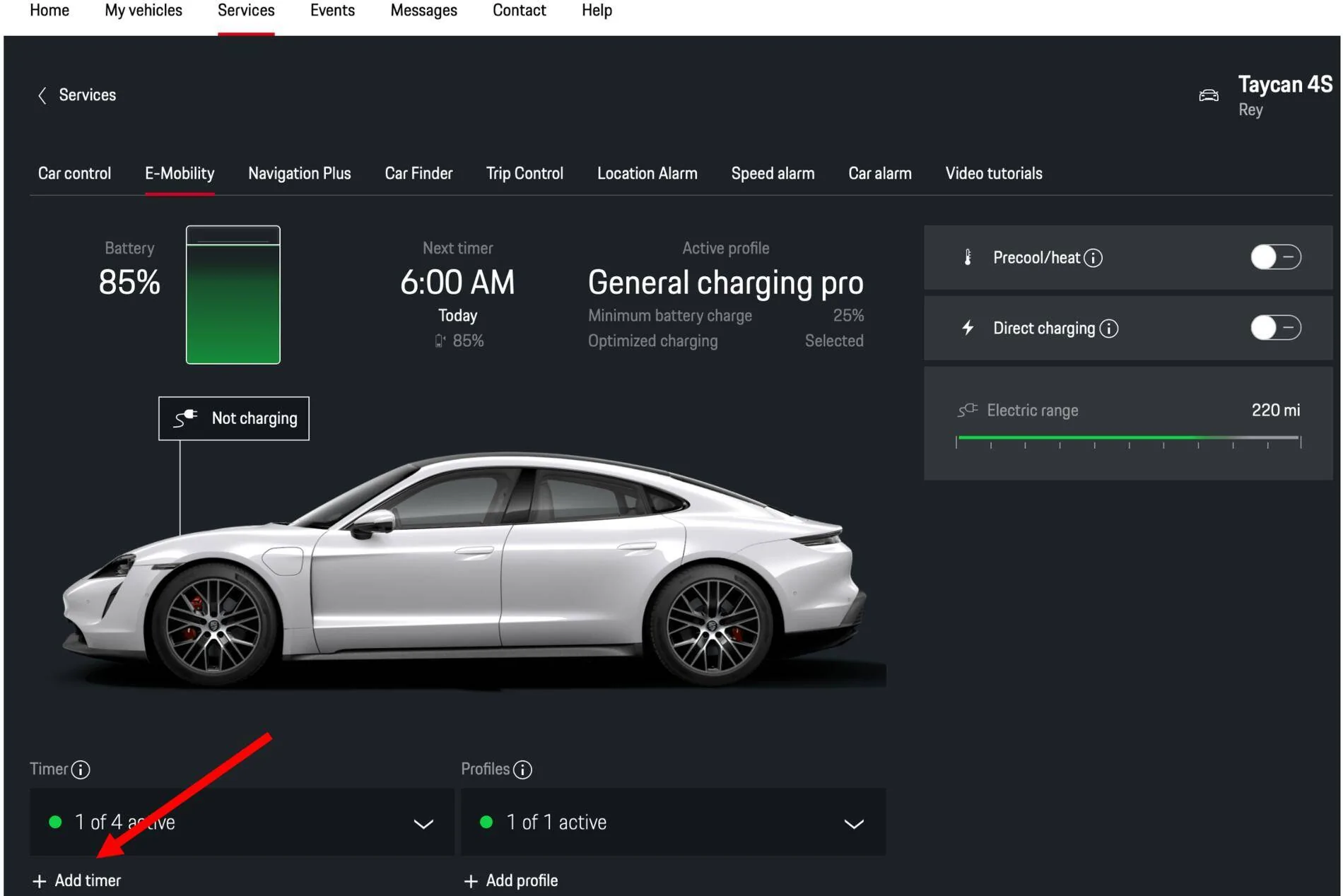

You need to use a timer. You can set that up from either a browser by logging into myporsche or from your app. Here are the screenshots from a browser but it's similar (and a little easier) from the app.
First create a timer by clicking the +Add Timer button in the bottom left. Then fill in the time, days and charge level you want. I just have one that recurs every day for 7am. You can also set whether to turn on the climate system to a target temp. I don't really know if you also need a Profile but I have it set up and included a screenshot of my settings below.
One other thing I've noticed is that you can have multiple timers active. So for instance you can have one set for weekdays for 7am and a different one set for weekends for 10am.

That's more advanced than I've ventured with the Porsche software lol. You might be able to do something close to that with the Profile where you set the preferred charging time, but I think the timer overrules the profile. So if your timer is set to be at 85% at 7am and your preferred charging time set in the profile is 5pm-5am, then maybe the car would schedule getting to 85% by 5am. But I think if the car can't reach 85% by 5am it will just keep charging until 7am as specified in the timer.
If you have a "hard" end time, that you want to follow I think you need to set the timer up accordingly or just physically end the charging session. As I type this I'm not even sure if the car is below the target charge level specified in the timer at the end of the time, whether it will stop or continue on to the target charge level. I think it may actually keep charging to get to the target charge level. Sorry, I'm still pretty new at this too and my general philosophy has been to keep it simple with the software since it is pretty immature.

For me, preferred charging times (profile) is set from 9pm - 6am. That's 9 hours of charging at about 25 miles range added per hour. That's more than I need. If you aren't able to get 40A out of the Porsche charger, I'd say fix that problem first. I'm not sure if the departure time in the active timer overrules the preferred charging time in the active profile. That would be good to know.
In my experience the departure time in the Timer always overrides the preferred charging time in the active profile.
