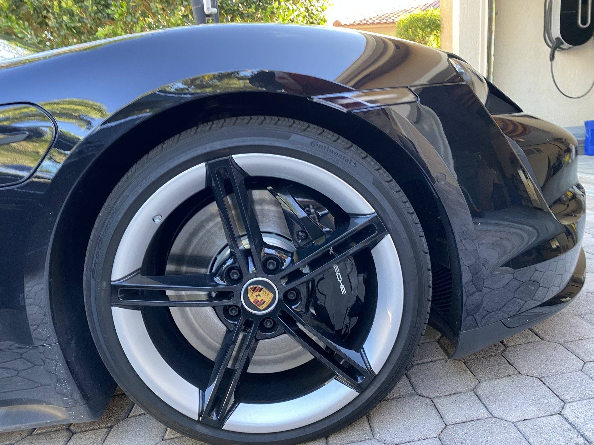

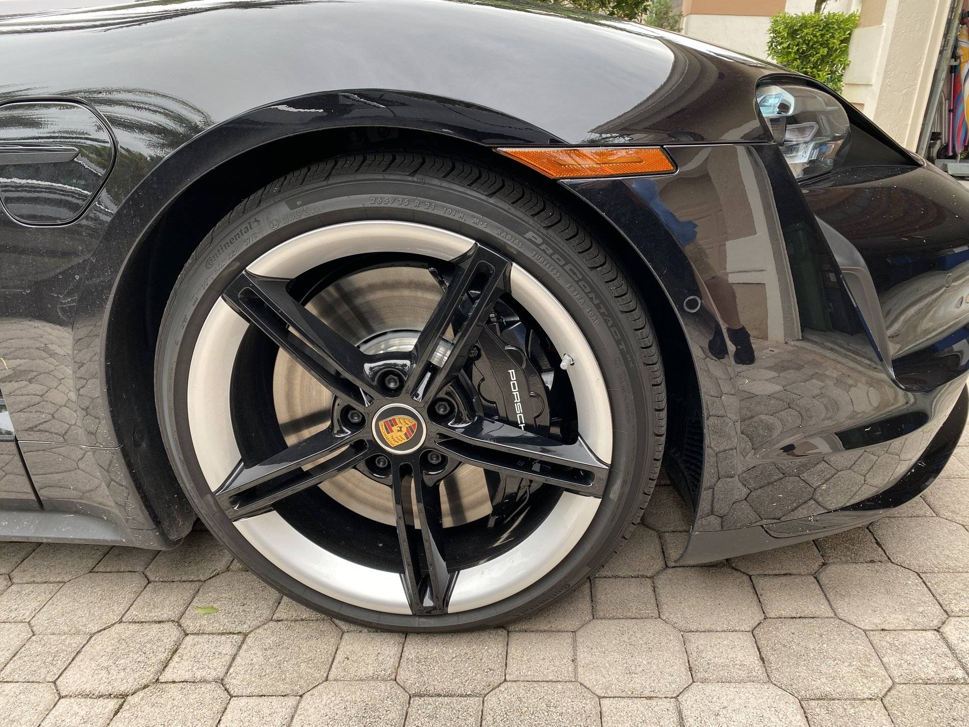

You're instructions were essential to my install, @NaiM5 . Thank you.
I, too, had to pop off the spacers from my original markers and glue them onto the new ones.

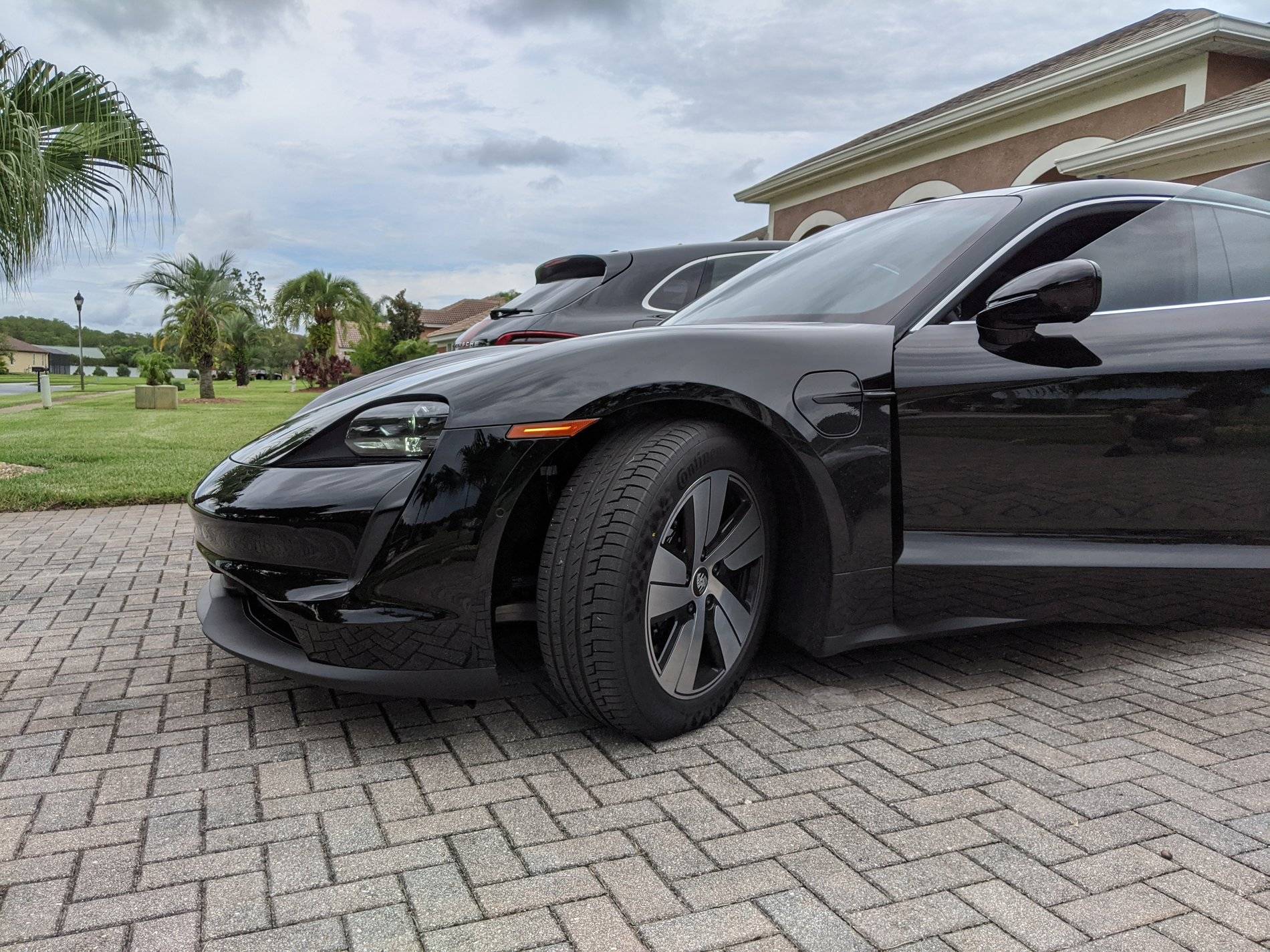

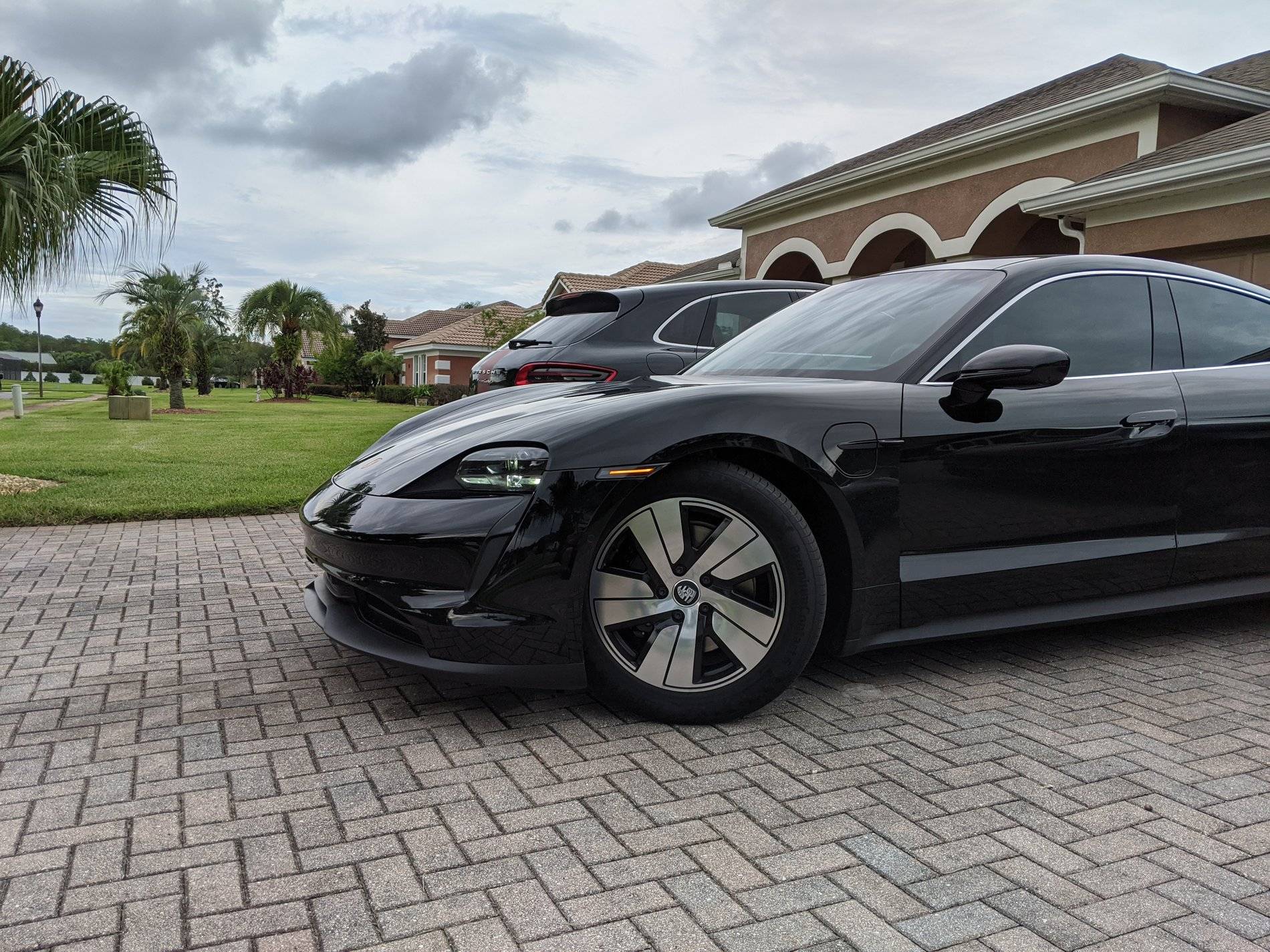

Got mine finally done today too. The spacers were definitely the hardest part for me as mine were glued to the OEM markers and I had to pry them off while trying not to break them. Used an exacto knife to pry them off and Gorilla Glue to reapply to the new clear markers. Definitely huge difference on my black Taycan with Mission E wheels.
Sorry Vim, didn't see your post before I did mine but @NaiM5's instructions in this thread were right on. Just know that the spacers, at least on mine, did have to be pried off and glued back - they didn't just pop on and off. FYI, the spacing is so tight that I don't think a YouTube video would even be helpful for this install.
BEFORE:
AFTER:
