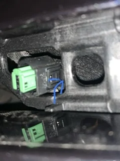

2. To unclip the wire, slide the lens out enough so you can get in from the front of the lens. The release is on the front facing not rear facing side of the lens. I took a photo of the clip. Just push on it and it will come right off
Porsche Taycan Clear Side Markers 3CFF2104-B876-4BBB-8EAB-DA2C4F37B350

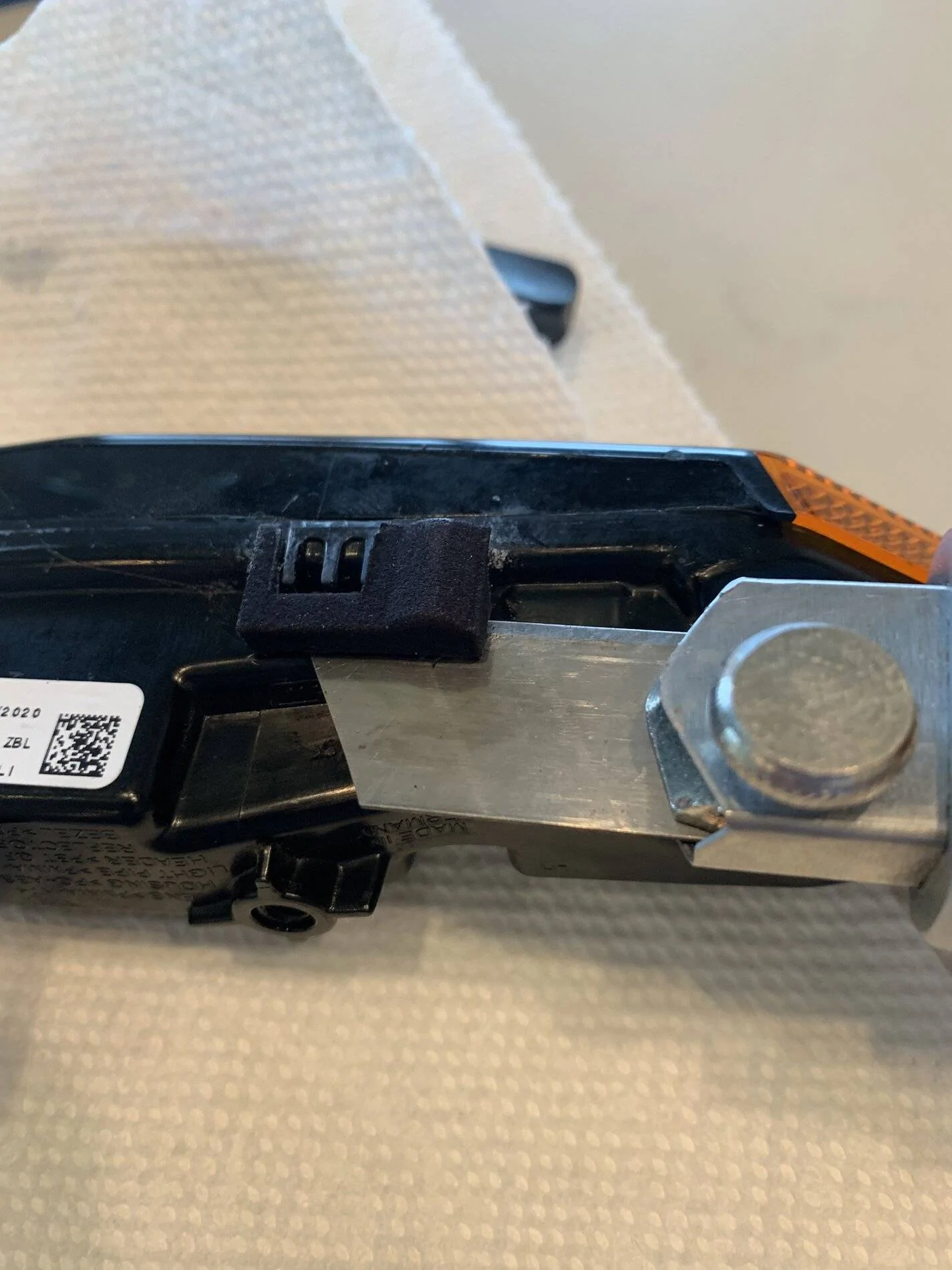

3. Getting the spacers off was easy once I just used a box knife to cut the glue line and pry up (see photo). There are 4 total spacers
Porsche Taycan Clear Side Markers C38BCD24-EBF8-434E-8087-C85A618AF410

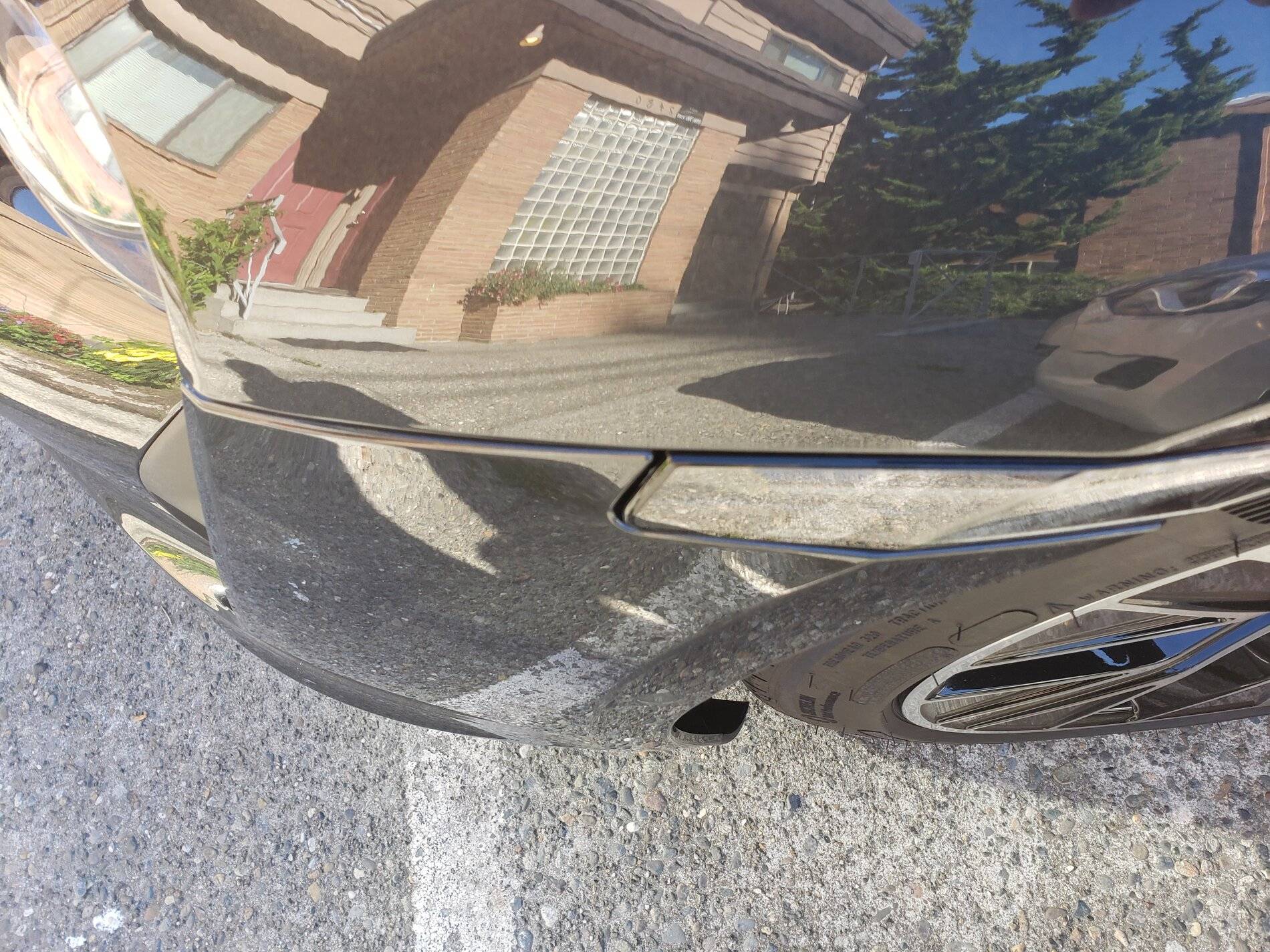

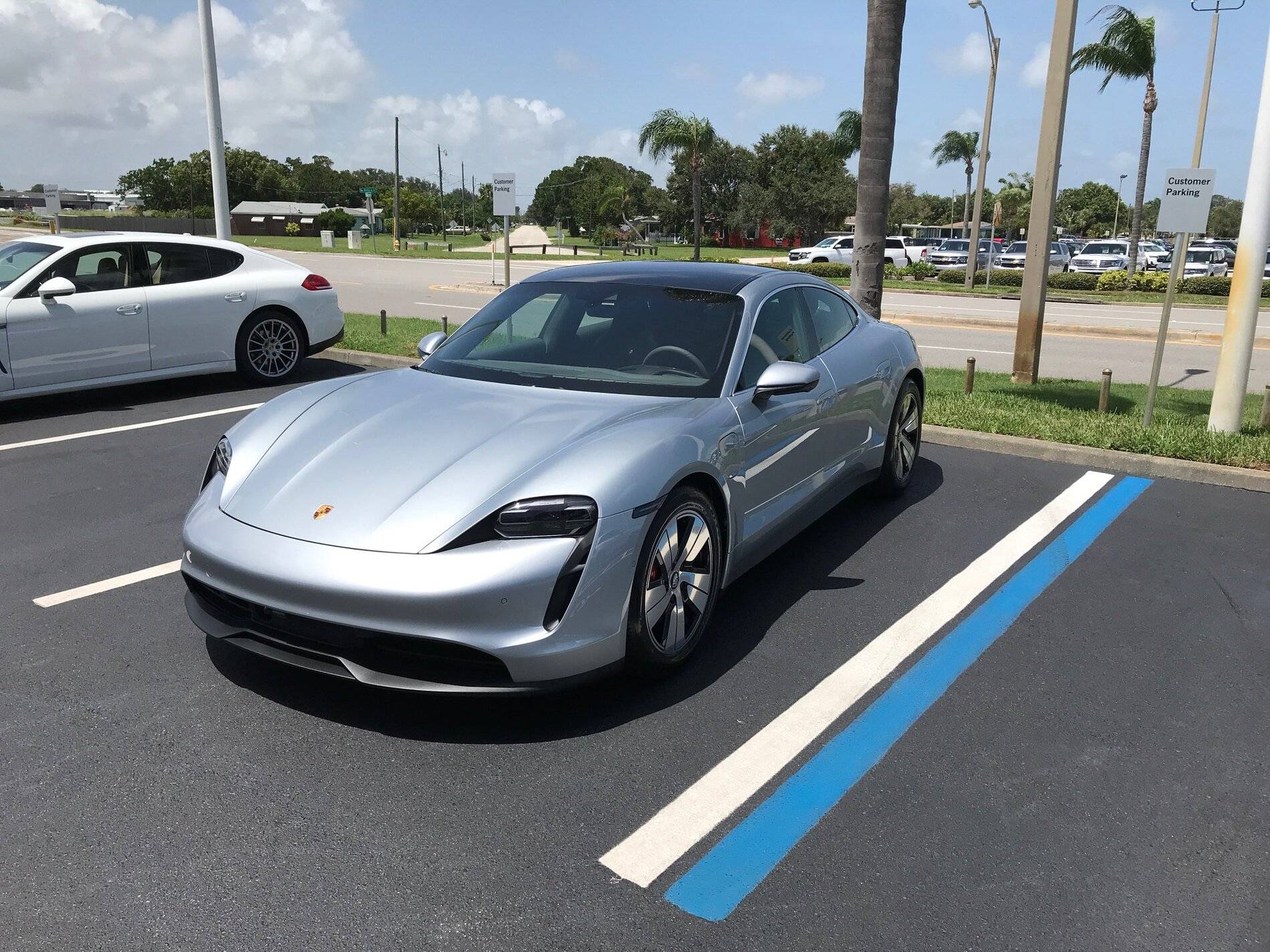

I had the dealer provide and install the clear side markers. The driver's side light is not as flush as the passenger's side. I am tempted to take it apart. I also got the turn signal error warning once as I trying to get the car registered to me but no more the rest of the day

If you can send a closer photo of the marker not being flush I'll compare it to mine and get back to you.
Or here are photos of how flush mine is for you to compare. I remember thinking it wasn't completely flush at first but looking again it's pretty close.
