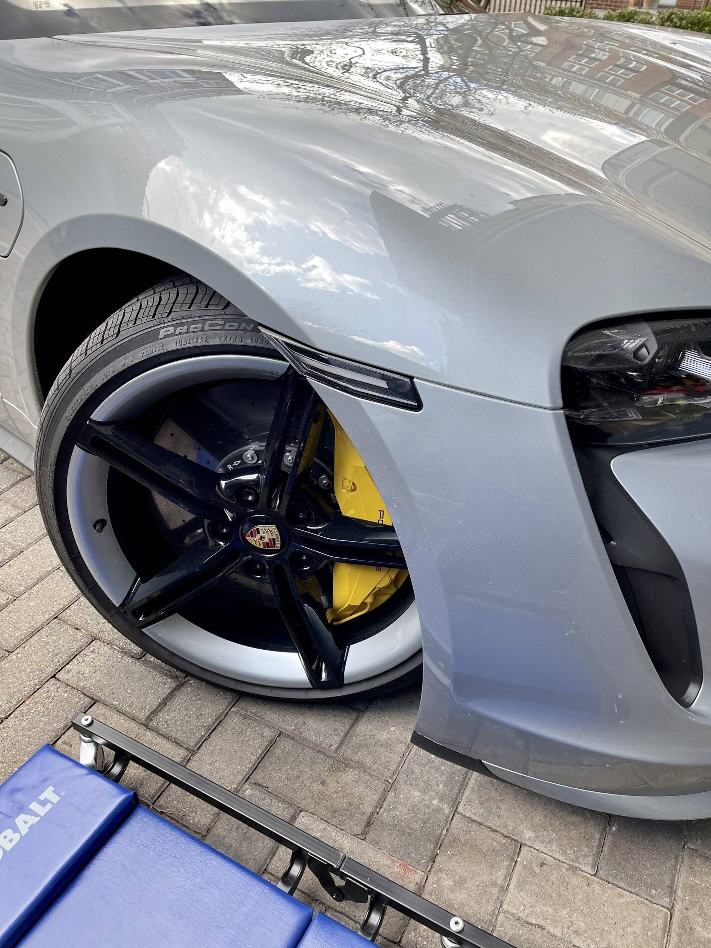

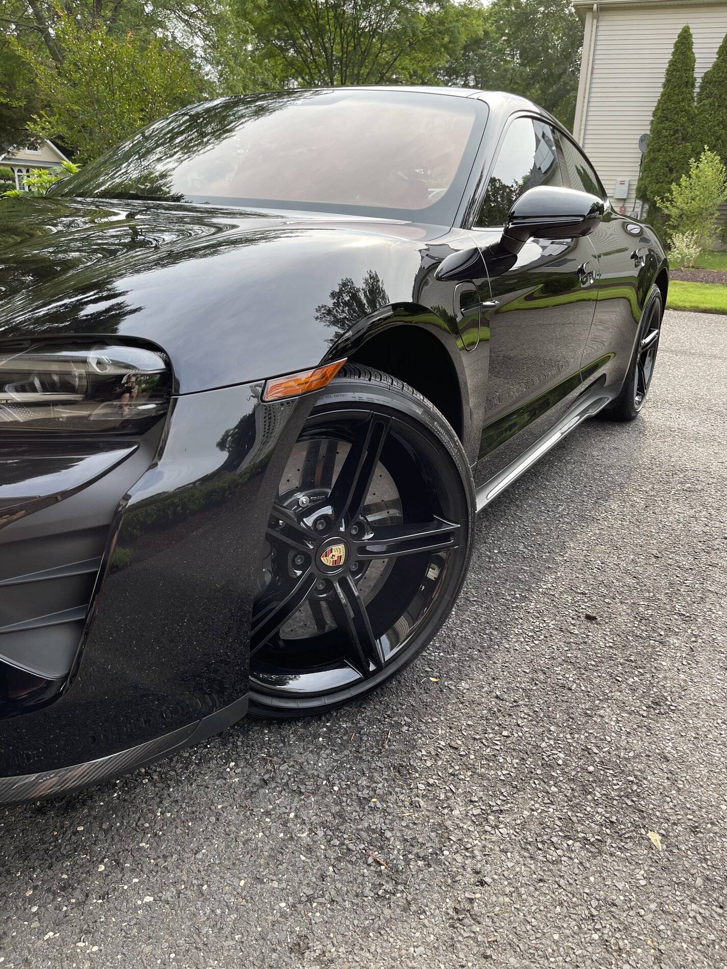

Just wanted to post an update on this. I have a 2021 Taycan base, bought the side markers from Suncoast, came in about a week. I didn’t have a spacer on the old lights, so it was fairly simple once I got them disconnected. They must have changed the design for the 21 model year. Tightening the screws on the back of the new markers was a gigantic pain. Looks a million times better though…
The trick is to prethread the screw on the new markers and then remove them before reinstalling.

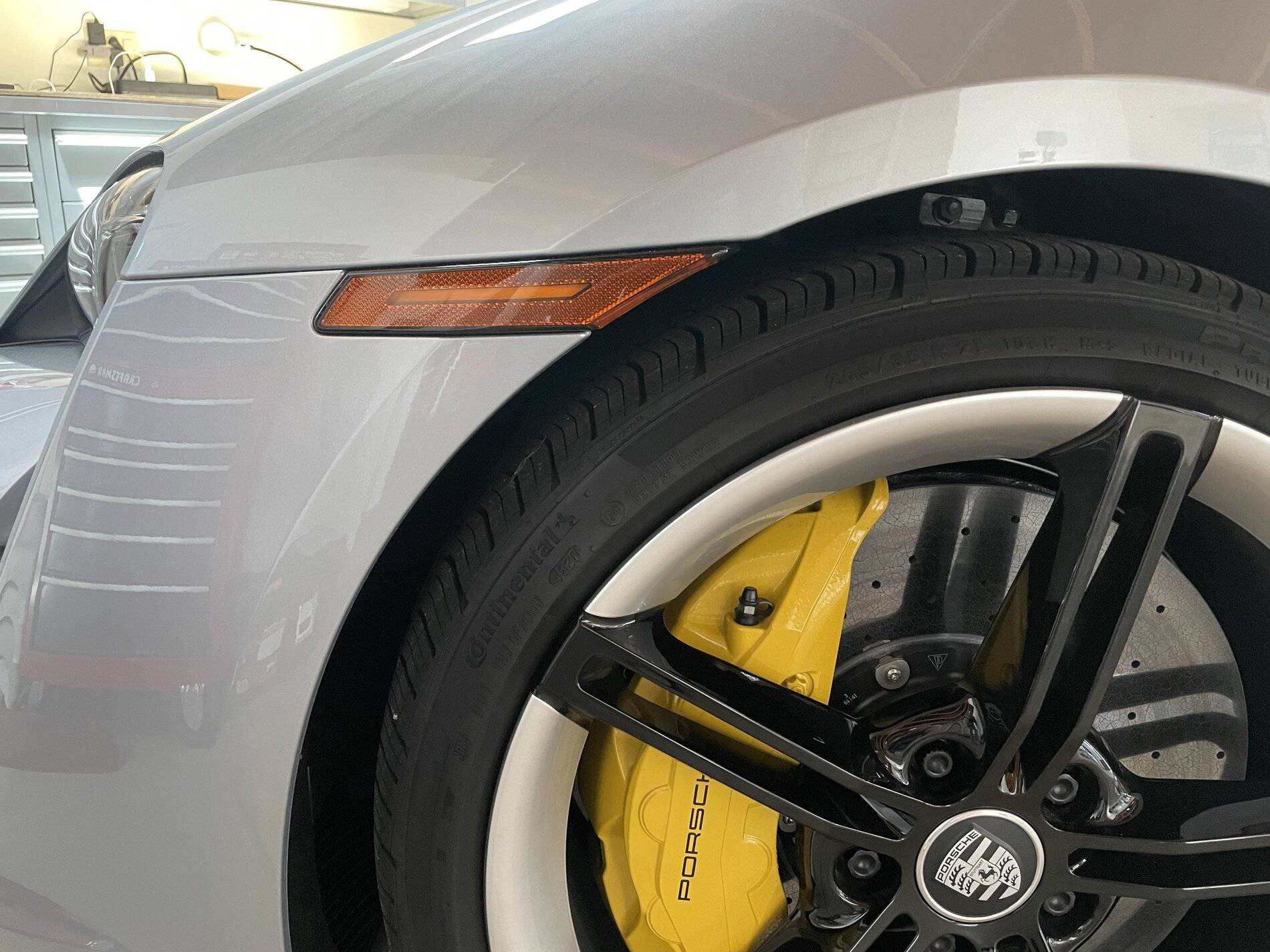

Easy-peasy. No spacers on the old lights and didn't even have to loosen the fender liner. As already mentioned but worth repeating: Pre-threading the screw hole in the new lights is a must for a stress free installation.

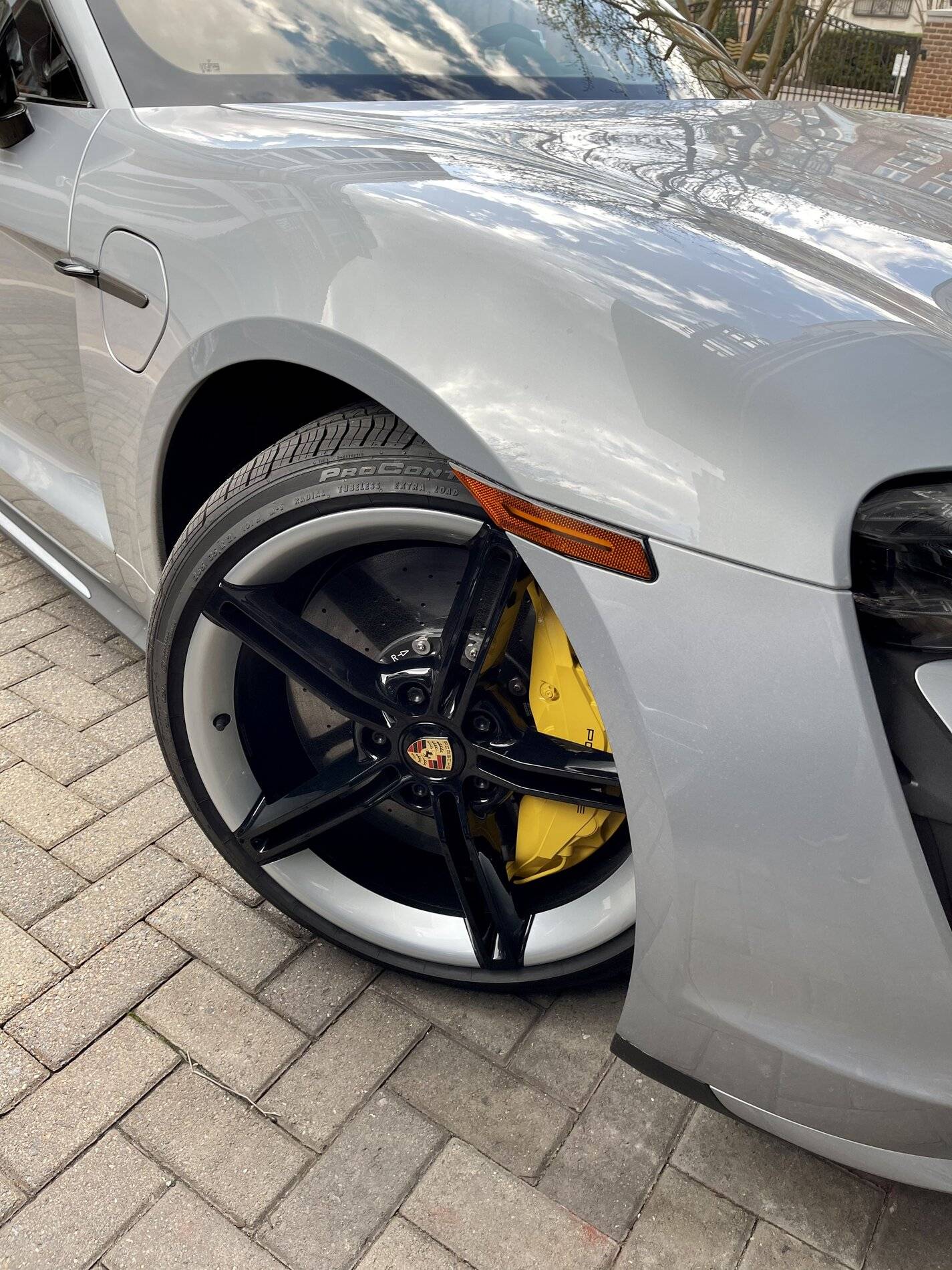

I don't have anything to add to this thread that hasn't already been said, but I did want to pop this up to the most recent posts because everyone should know how simple it is to do and how great it looks. Also gives me an excuse to post a picture ?
Porsche Taycan Clear Side Markers 412B8A18-3505-4CA2-809D-C8E8A62FB023

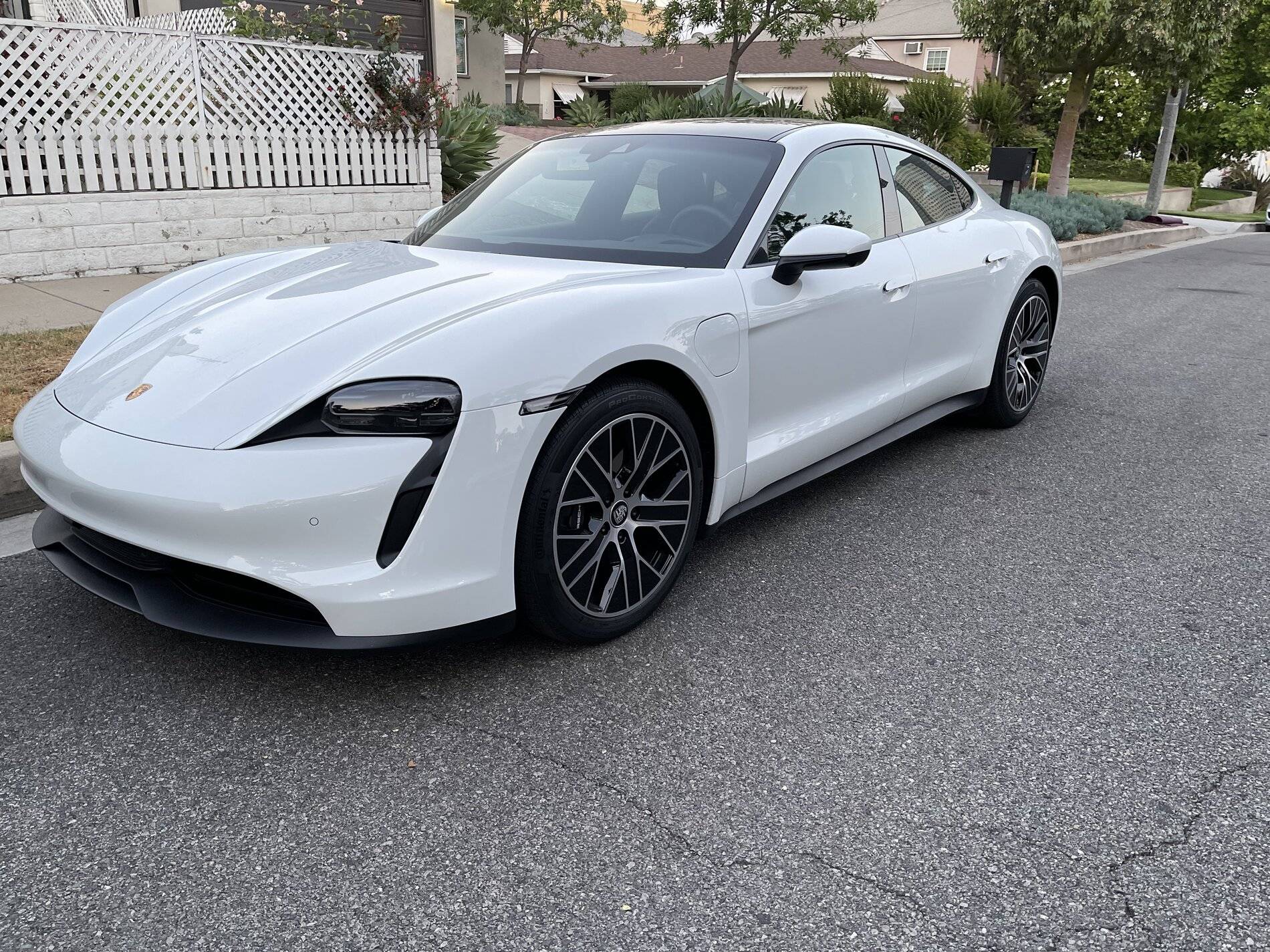

I was at my dealership and noticed the Taycan's they had on the lot had the clear markers. I pointed it out to my sales guy and he was like... yea we change them on every car, the amber looks terrible.

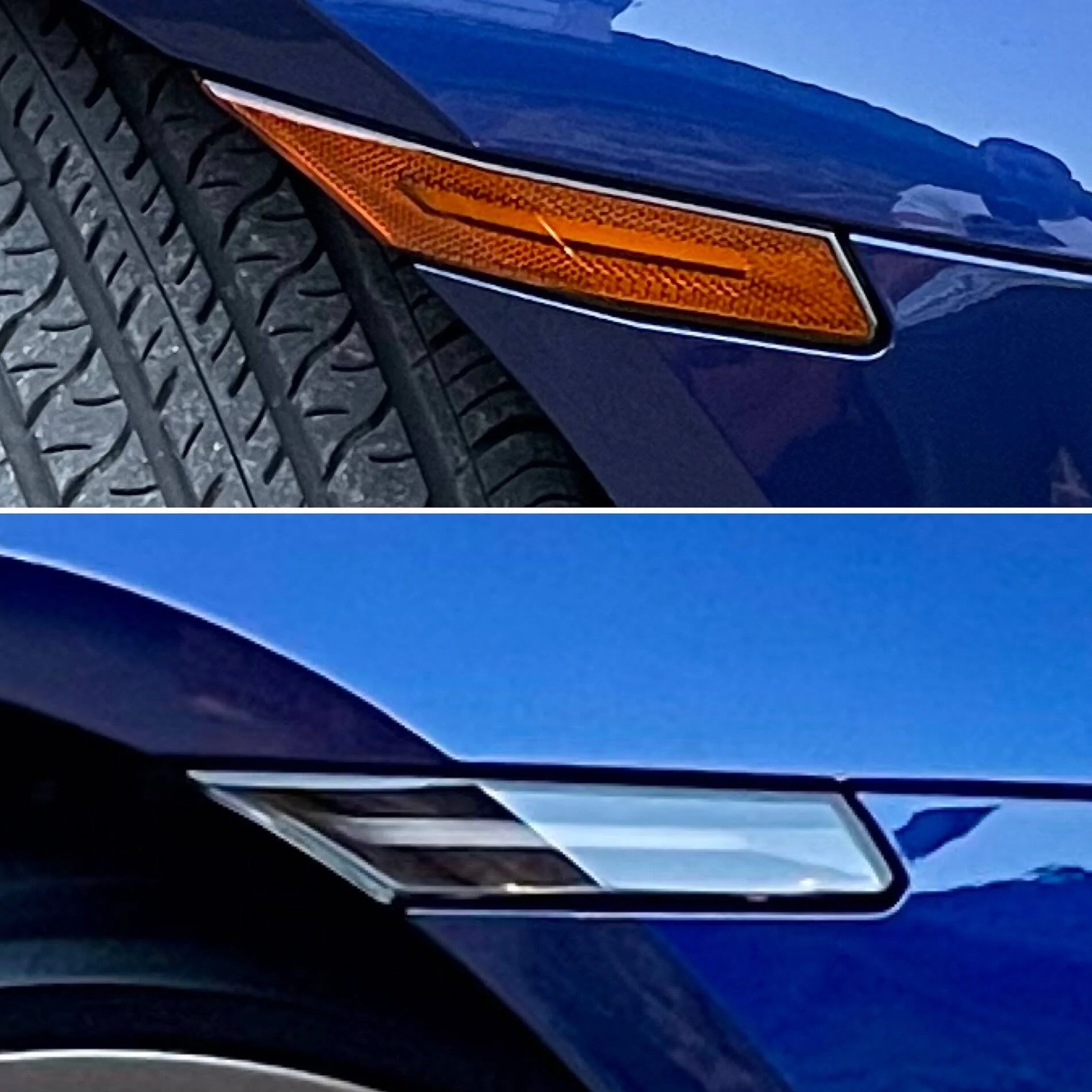

I had the dealer do the install on the clear markers. One question, on the upper trailing edge of each marker they stick out past the fender 1/8" to 3/16". I would have expected flush and have not been able to compare to original installed markers. What are other's experience?

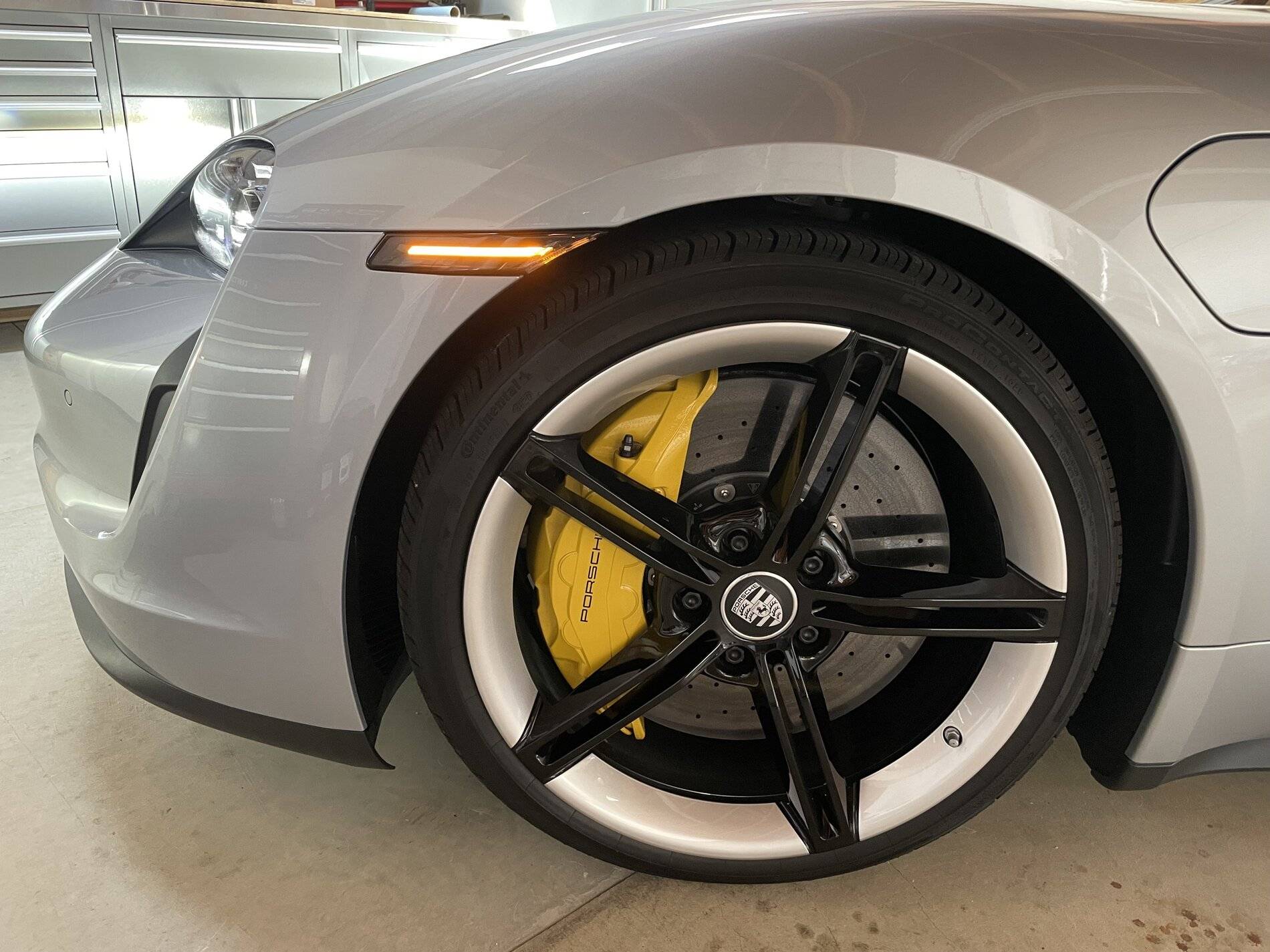

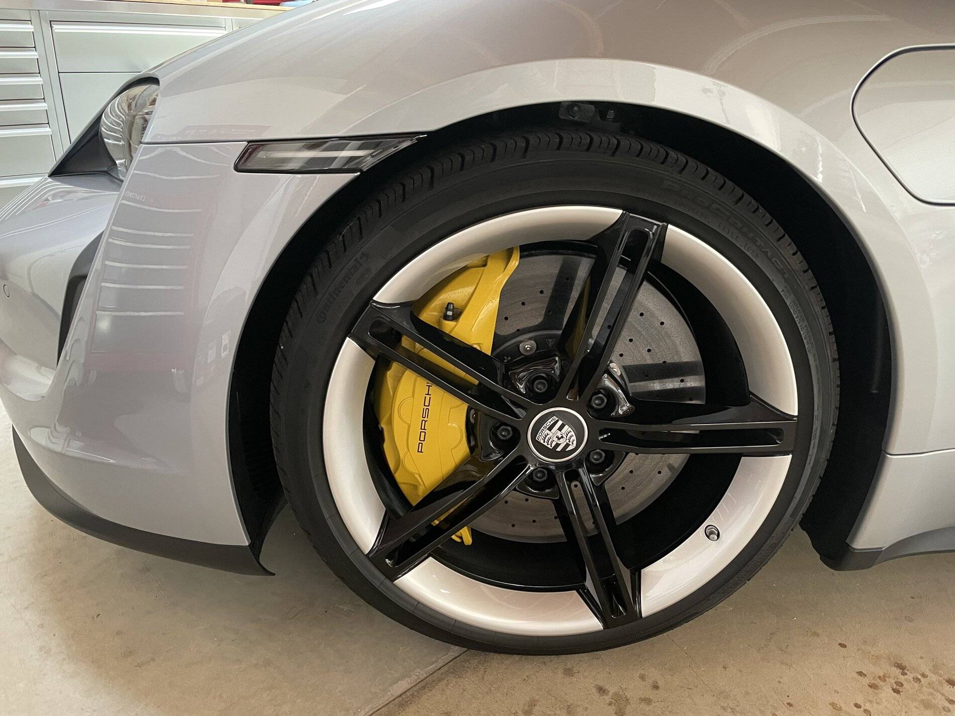

Here's a comparison of originals to clear. Both appear to be flush on my install. There is a tab on the "front" edge that has to angled in to make them flush.
Porsche Taycan Clear Side Markers 1653AD48-5856-4C32-B4D2-BD6874B1EEE2
