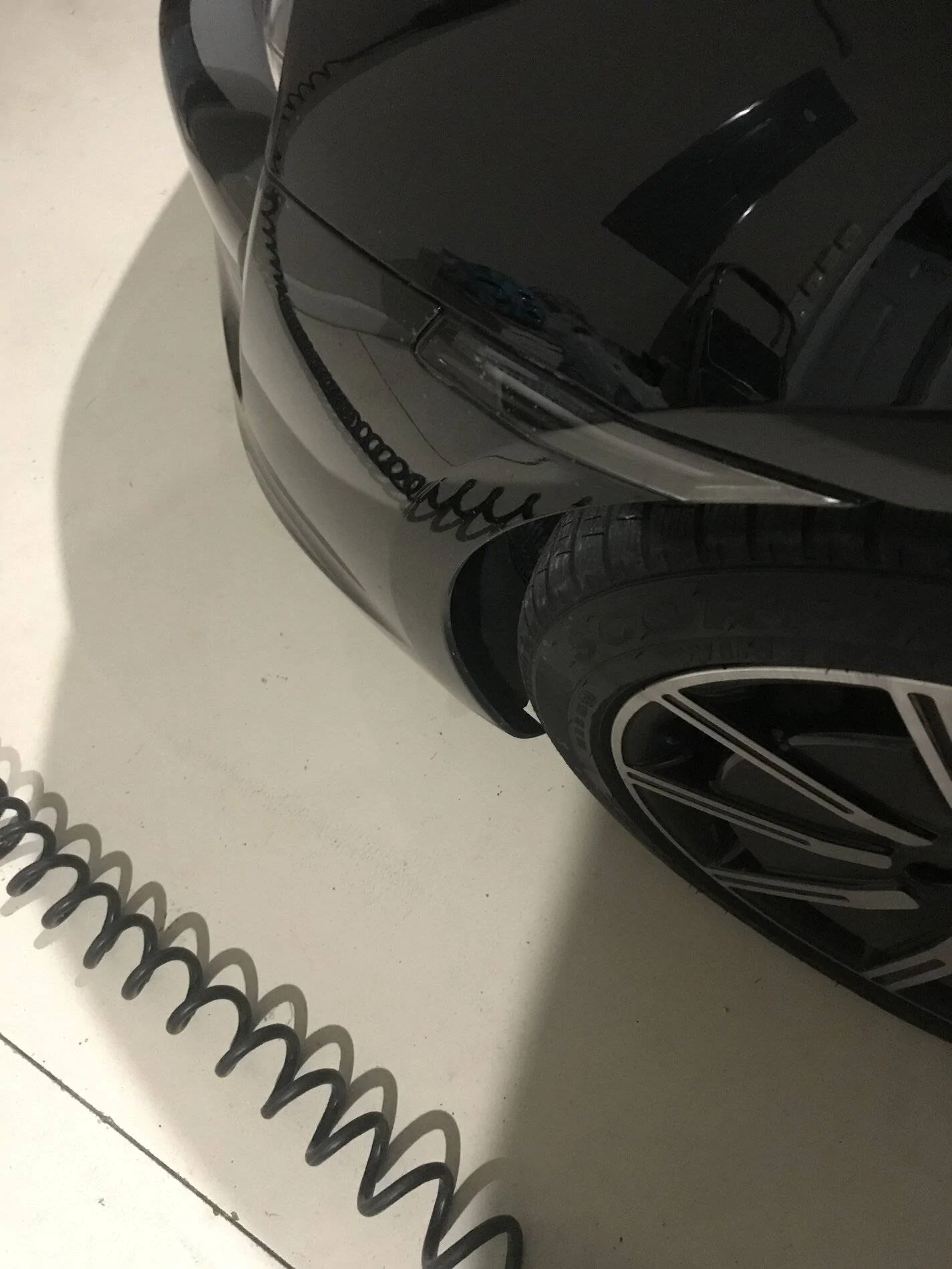

Porsche Taycan Clear Side Markers IMG_9571
I just completed my clear side marker project as well and noticed that they are not perfectly flush. Problem is I did not pay much attention to how the orange lenses looked before removing them so I have nothing to compare them to. Maybe the orange lights were not perfectly flush either. Anybody know if this is about how they should look or do I need to see my friendly Porsche dealer and pay them to fix whatever I did wrong.

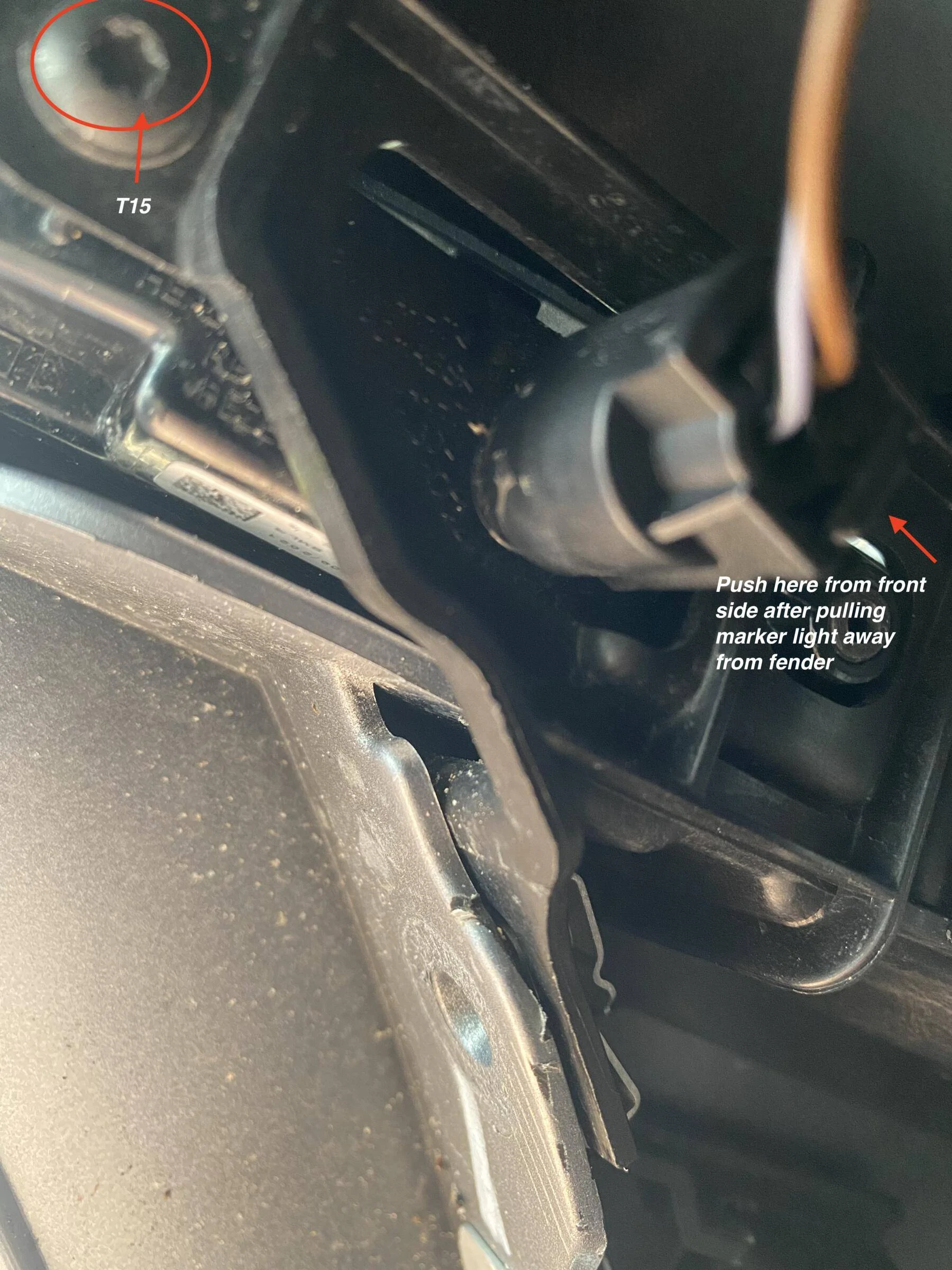

I just DIY this on my MY2022. Mine was mid-November build date. There is a very important change to these instructions, at least on my car. The screws that hold the fender liner in are T20 but the screw that holds the side marker light into the car is actually T15 on the MY2022. Took me a little while to figure this out.
On the second side, I didn't even loosen the fender liner. Just remove the T15 screw holding in the side marker light and pull it away from the car as far as the wire on the plug will allow. Then, from the front side of the car, take a small screwdriver and push on the upper part of the tab on the wire clip and apply pressure to pull off the connector while very gently pulling on the side marker light and it will slide right off.

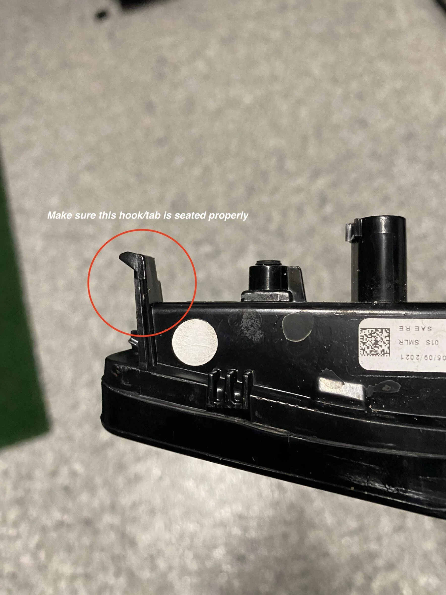

As for the issues with it not sitting flush, there is a little plastic tab on the front of the side marker light and there is a slot in the fender where it slides in. If you don't get that tab seated in the hole in the fender then the light will not sit perfectly flush.
Also wanted to mention that there wasn't any spacer involved on the 2022. Hope this helps someone.
Porsche Taycan Clear Side Markers IMG_7669
Porsche Taycan Clear Side Markers IMG_7675
Porsche Taycan Clear Side Markers IMG_7673
