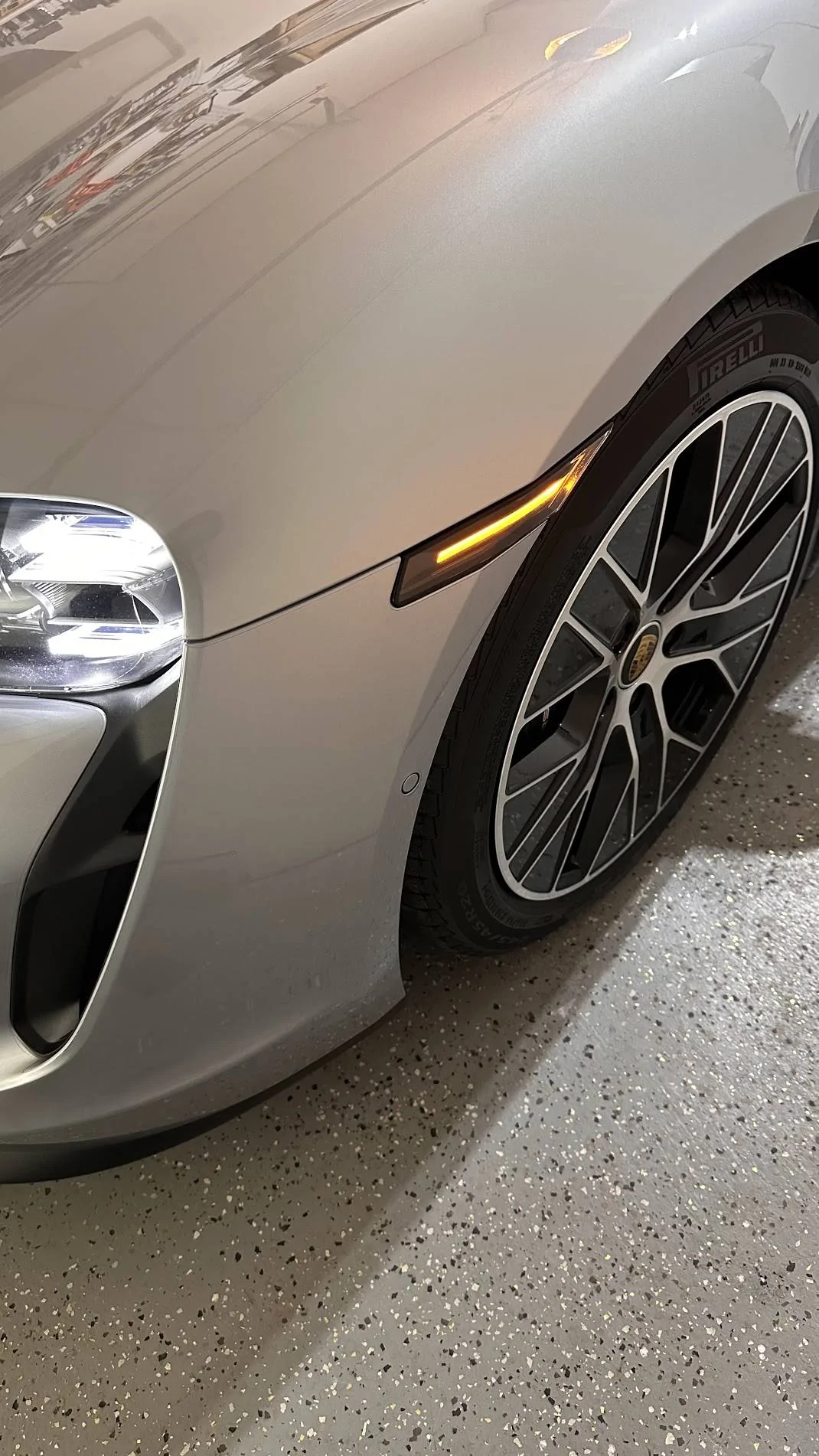

DIY: Replace Amber US DOT Side Marker with Clear LED Euro Side Marker.
Required Parts:
1) OEM Porsche Part: 9J1-953-042-D
2) OEM Porsche Part: 9J1-953-041-D
Required Tools:
1) Torx T20
Procedure: 5-10 minutes
Step 1:
1) Turn Wheel for more space.
2) Remove (1x) One Inner Fender screw for access.
Step 2:
1) Remove Screw holding Side Marker with Torx T20 driver.
Step 3:
1) Disconnect power cable by pinching connector with your hand.
Step 4:
1) Using screw, thread new side marker with T20 driver.
Step 6:
1) Check all rubber bushings are attached and fixed on side marker; the bushings clip onto the side marker.
Step 7:
1) Re-Install in reverse order.
*Test connections before tightening screws.
DONE!
*Enjoy!

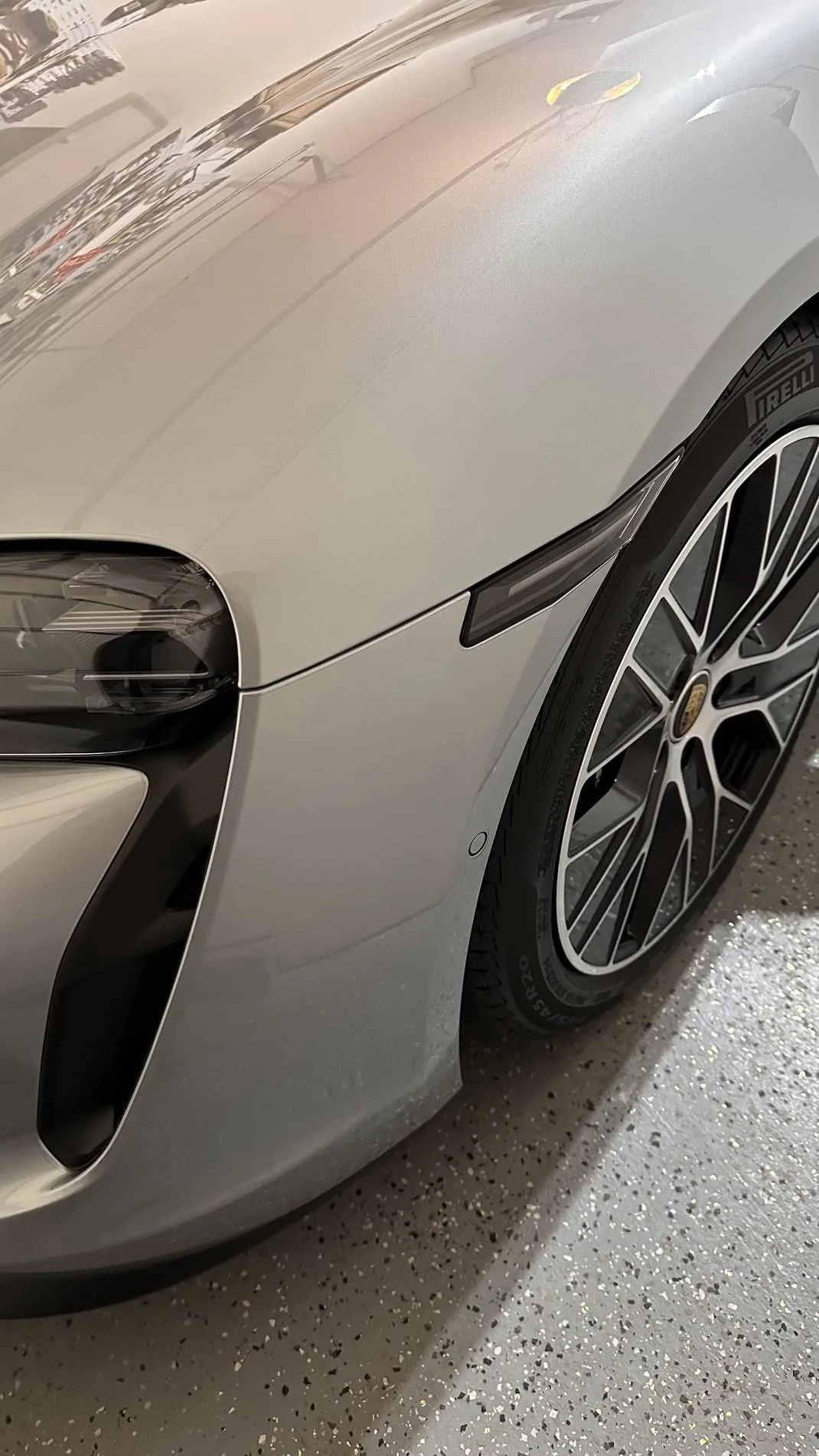

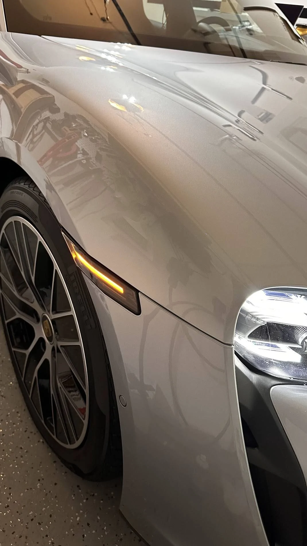

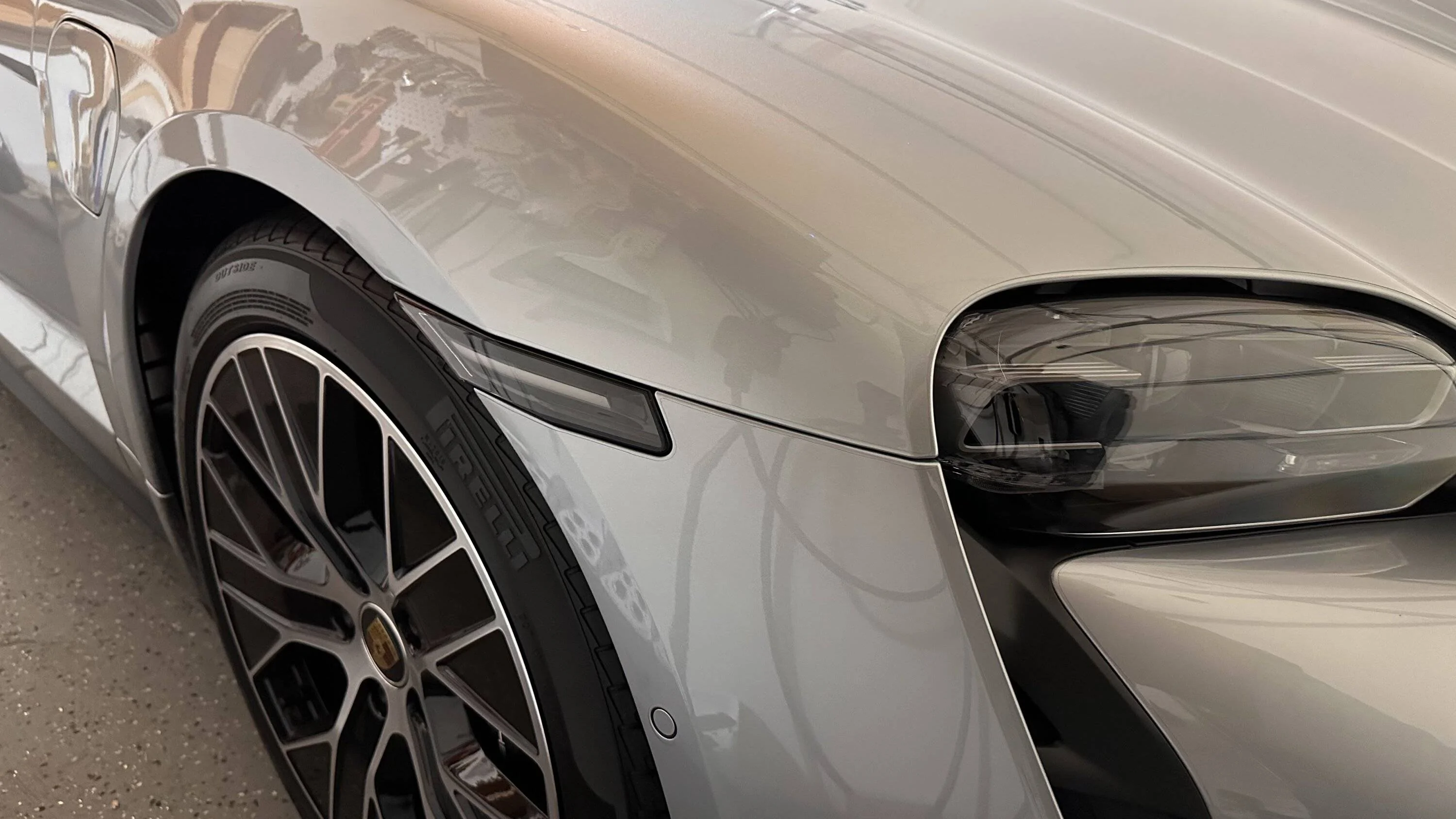

Thank you so much for the wonderful post with instructions! Just did mine today and it was super easy.

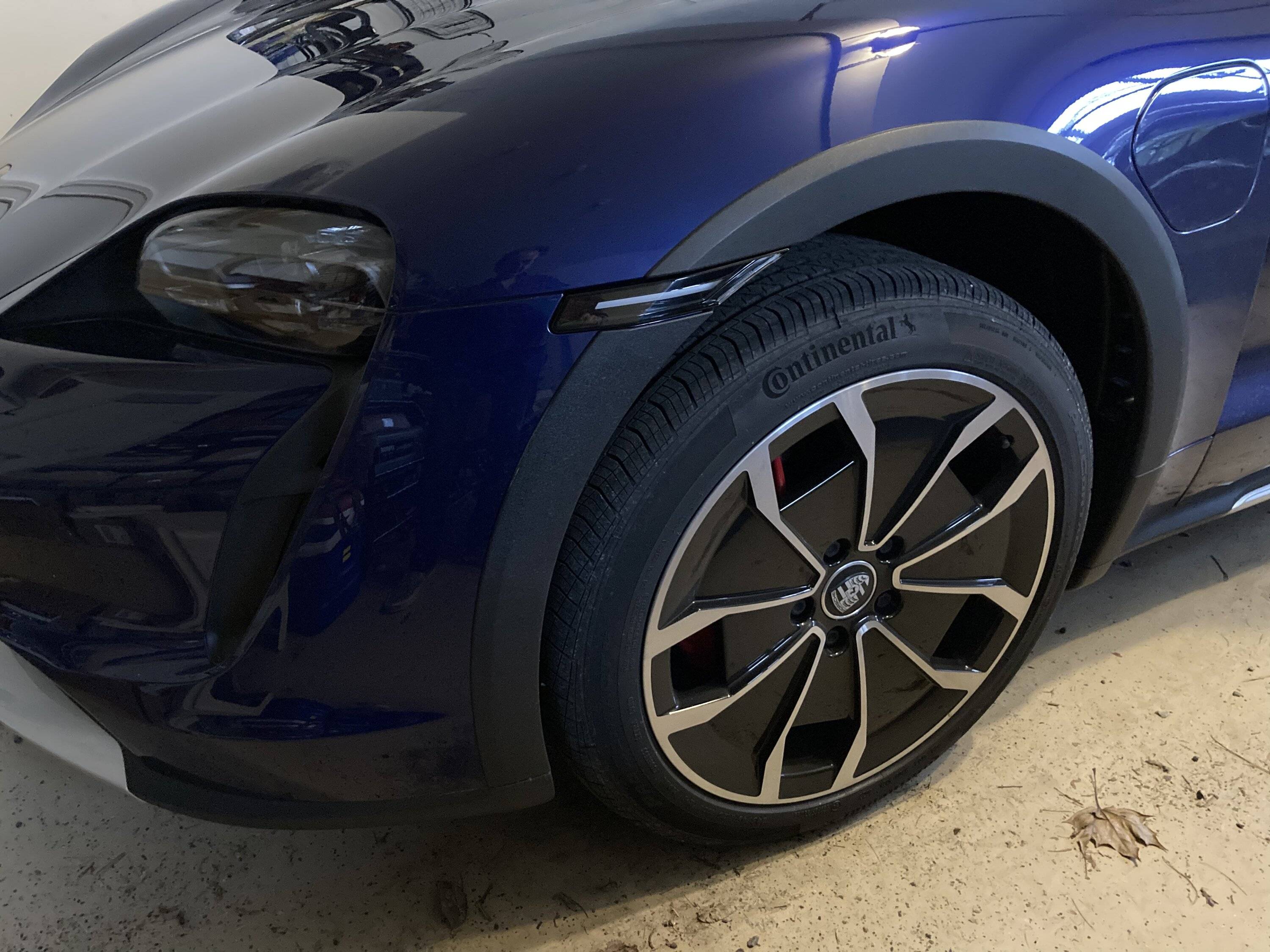

I just DIY this on my MY2022. Mine was mid-November build date. There is a very important change to these instructions, at least on my car. The screws that hold the fender liner in are T20 but the screw that holds the side marker light into the car is actually T15 on the MY2022. Took me a little while to figure this out.
On the second side, I didn't even loosen the fender liner. Just remove the T15 screw holding in the side marker light and pull it away from the car as far as the wire on the plug will allow. Then, from the front side of the car, take a small screwdriver and push on the upper part of the tab on the wire clip and apply pressure to pull off the connector while very gently pulling on the side marker light and it will slide right off.
As for the issues with it not sitting flush, there is a little plastic tab on the front of the side marker light and there is a slot in the fender where it slides in. If you don't get that tab seated in the hole in the fender then the light will not sit perfectly flush.
Also wanted to mention that there wasn't any spacer involved on the 2022. Hope this helps someone.
I can confirm, one screw only to remove and install on 2022 CT. Looks much better now. Threading the screw into the new unit in advance was very helpful. Thanks for the install tips!

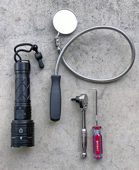

I concur. It's about a 5 minute job per side. My 2023 CT had T20 fasteners. Pre threading them helps ease the install. Tools I used below.
