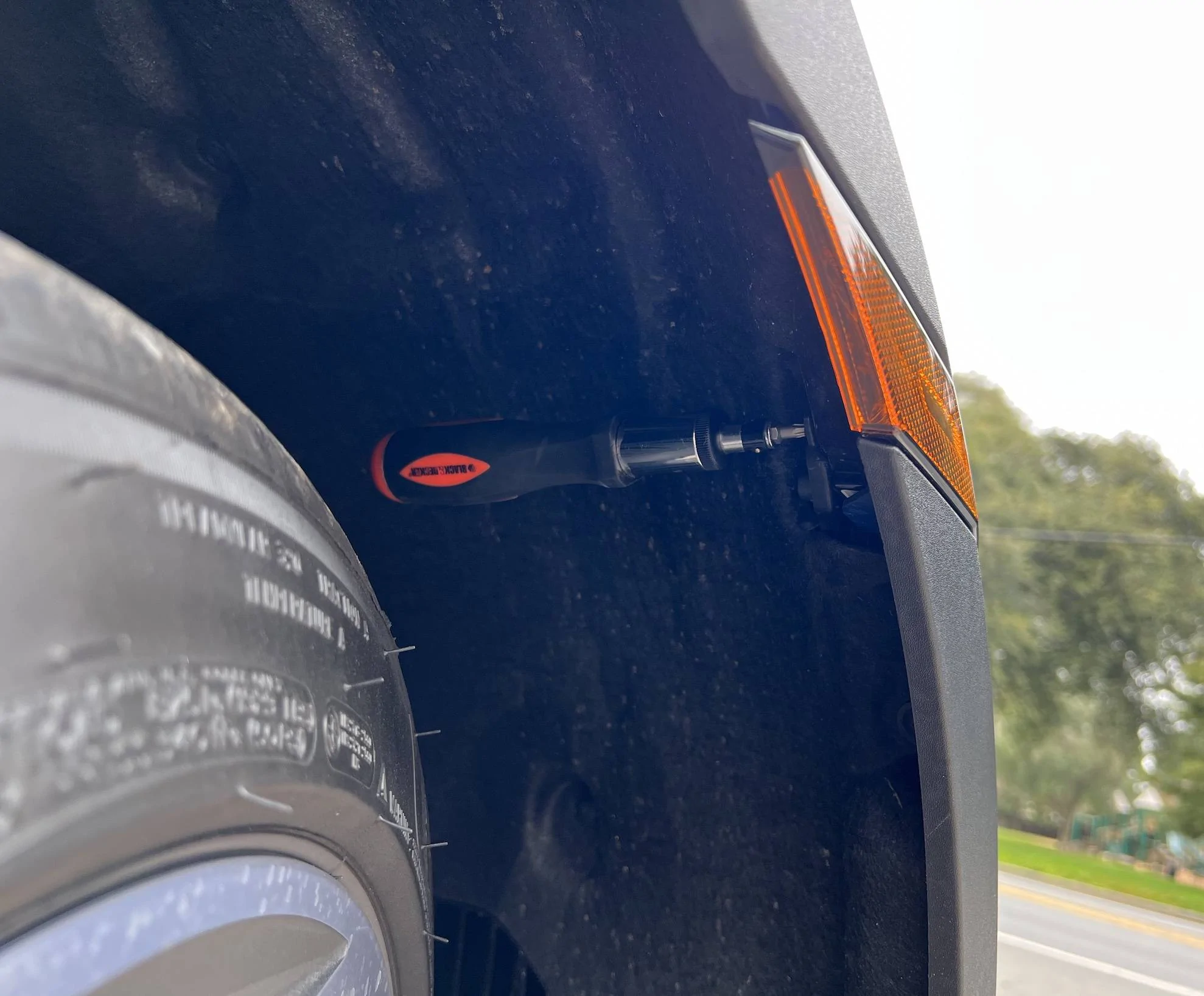

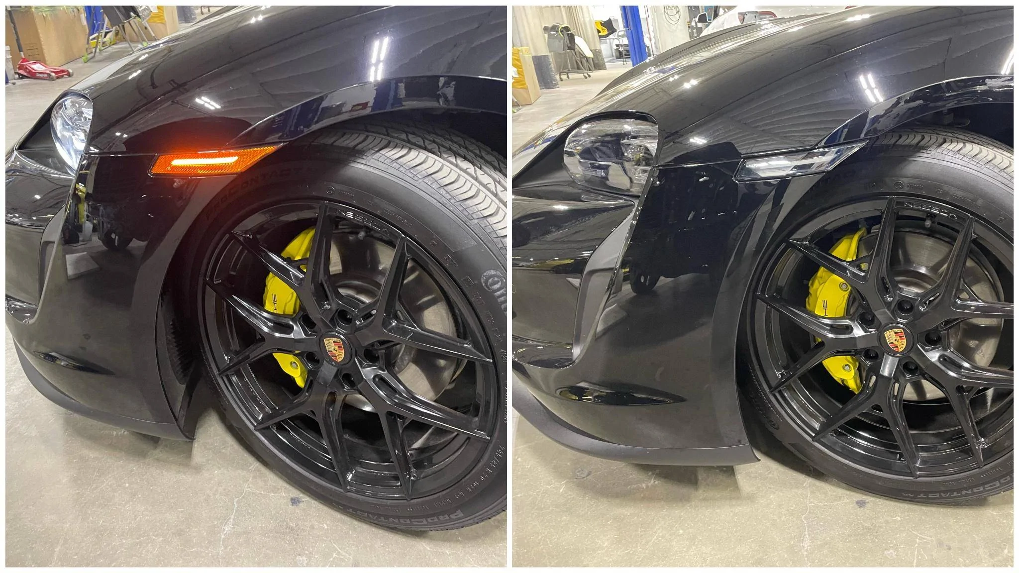

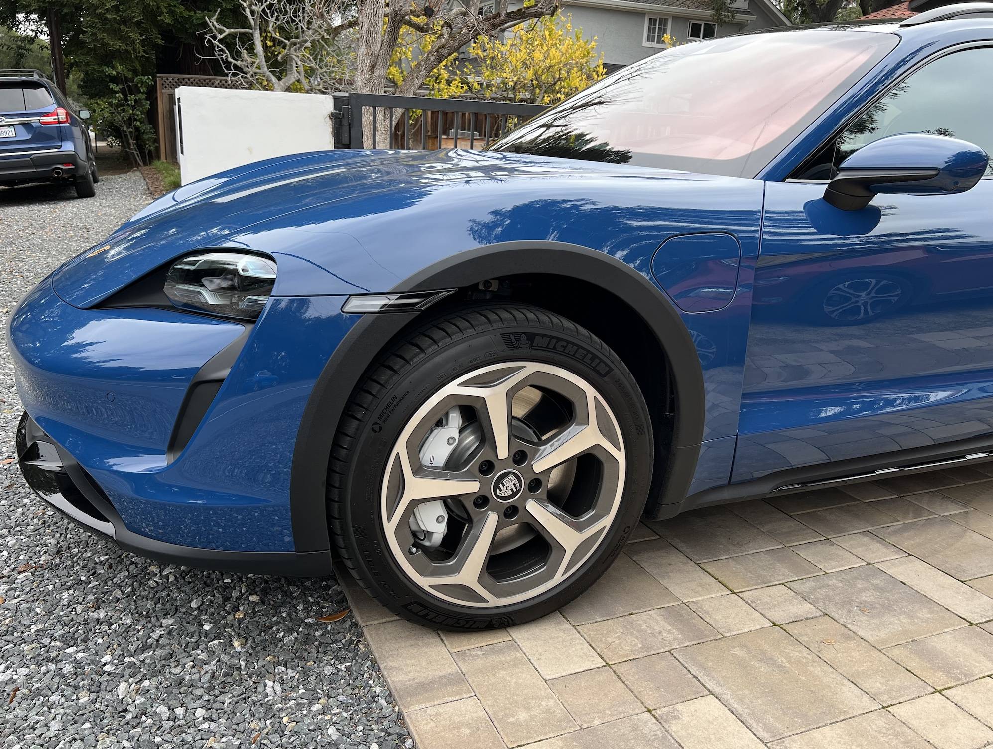

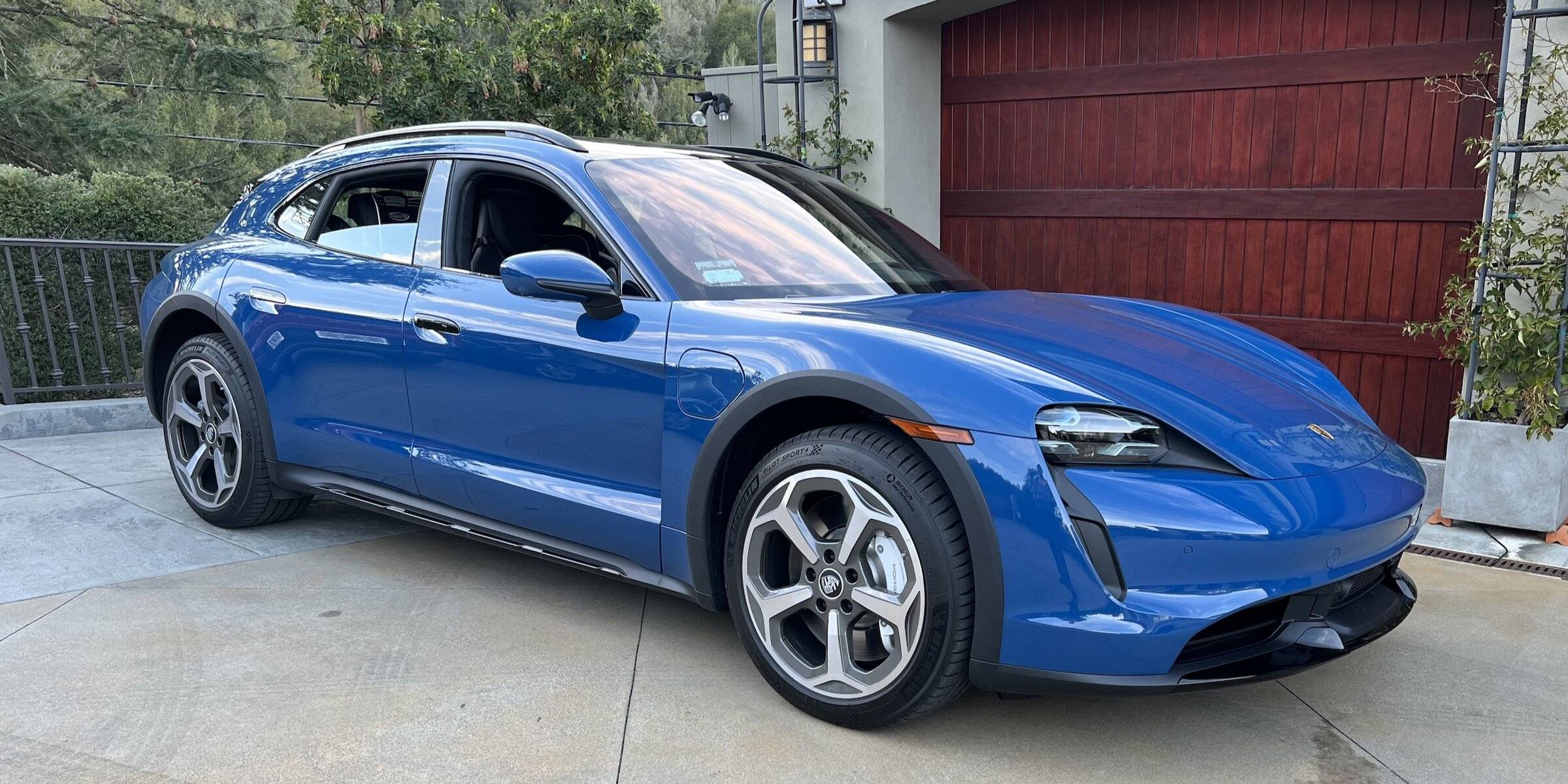

Here's how it turns out on a Neptune Blue CT, before and after, incase anyone wants that for reference. I've also included one additional picture showing the location of the most important screw (the one that threads directly into the side marker) because that didn't seem totally clear to me.
Definitely set air suspension to LIFT and lock the steering in the opposite direction of the signal to make access easier. MAKE SURE the car is off, who knows when it might decide to lower itself and that could be dangerous if your hand's in there. Stay alert.

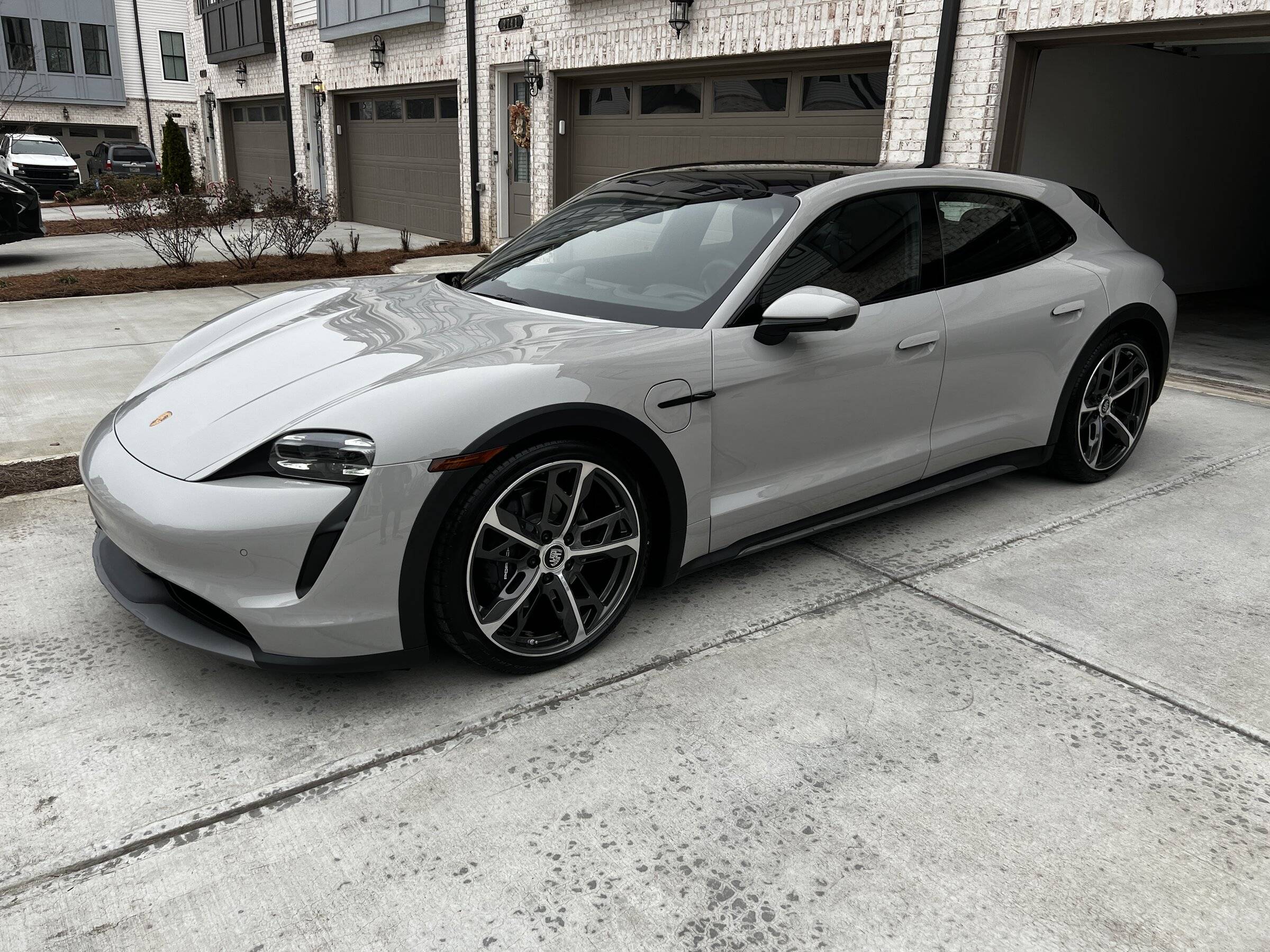

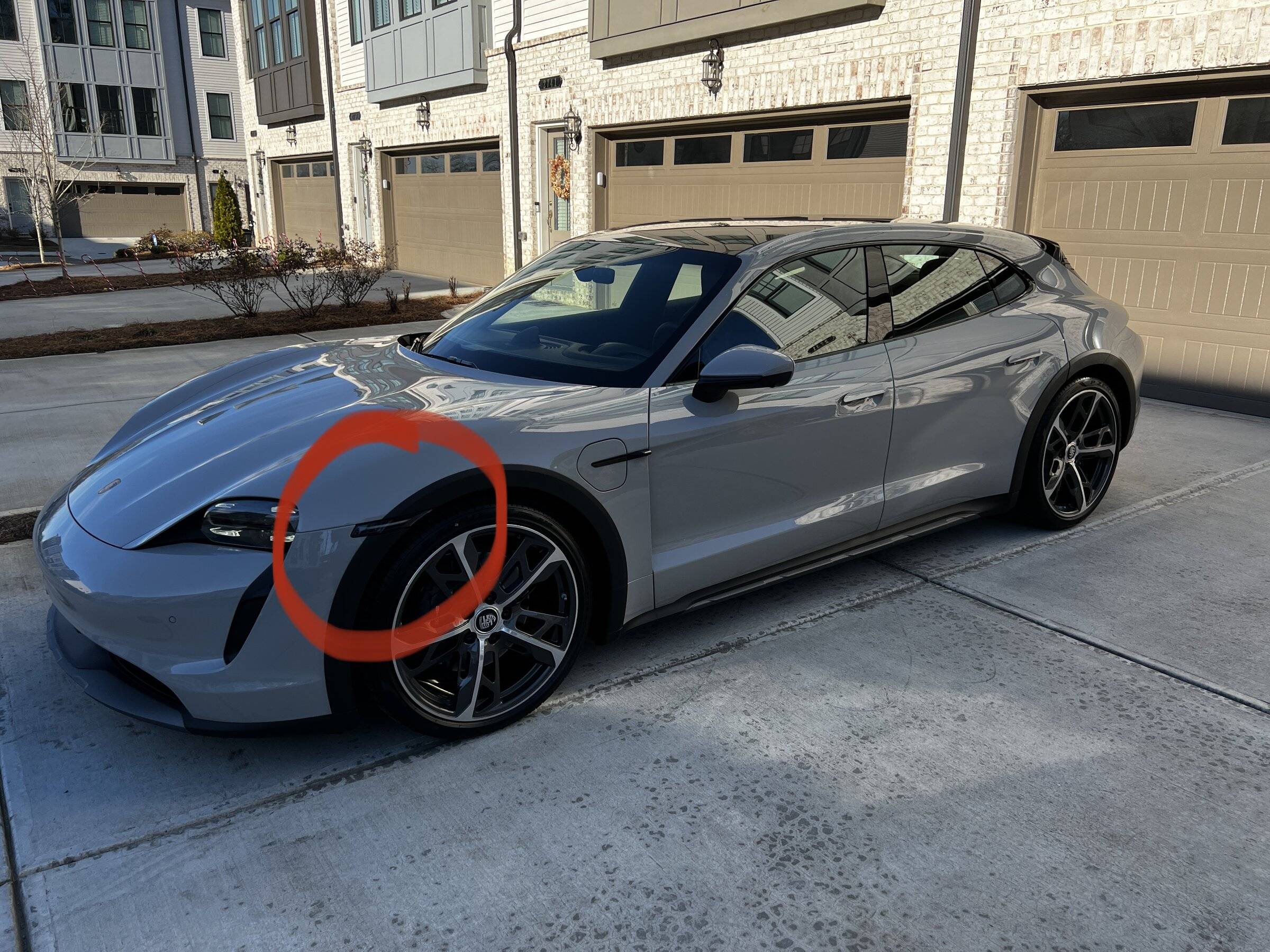

Just swapped mine too. Chalk reference.
Porsche Taycan Clear Side Markers 270C3809-1C34-49F3-92A3-45538CC71EAD
Porsche Taycan Clear Side Markers 91CDEE92-C5C7-40F8-96A8-488E8989EB7E
Oh man, it's night and day with these achromatic "colors." Even more of an upgrade than on my Neptune. Huge upgrade, nice work.
