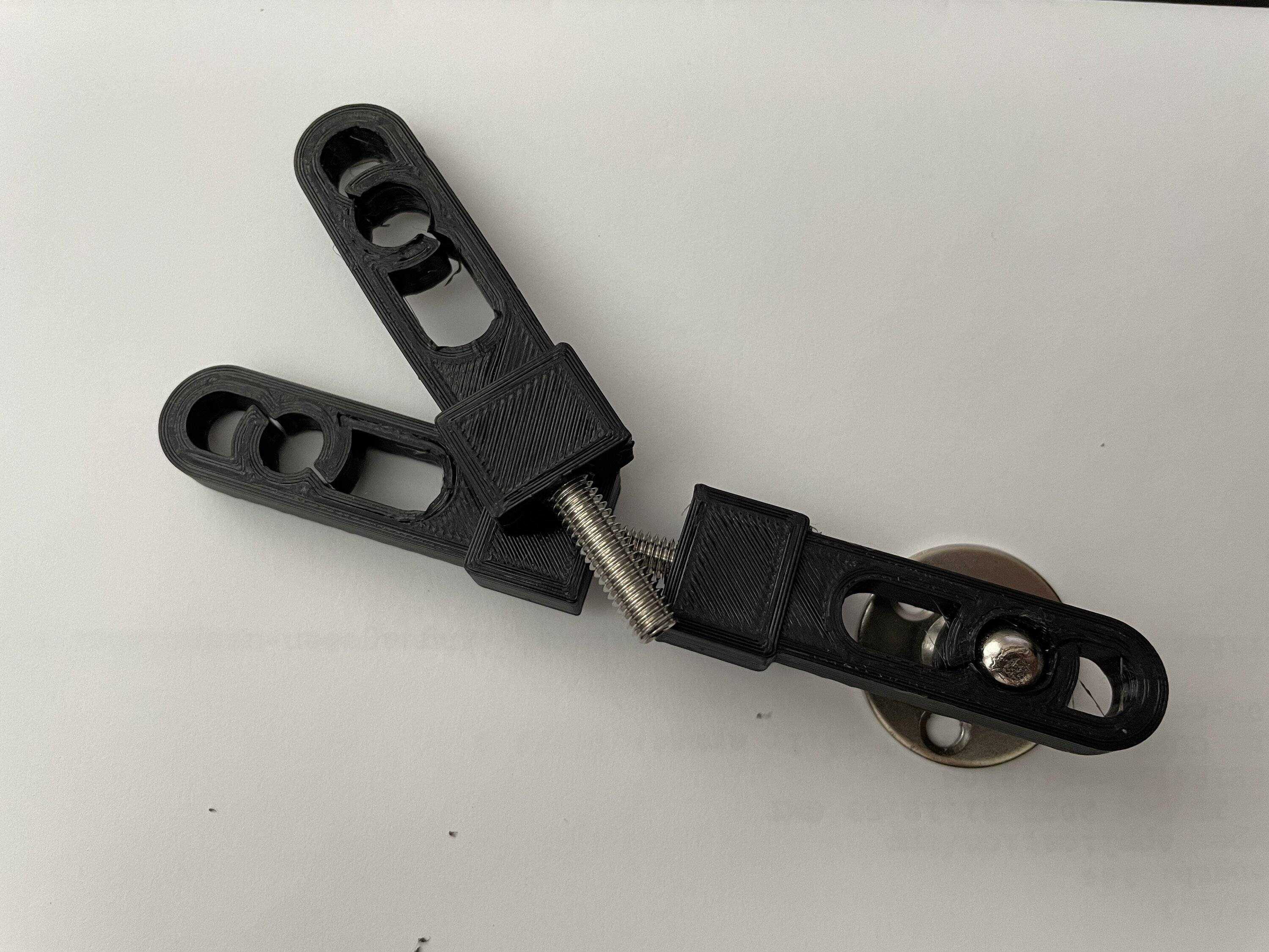

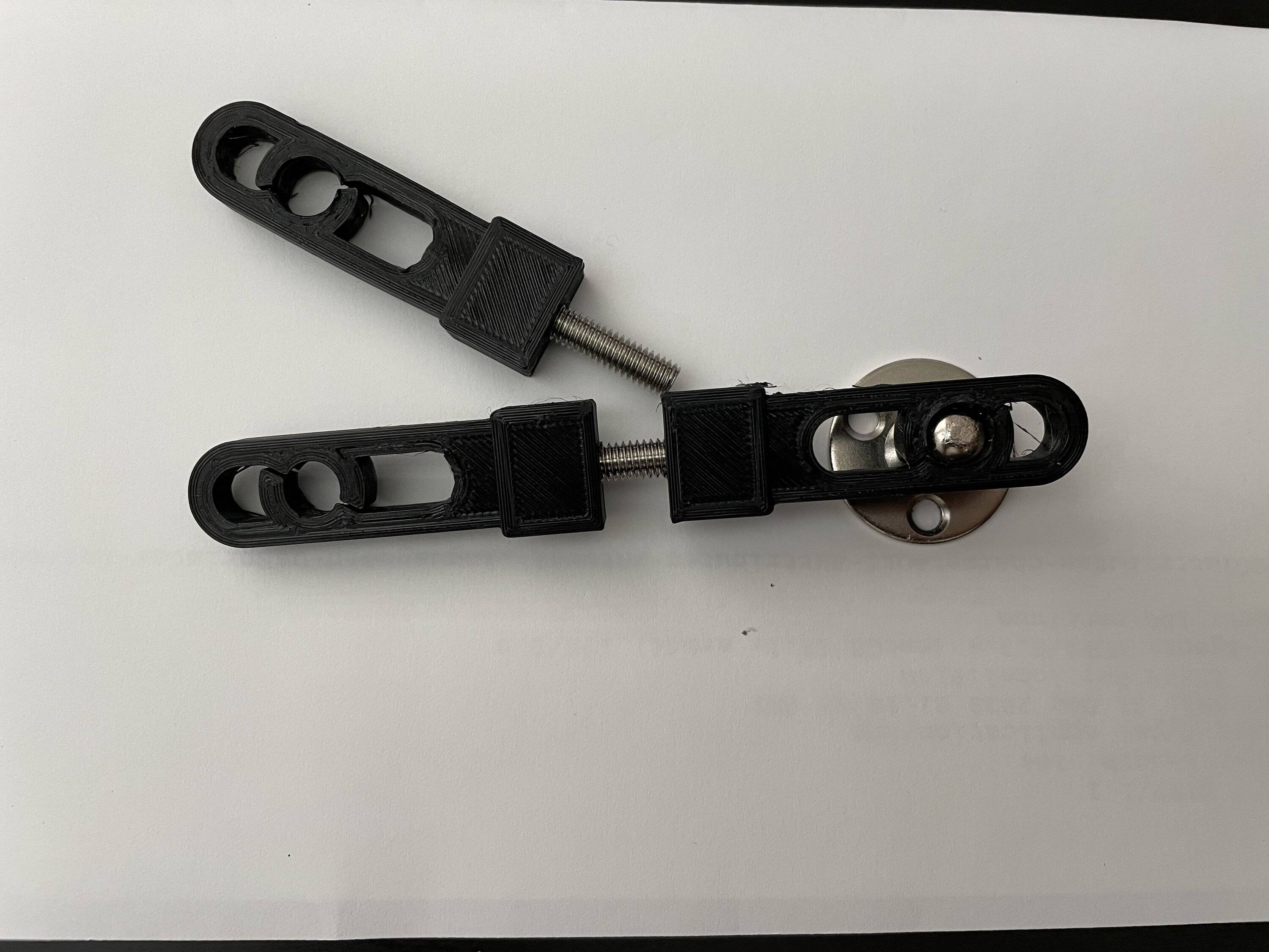

Thank you to @enginerdify for posting all of the data from your trials! This saved many of us countless "wheel off wheel on" drills!
With the data you posted, I was able to 3D print a set of lowering link based off of a Tesla design which was posted on Thingiverse by balroghuzz.
Used your sedan+ lengths, ride is acceptable at the lowest level.
Thank you again.
A few photos:
Porsche Taycan Cross Turismo Lowered + Spacers IMG_0274
Porsche Taycan Cross Turismo Lowered + Spacers IMG_0275
