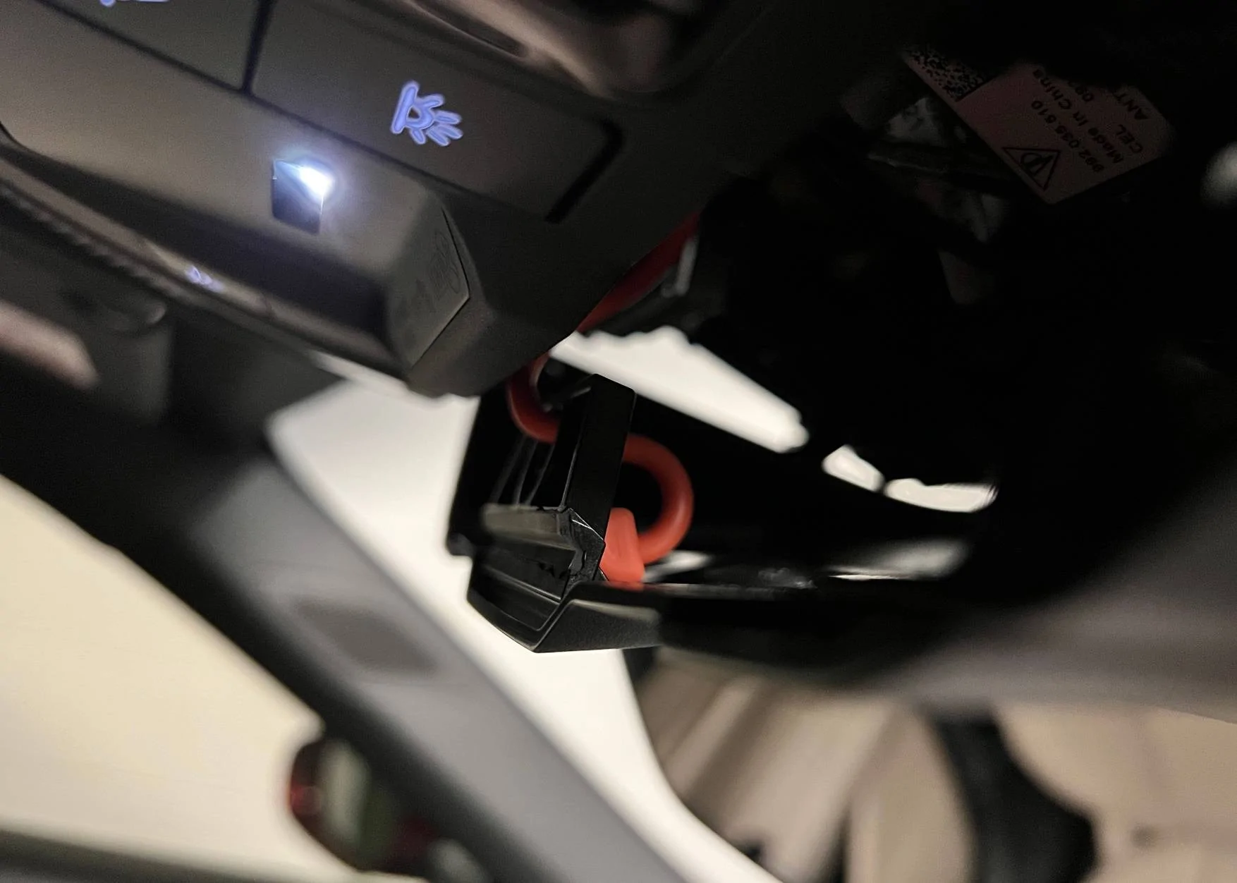

My dealer physicially disconnected a wire between the sensor and the car. Now I am on the waiting list for a new console.
Would you happen to know which wire/sensor it is?
I suspect it's this red one above the mirror:

I saw several posts on the Belgian Facebook group about the alarm issue being fixed by replacing a sensor in the roof. Apparently Porsche will do a call back to replace all faulty sensors. It is a combined hardware and software problem. My car didn’t go I production yet. Moved from 4 feb to 24 feb. Dealer says it has always been 24 but I am sure he said 4 because for 24/2 I wouldn’t have been able to take it on winter holidays and I wouldn’t have ordered winter tires yet. Anyway I hope I will get a car without the alarm issue and hope is near for everyone having it.

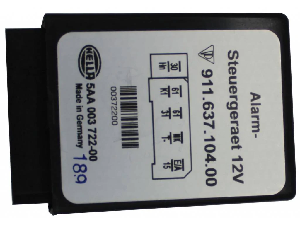

That thread appears to be discussing a bluetooth error, and the part replace by the dealer in that discussion appears to be this:
Porsche Taycan CT alarm issue, how common is it? G91163710400
In the meantime, I really dont want to visit the dealer again until they actually contact me to say have a fix for this or the next scheduled service, so can anyone post how to disconnect the sensor or tape it up (if that works)??
The Bluetooth error occurred *after* they replaced the interior sensor (and appears unrelated).
The interior sensor replacement part is PAB951172 according to my dealer, and that's the part that fixes the "alarm goes off when there's no one near the car" problem.
They said there were only 20 of that part in Switzerland and the dealership had 2 of them.
Too early to tell whether or not it does fix the problem.
