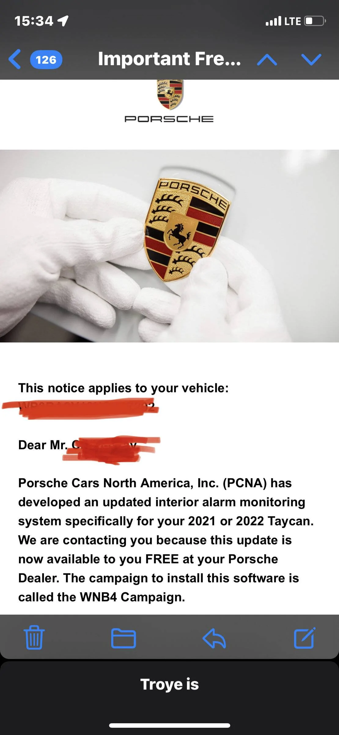

Just got notice of recall from Porsche...so that should explain it...appt next week to have it repaired/fixed with dealership made!
