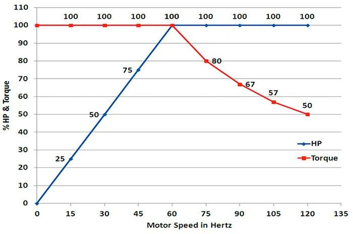

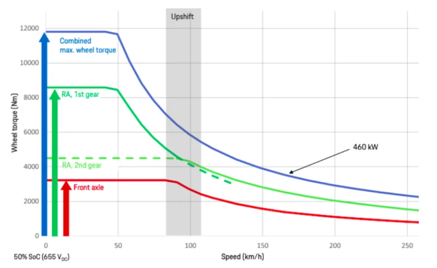

At least in the past it was common for peak torque to be quoted with a corresponding engine speed, which gave a clue to driving characteristics, but I'm not aware of any such data for the Taycan. I've seen a YouTube video that showed the plots of torque and power for a 4S on a 2 axle dyno rolling road, which showed a very (by ICE standards) flat power curve, presumably achieved by the torque delivery being deliberately managed in a way that wouldn't be possible with an ICE.
The Taycan’s torque curve is just basically this:
Porsche Taycan CT4 fast enough? 81C065E5-12BE-450C-9294-7F9605976255
With power rising linearly where the torque curve is flat and the power being flat where the torque curve tapers off.
Like this:
Porsche Taycan CT4 fast enough? F73E2B8C-7E3D-4EE0-A06A-13FB786374BA
It’s not so much that Porsche is deliberately manipulating the torque to produce a particular curve as it is the characteristic of electric motors.
Current = charge / time
Voltage = energy / charge
Power = energy / time = current x voltage
charge cancels out
Torque = power / speed
(constants ommited as that’s really only important for specific units, not relationships)
In the simplest terms, below base speed, power increases because current is constant and voltage is rising proportional to speed.
Above base speed, power is constant because volts and amps are constant.
And because power is constant, torque has to fall as the speed increases. You can’t keep the torque up without increasing either volts or amps (thus increasing power).
Porsche is only “deliberately” managing the toque curve in the sense that they are controlling the drive for the motor. But that’s kind of just how it is.
Note that there are variations on this. For example, some motors are wound to hit constant power before full volts. In this case, current is reduced while the voltage continues to increase. But the basic principles are the same.

Thanks Jeremy, I'd seen the first graph but the motor power/torque one is new to me.
How does Overboost change the picture?
I couldn’t comment on the specifics for sure as I don’t know how it’s implemented.
But, typically, you allow more current to increase torque. The key is to not damage the motor from excessive heat.
You can typically apply more current than what the motor is rated for, but only for a limited time. It’s a thermal model. Or to think of it in simple terms, just imagine an integration of current over time.
High over current = short time
Low over current = long time
Temps increase above rated values as the current is over rated value and increase at a faster rate the higher the current.
You need to keep the average below the motor’s thermal rating as well as not exceed the peak.
This does also generally degrade motor life, although I would not let that statement concern you as it relates to the Taycan. The amount is small unless the thermals get extreme and, as it’s been discussed elsewhere, electric motor life is very very long.
It’s actually very common to size a motor taking this overcurrent into account. For example, lots of applications rely on over current for accelerating loads and it’s typically fine as long as the continuous load is below the motor’s rating. It would be much more expensive and unnecessary for the motor to be sized to handle the acceleration torque within its full load rated current.

....typically, you allow more current to increase torque. The key is to not damage the motor from excessive heat.
Thanks again for the explanation...so I now appreciate the reason for limiting availability of Overboost to just the initial period of launches- though it's a pity that it isn't more usefully available elsewhere, e.g. by the traditional button in the Sport Chrono dial in ICE Porsche's. Maybe it was decided not to implement that because of the issue of over-use resulting in thermal management not always allowing the driver to get the expected boost.
And, in the context of the discussion of CT4 v ICE power delivery, I think it confirms my assumption that any EV (but particularly one with >1 gear) is capable of delivering near-peak (with or without Overboost) power over a greater proportion of its speed range than does an ICE vehicle.
