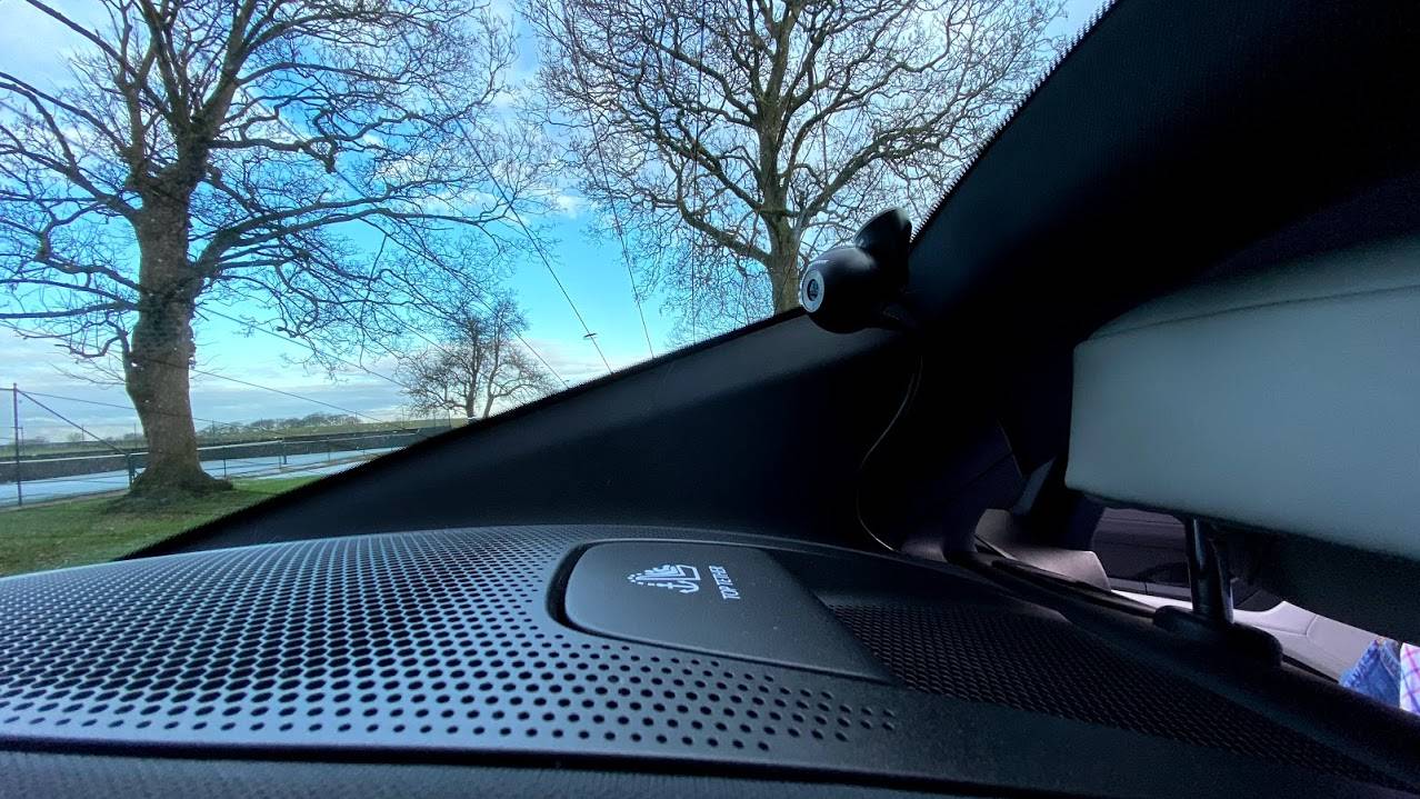

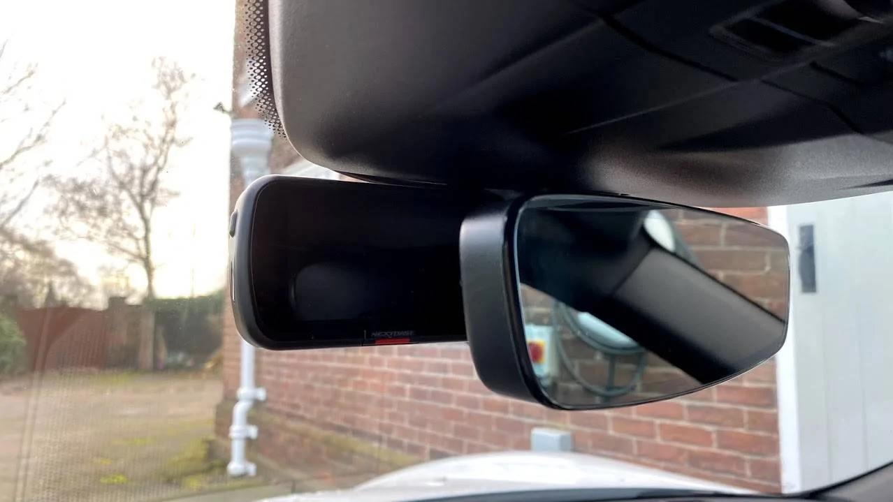

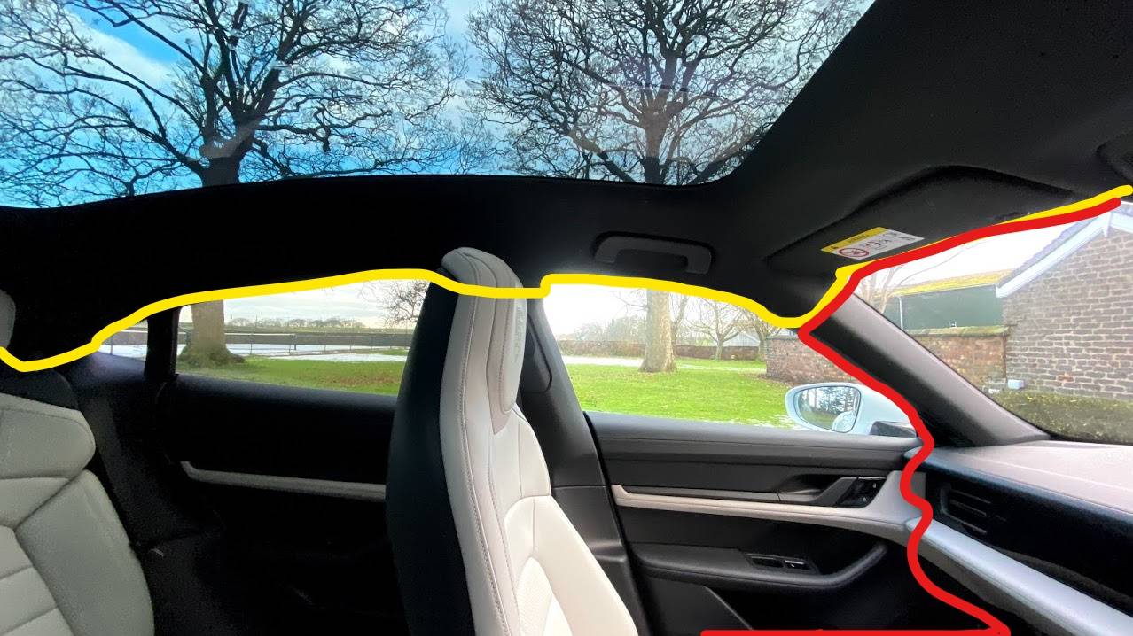

I installed the front & Rear Nextbase 622w 4K camera.
Placed so you can't actually see the front camera when you are driving.
Pictures attached but the red line shows cable path between the front and rear camera, the yellow is the path between the front camera and the power in the centre console.
Pretty easy install, took about 30 mins and you cant see a single cable.
