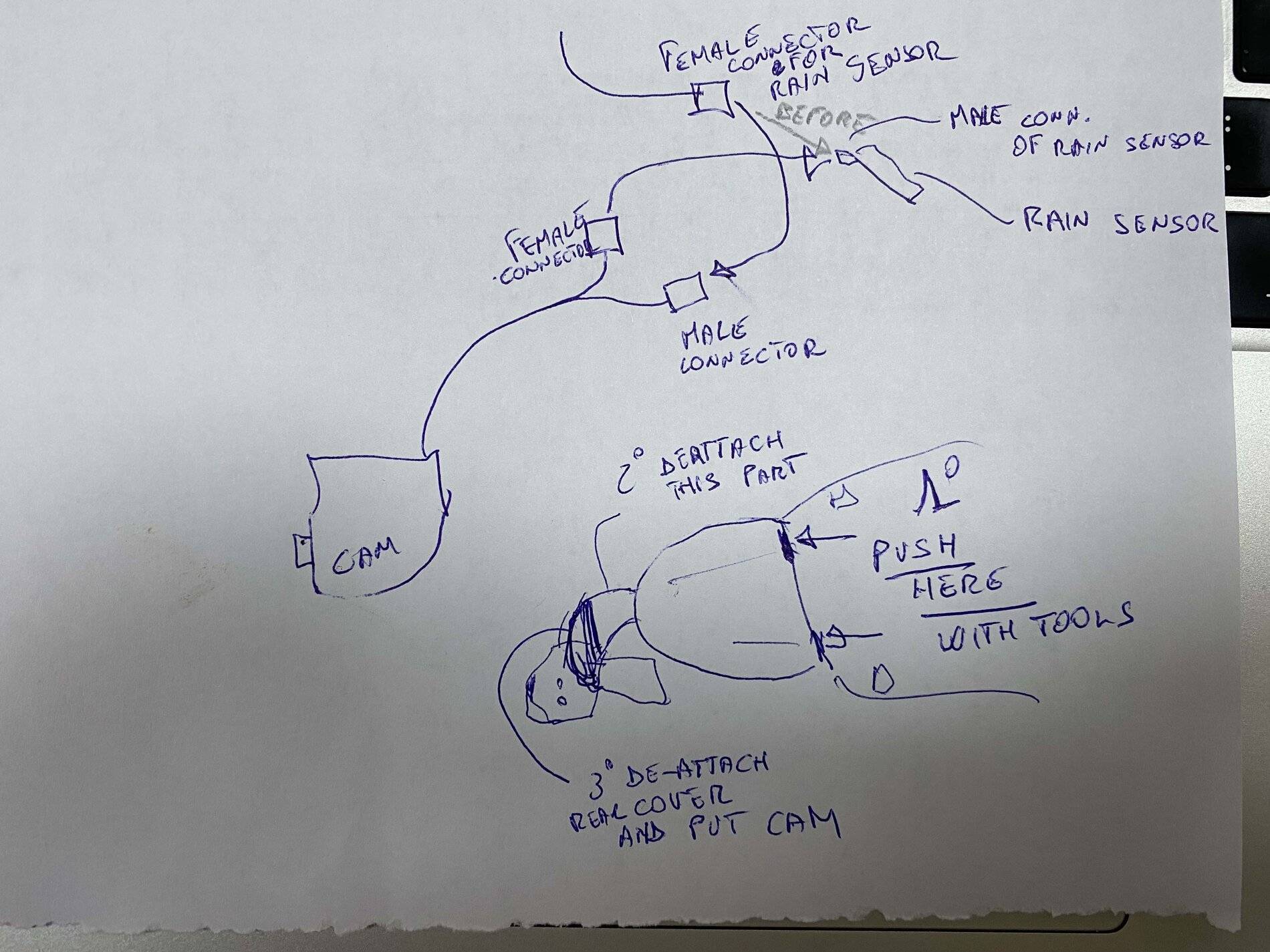

Ok, it's very simple, to mount, if you need i i try to explain better all the procedures.
The wiring system is simple too
the cam has wiring with two connectors, you must attach one instead of the connector for the rain sensor and the second to the rain sensor.
The connector for the rain sensor give negative, positive (all time) and positive on power on of the car.
The cam doesn't have a big consumption even if you use while the car is parked.
You can choose how many hours you want save after lock the car. The cam after sometime compress the video near 1 fotogram per second in this case.
The cam also rec video when the cam has some acceleration if someone hit you car (i don't try this :)) even if the car is locked and you don't have parking registration enabled.
I use TimaCam app instead of Roadcam App because i think is better.
One thing that i don't like is that all videoclip lenght is 1 minute. So if you drive for one hour you will have 60 videoclips.
The settings don't change this, i've contacted the seller and he said that the option of videoclips much bigger is not eabled.
I will attach one diagram of wiring system (sorry but i do very fast now)
Porsche Taycan Dash cams IMG_7566

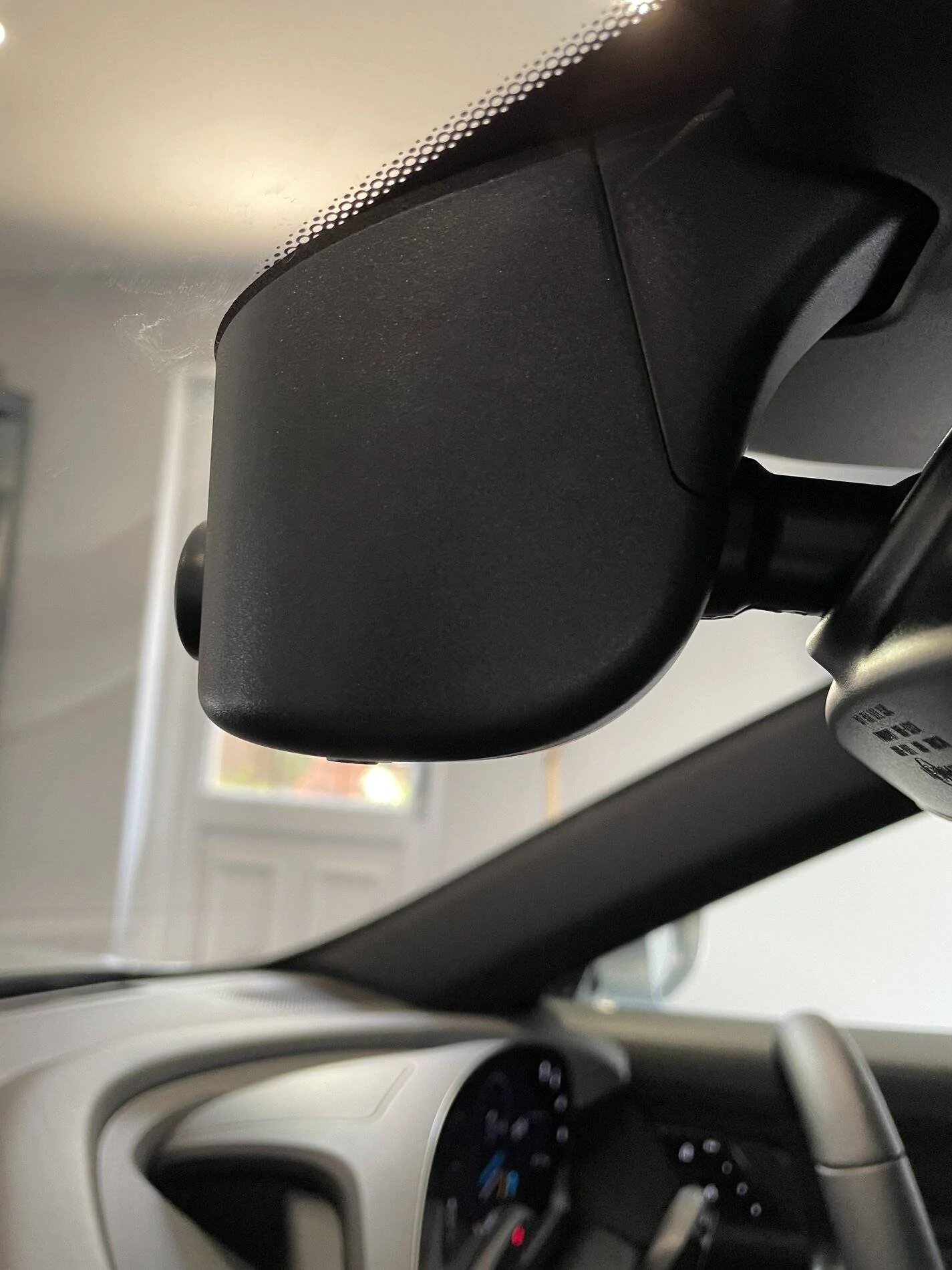

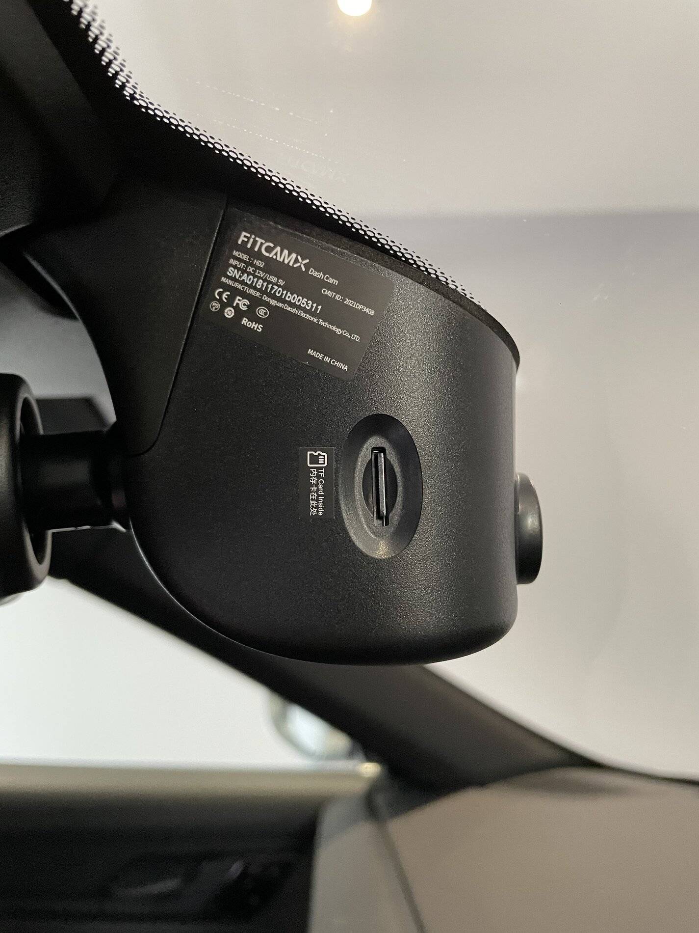

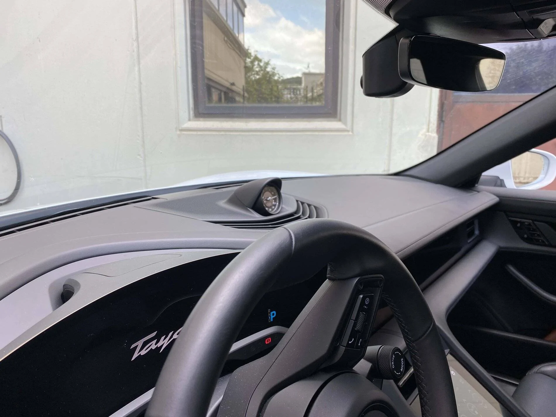

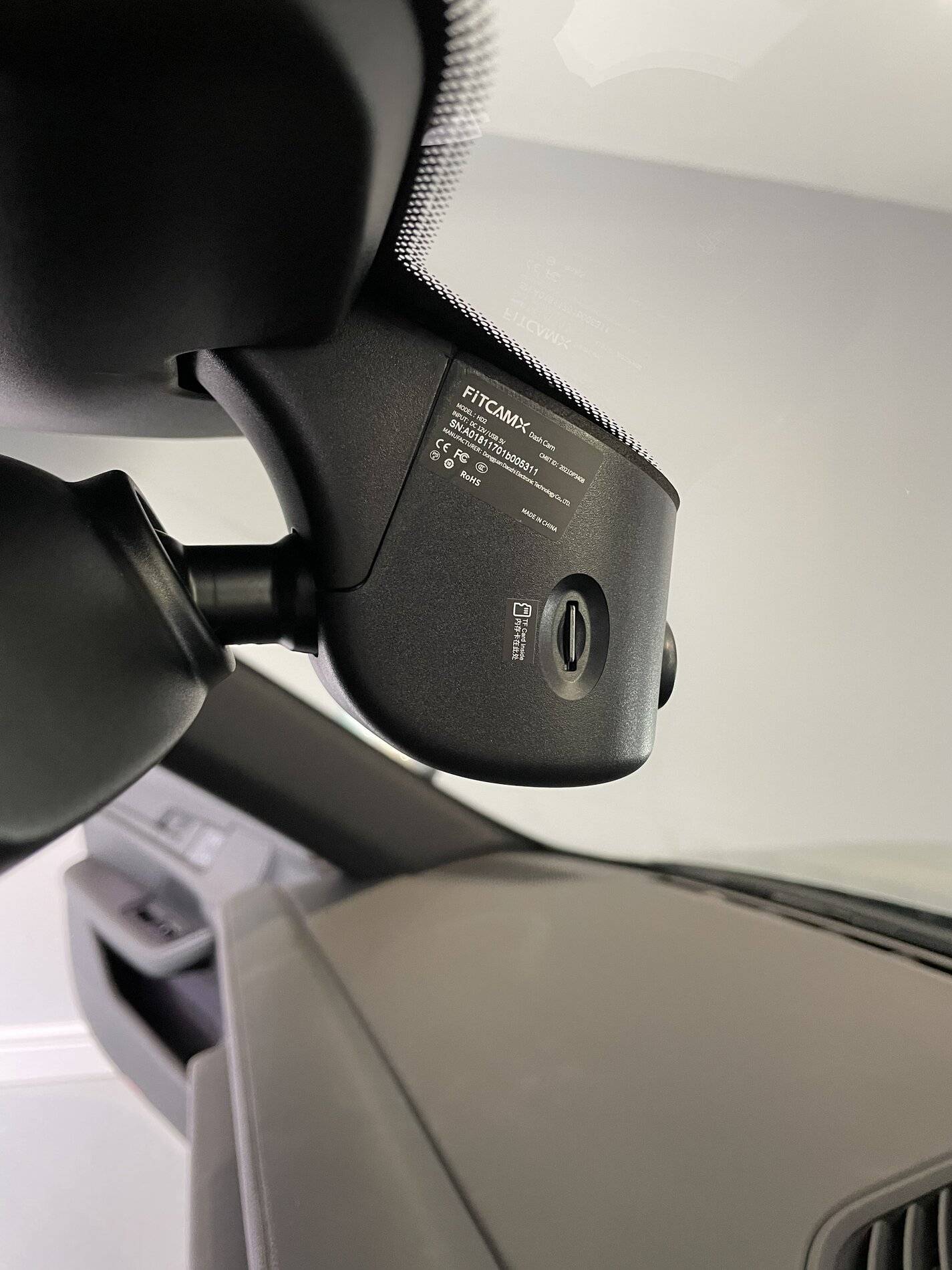

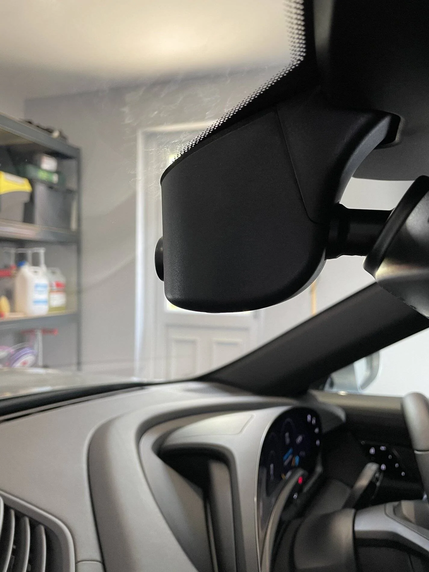

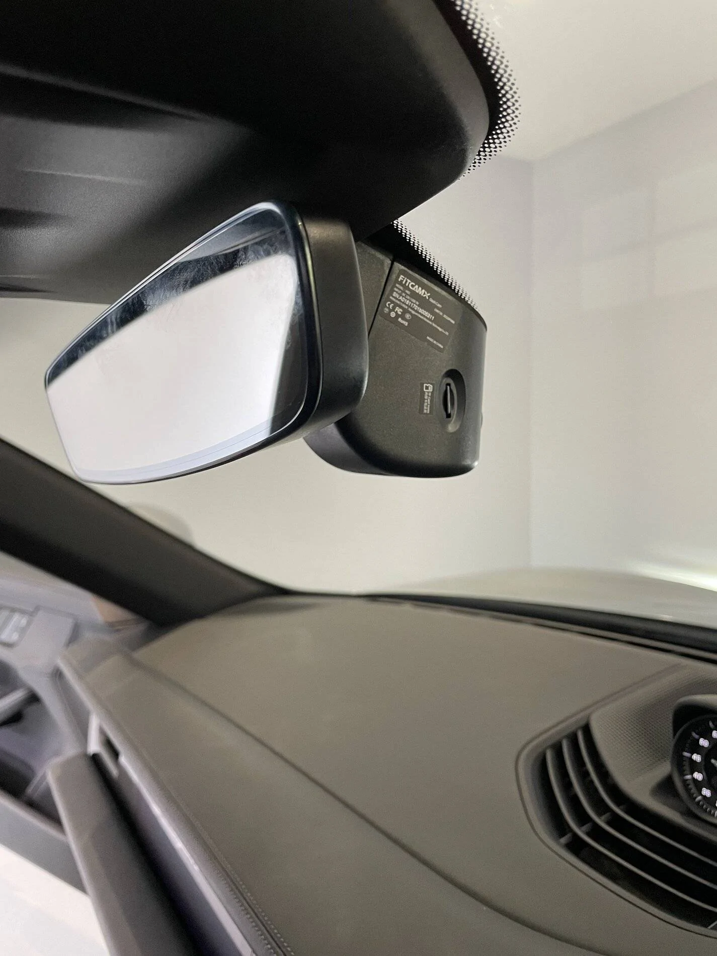

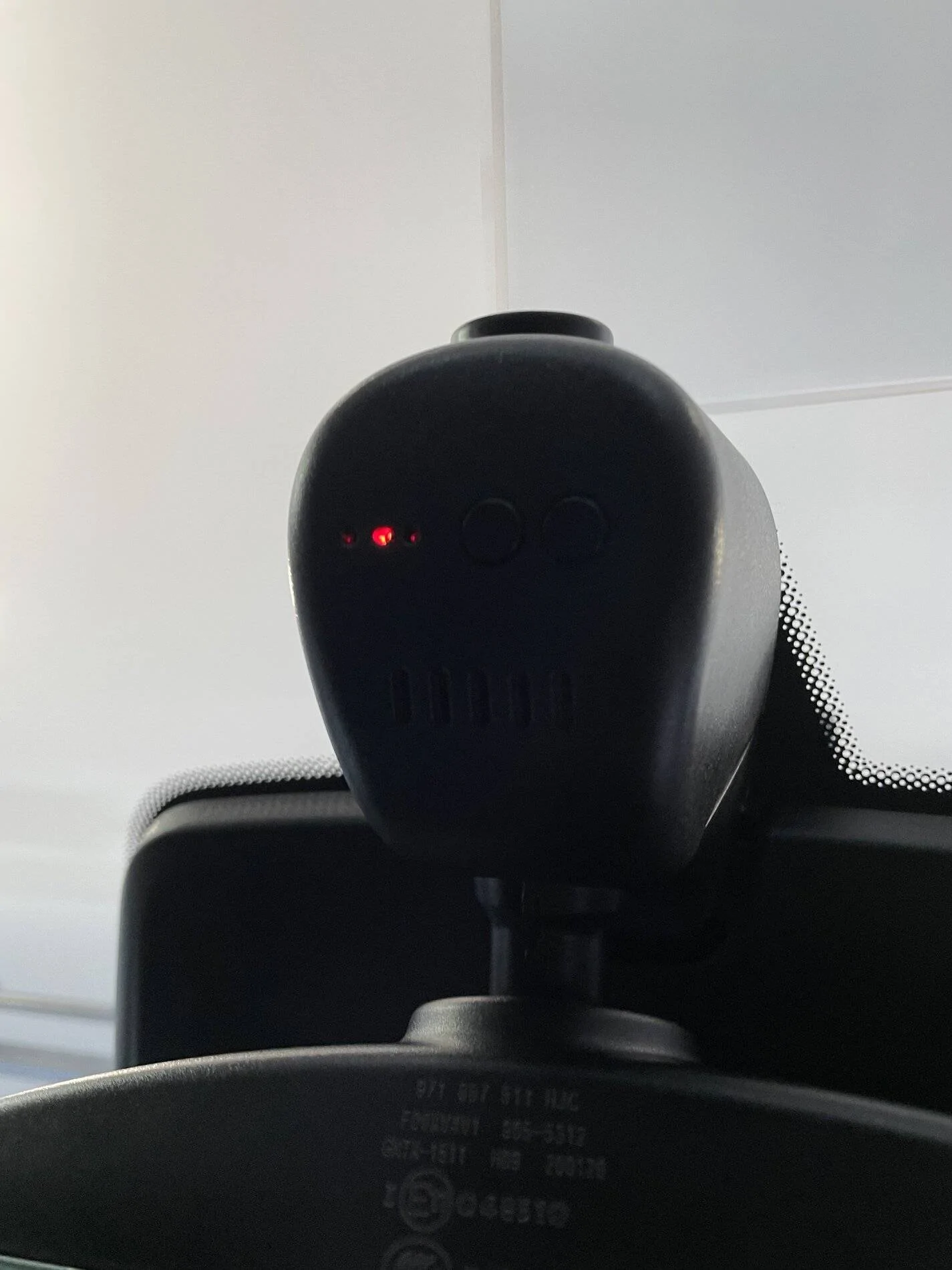

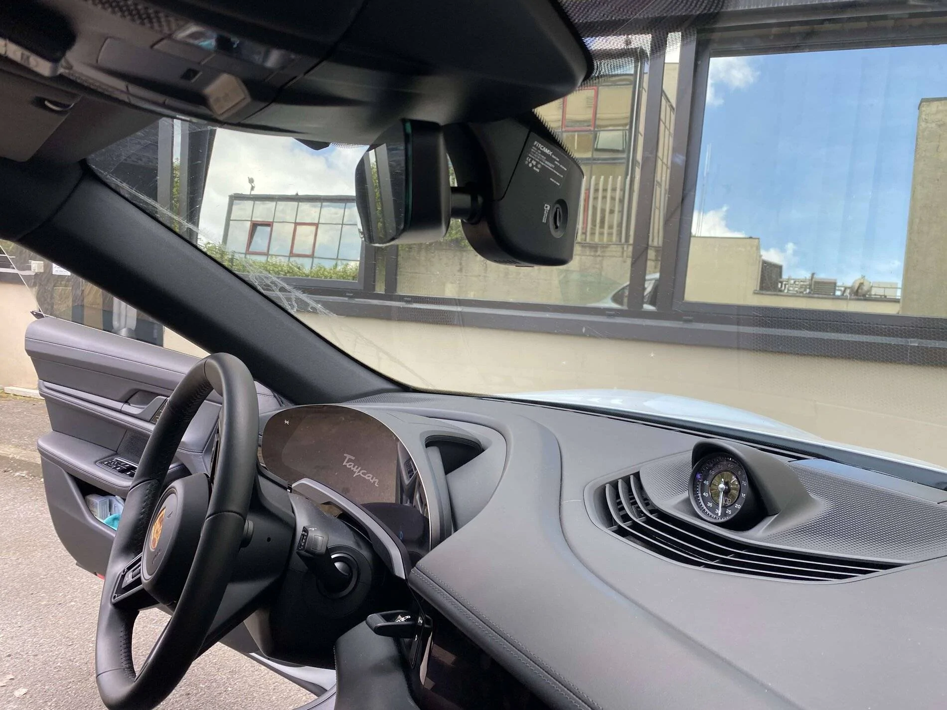

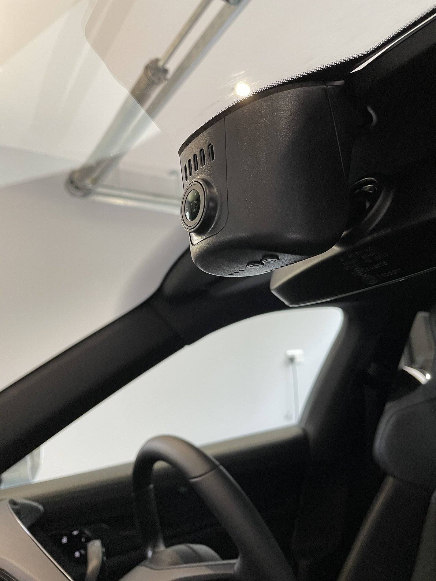

Received my FitcamX in 3 days from China via DHL - import charges already paid within price. Fitted in 30 mins. Connector fits into the existing rain sensor connector. Looks completely OEM.
Porsche Taycan Dash cams 6DF6CECE-89D0-4B47-848B-011F8EBC8D2D
Porsche Taycan Dash cams 324FE647-C571-4A95-83B3-4E61CBC9C726
Porsche Taycan Dash cams 8E046197-0E08-41C5-9A0F-30E5D458ECF4
Porsche Taycan Dash cams 509638D4-C787-4F07-B93E-028EFD611BD1
Porsche Taycan Dash cams A423331B-AFB8-412E-BE7D-D920619900FC
Porsche Taycan Dash cams D2CD9828-EE54-4429-90D0-F29AF4F34663
Porsche Taycan Dash cams 7246D6C6-B00E-4B3D-9307-1F4171C5BD06
3,907
3,552
Nice installation . Looks great!
