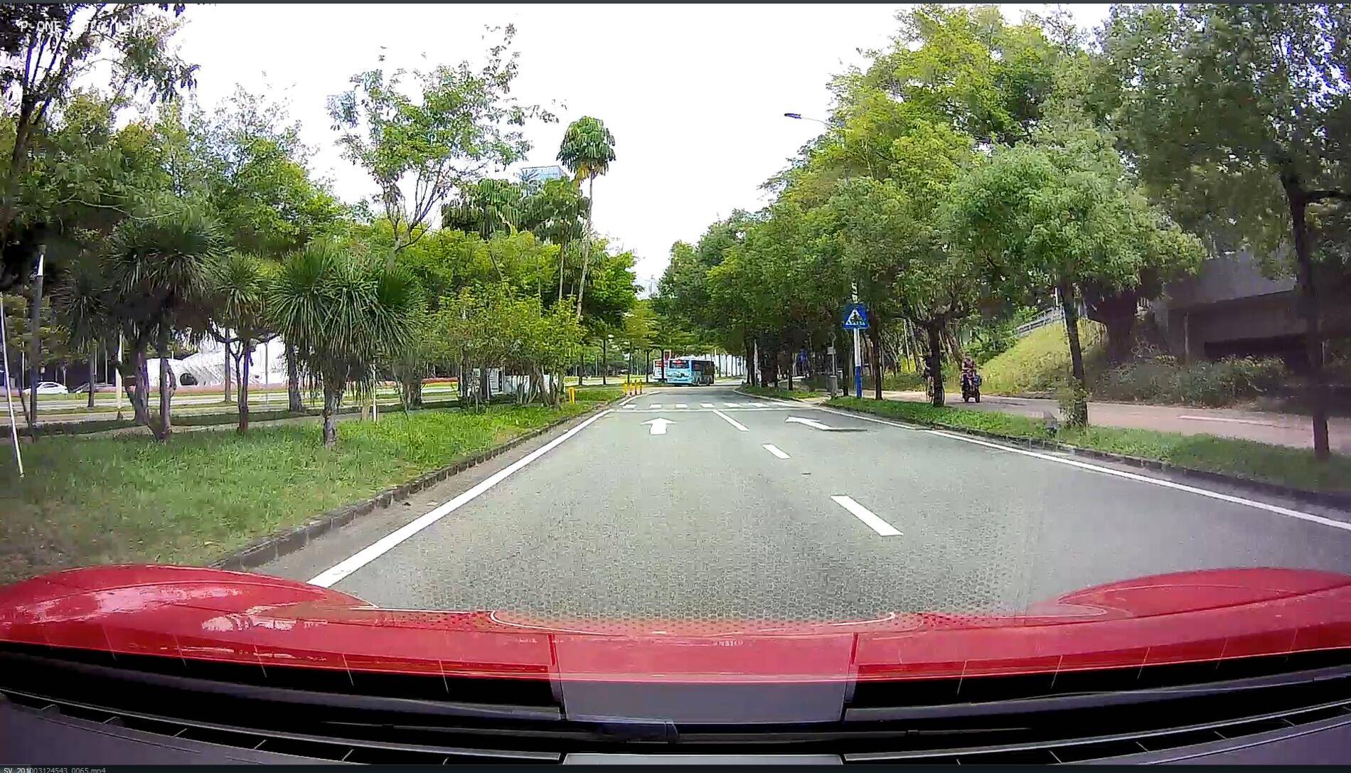

Dash cam made in China! Camera records in HD 1920x1080 pixels:
Porsche Taycan Dash cams 1613265804596
Porsche Taycan Dash cams 1613265913577
This is a screenshot in full resolution:
Porsche Taycan Dash cams 1613266248189
I use a 256 GB micro SD into the slot. The camera was installed by the dealer free of charge. It is very clean and records as soon as the car is switched on.

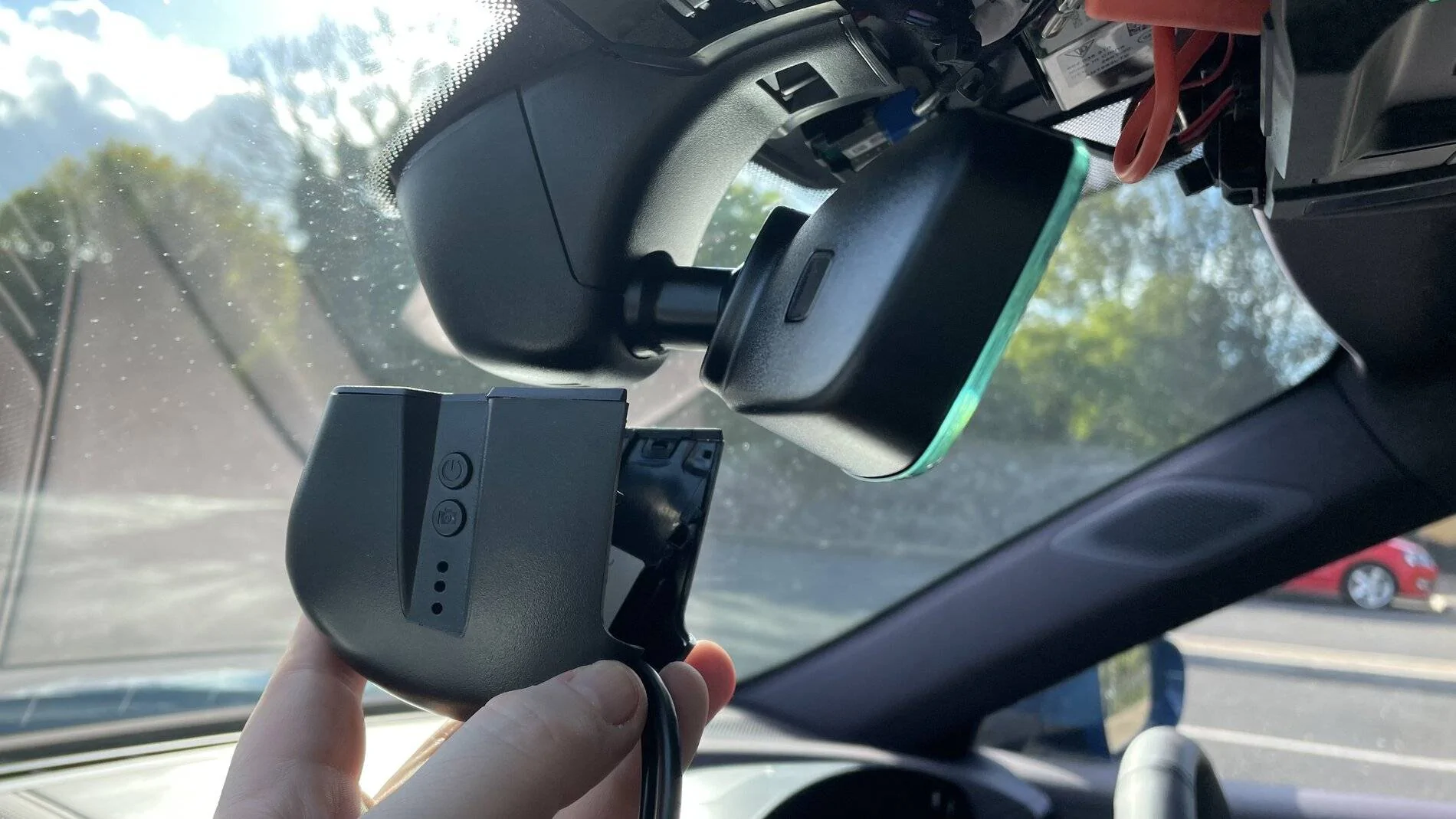

I am currently looking at installing a dashcam that integrates in with the Taycan mirror like so:
Porsche Taycan Dash cams IMG_0398
However, I'm struggling to remove the middle (and lower) trim pieces.

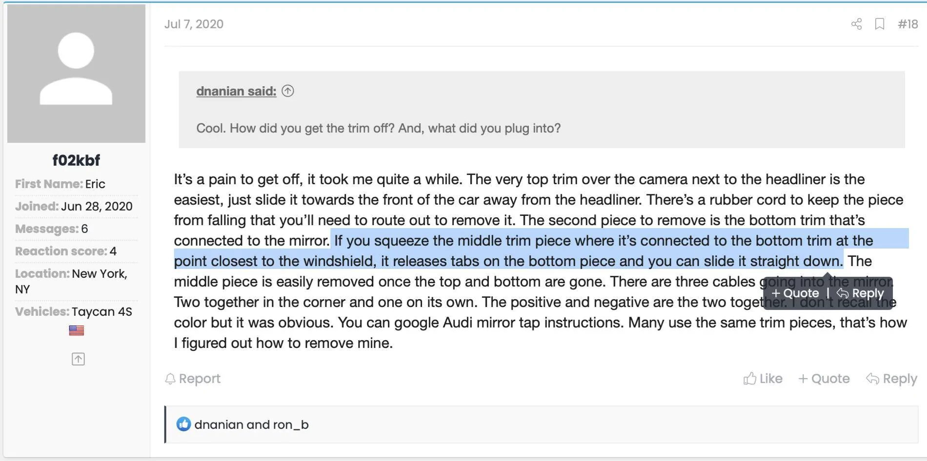

In a post a year ago, you wrote:
Porsche Taycan Dash cams Screenshot 2021-04-30 at 19.02.40

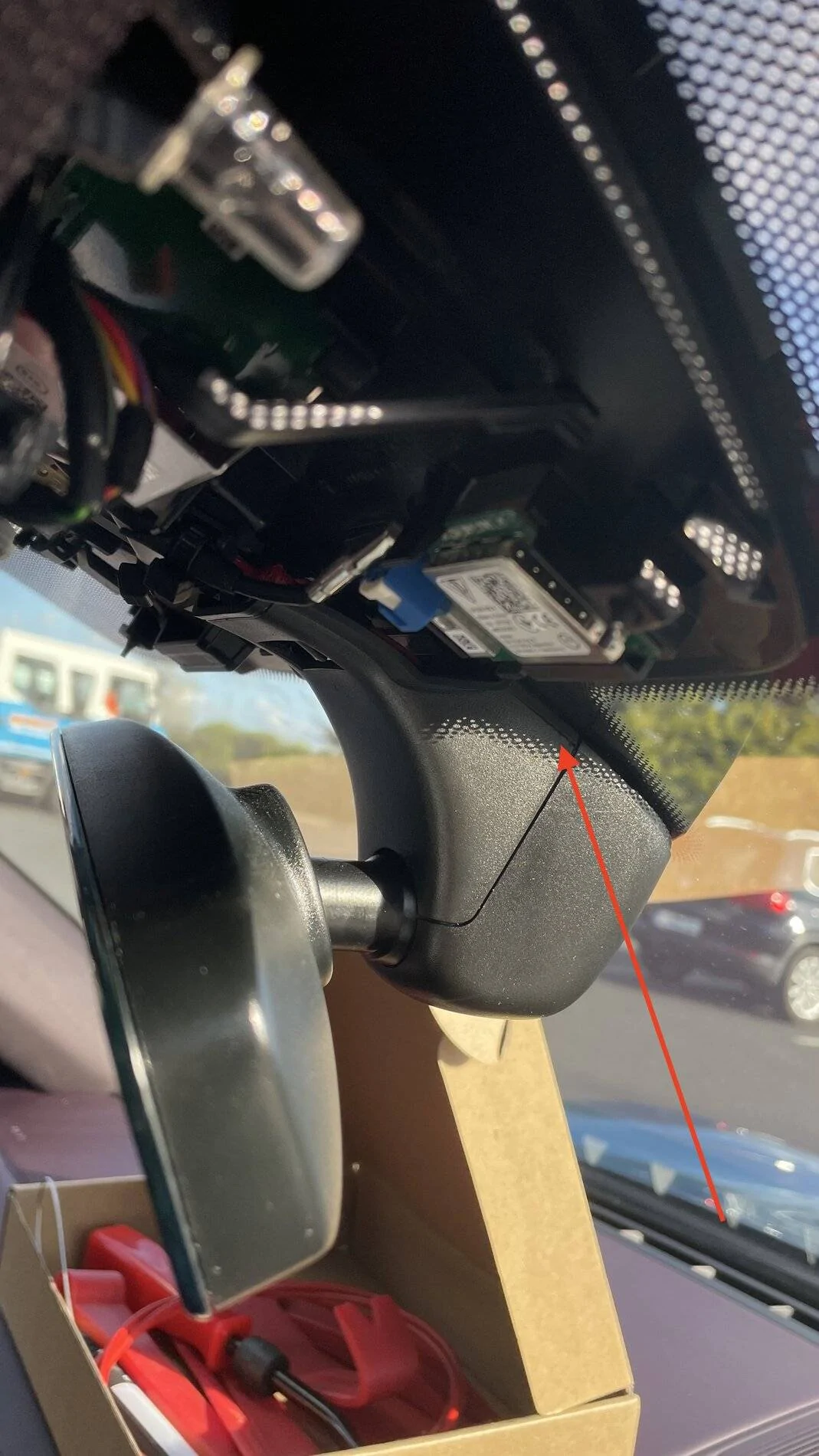

I've been pressing here on the trim piece:
Porsche Taycan Dash cams IMG_0404
but I cannot get it to budge! I've really pushed it quiet hard and can see the plastic flex, but there is no movement of any tabs.
I was just wondering based on your experience if I am pushing in the right place?
Does my pic look familiar from your time doing this ? I am wondering if maybe MY21 cars are slightly different and I am doing the wrong thing.
Any insight as you've done it before is very welcome!

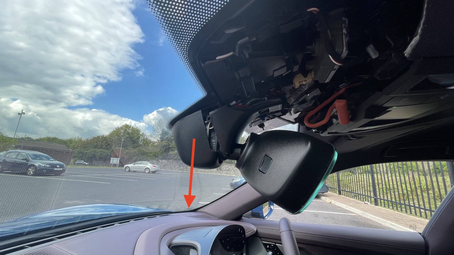

Okay, I managed to get the middle bit unclipped - but no matter how much I pull on the final trim piece it will not budge. Its amazingly stuck solid!

Did you manage to get this fitted in the end?
