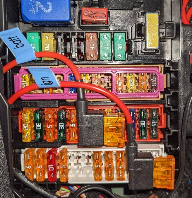

Agree 100%. Its no harder than any gas car. YMMV, but here is how we did ours:
Porsche Taycan Dashcam in a Taycan? FuseTaps
Fuse box just left of the driver's left foot.
pop off triangular plastic trim piece
fusebox right behind that
used these taps
https://www.amazon.com/gp/product/B085MGP931

Blackvue monitors if you wire to the fuse box.
Simple install. Run the wires by the door and not in the headliner. Did it myself in a couple of hours. Cannot see any wires other than right at the camera.
