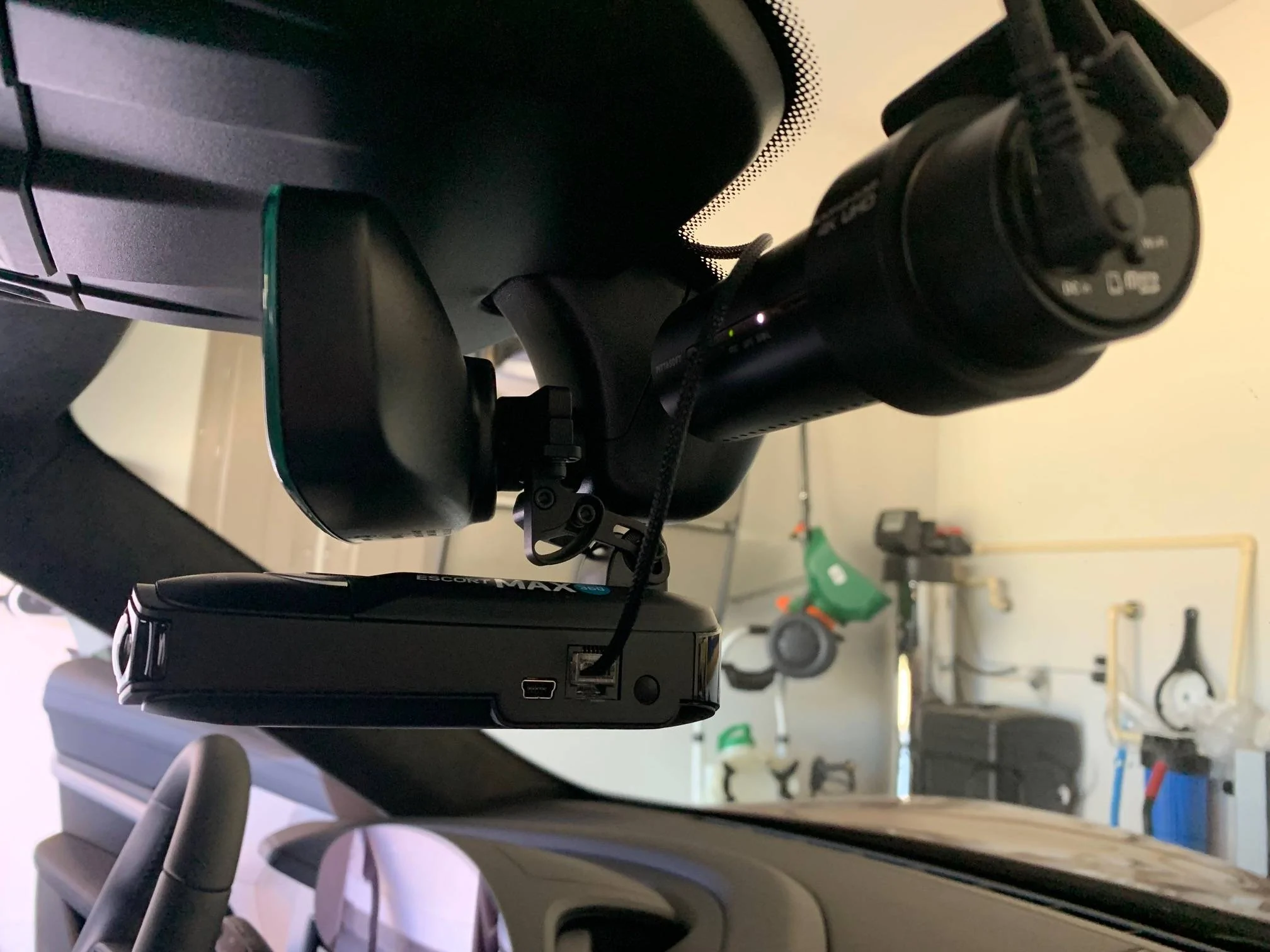

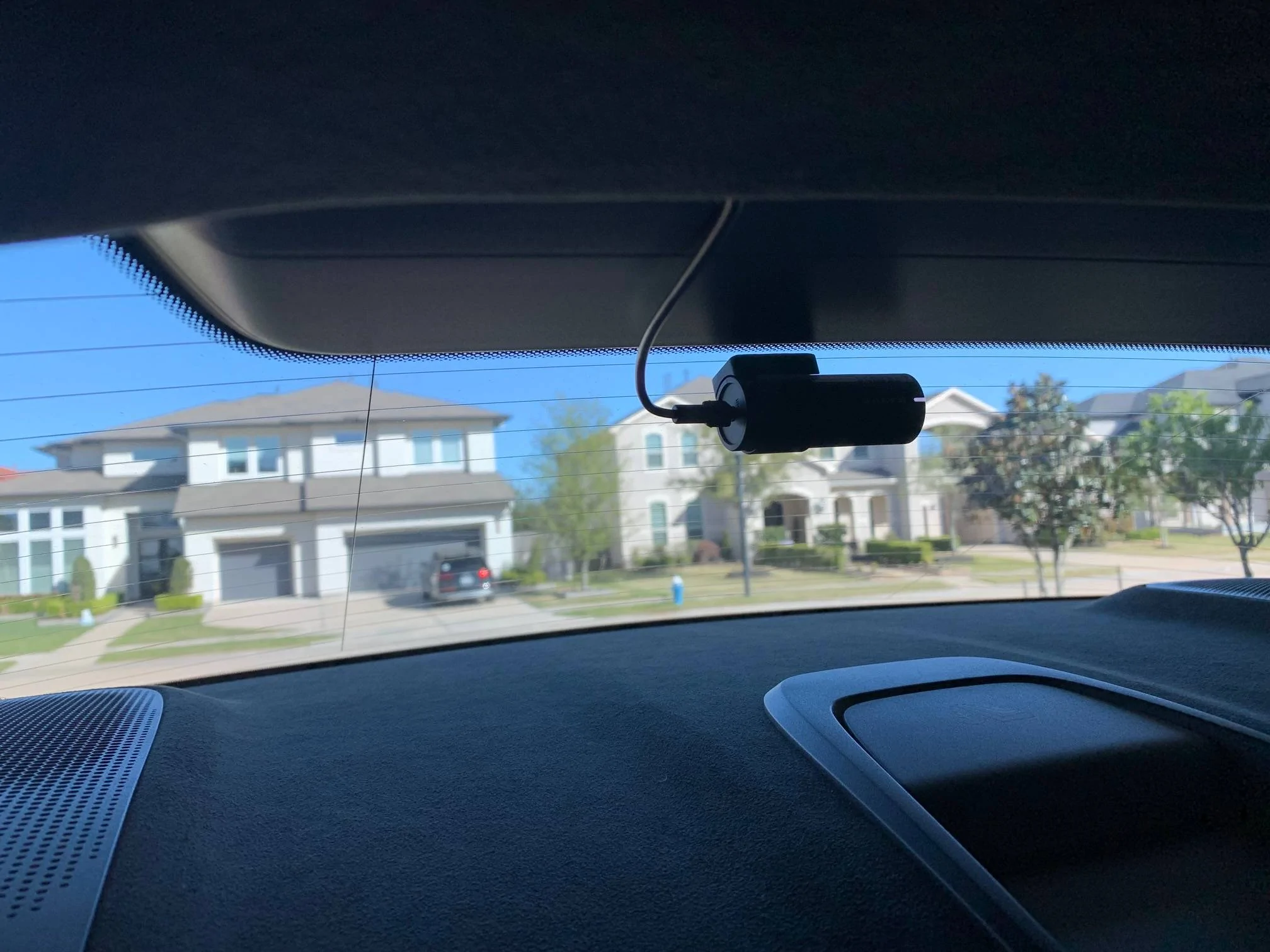

I've just completed installing a 4K Blackvue, and Escort radar using Blendmount and mirror tap. The pics on this site made the installation go much smoother. This is my fifth camera installation, and first on an EV. If any installer try to charge you extra because an EV is different than an ICE car to install, then tell them BS. There's absolutely no difference at all.
Install looks like mine, except I opted to offset my rear camera to the left in your picture. Tucks it out of the way and does not interfere with your view out the rear. I totally agree. Zero difference EV vs Ice. The fuse box looks just like any other car on the market.
That was my first thought, but when my wife and I took turns holding the camera while the other person sat in the driver’s seat, and it didn’t bother us. Moreover, when we checked the live view between the two spots we both preferred it in the middle so it doesn’t cut out the right part of view. I did the same for the front camera so it doesn’t cut out any view on the left of it. It meant the camera being lower on the dash and you see a couple inches of wires but that’s fine for a better viewing angle. To each his own really.
