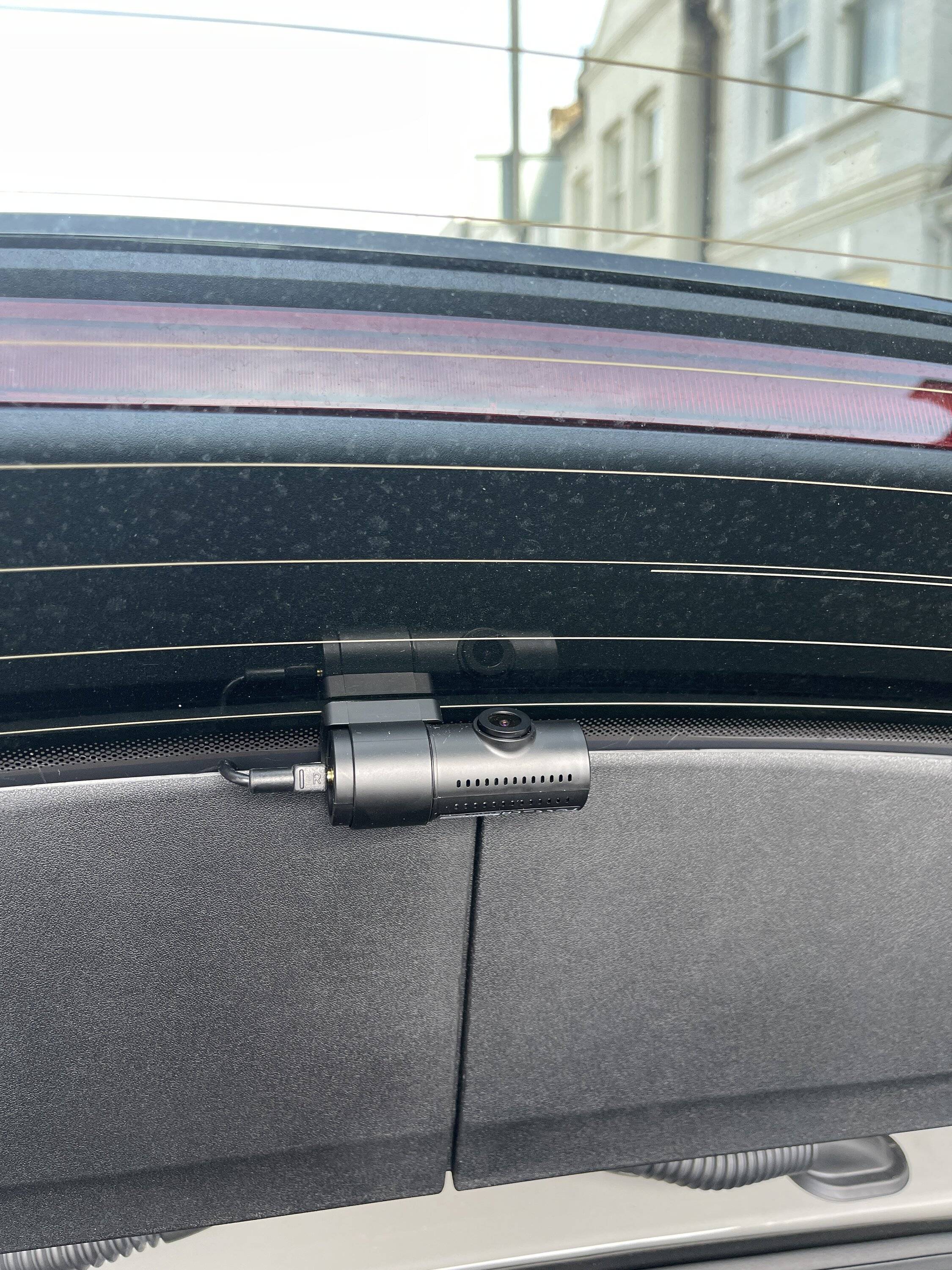

@Gnasher do you by any chance have picture of where rear cam is positioned ?
sorry for delay
here you go..
incidentally, checked the backup battery and it’s down to 24% as I’ve not driven in a week nearly. There is a lot of motion recording when parked though so it is still active.
no change to the range on car.

sorry for delay
here you go..
Thanks , I was thinking to buy a bit lower, but if it works all the way up, it is good to know

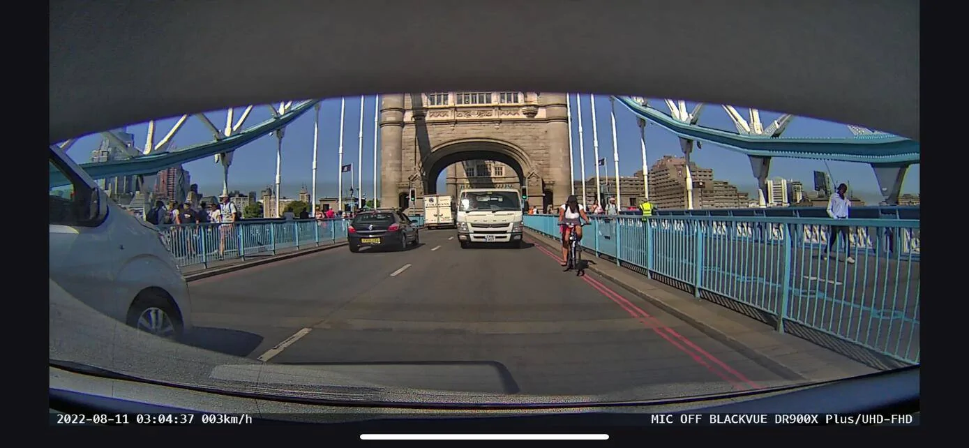

Here is the view from the back window with that camera position. Mine is a CT.
guess most important thing is to get widest angle.Also watch out for reflection.
