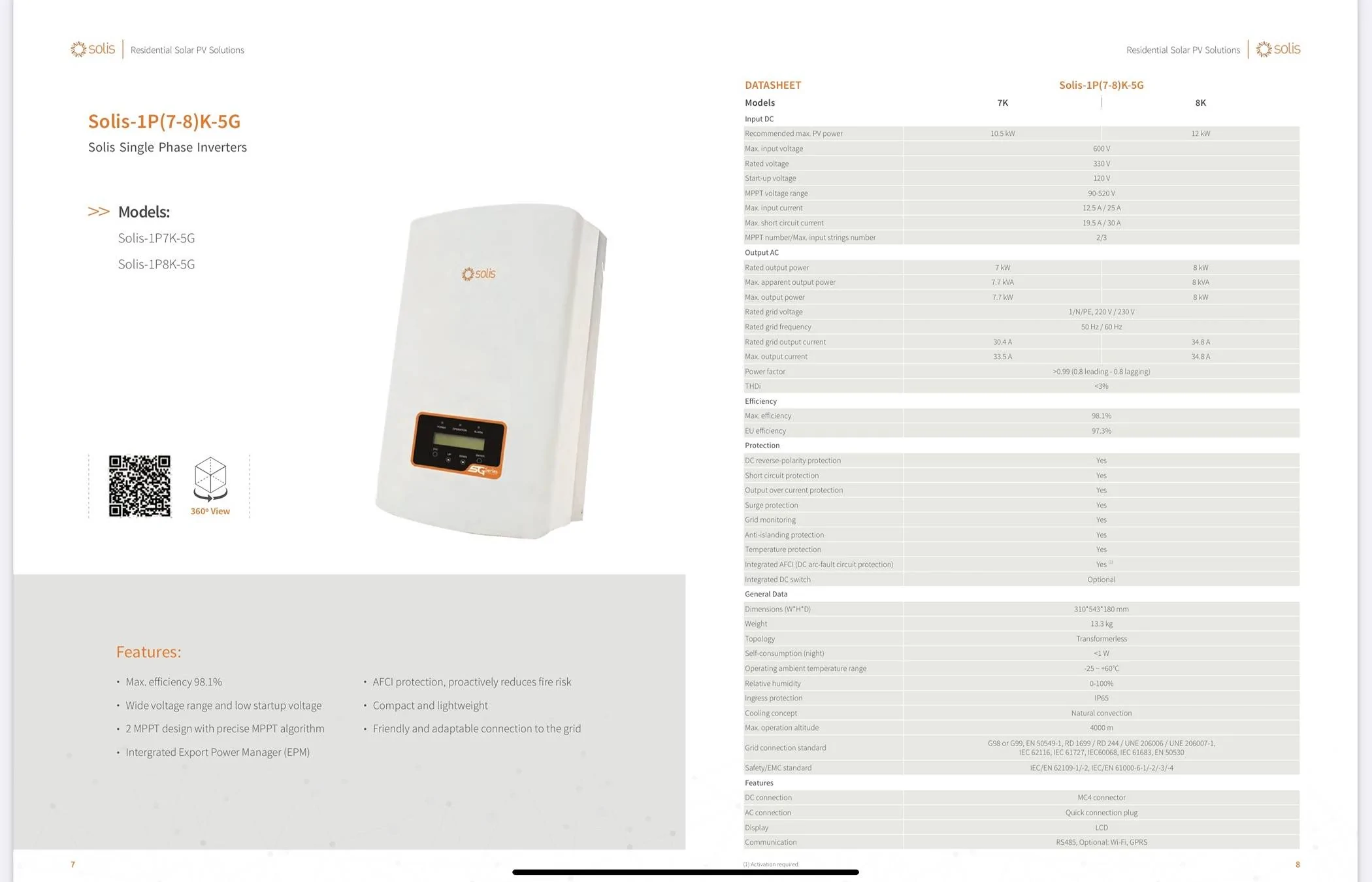

Just re read proposal, and does have an inverter still. I must have misunderstood what the installer said. The inverter does look more basic than previous one so is this saving money over original install comes?

It’s normal for an inverter to be undersized compared to peak output from panels, as you’d not miss out on much (only the highest peaks get clipped) and it’s generally more efficient to run smaller inverters if possible.
seems like a very very good price!
it still looks like a massive inverter. 7kW?
If so, you must have a very friendly DNO, as you’d need an export allowance of 12kW (7kW from solar and 5kW from PW).

The inverter quoted is the 8kw one so bigger. DNO came back with cap of 7kw. Does this mean the inverter gets capped or the powerwall gets capped? And any negatives if it’s the PW?
panels peak is 7.74kw

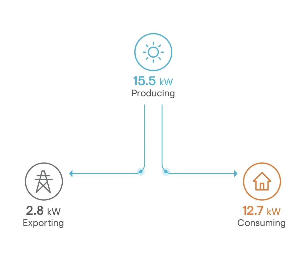

It is amazing that you can have enough energy with so small system as the overcast is pretty high in the UK.
Yesterday we produced 132 kw.
Here is a snapshot as I’m changing the lightning directly from the Solar system.
