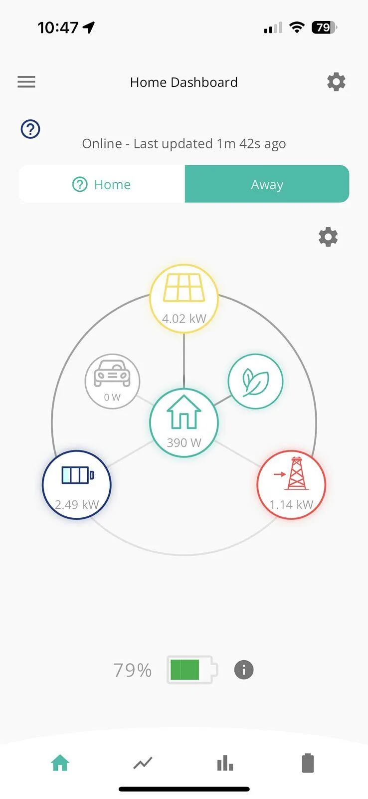

Here we are right now - dumping in to the grid despite the batteries not being fully charged, due to the inverter maxing out at 2.49kw in to the batteries. Frustrating!
when you say ‘dumping into grid’ are you getting paid by an export tariff?
we are yeh, I think we get 11p per kw for export so it’s not wasted, and in actual fact it’s better to charge the car at 7p from the grid and export the excess solar, but in an ideal world we’d be able to store more in batteries
