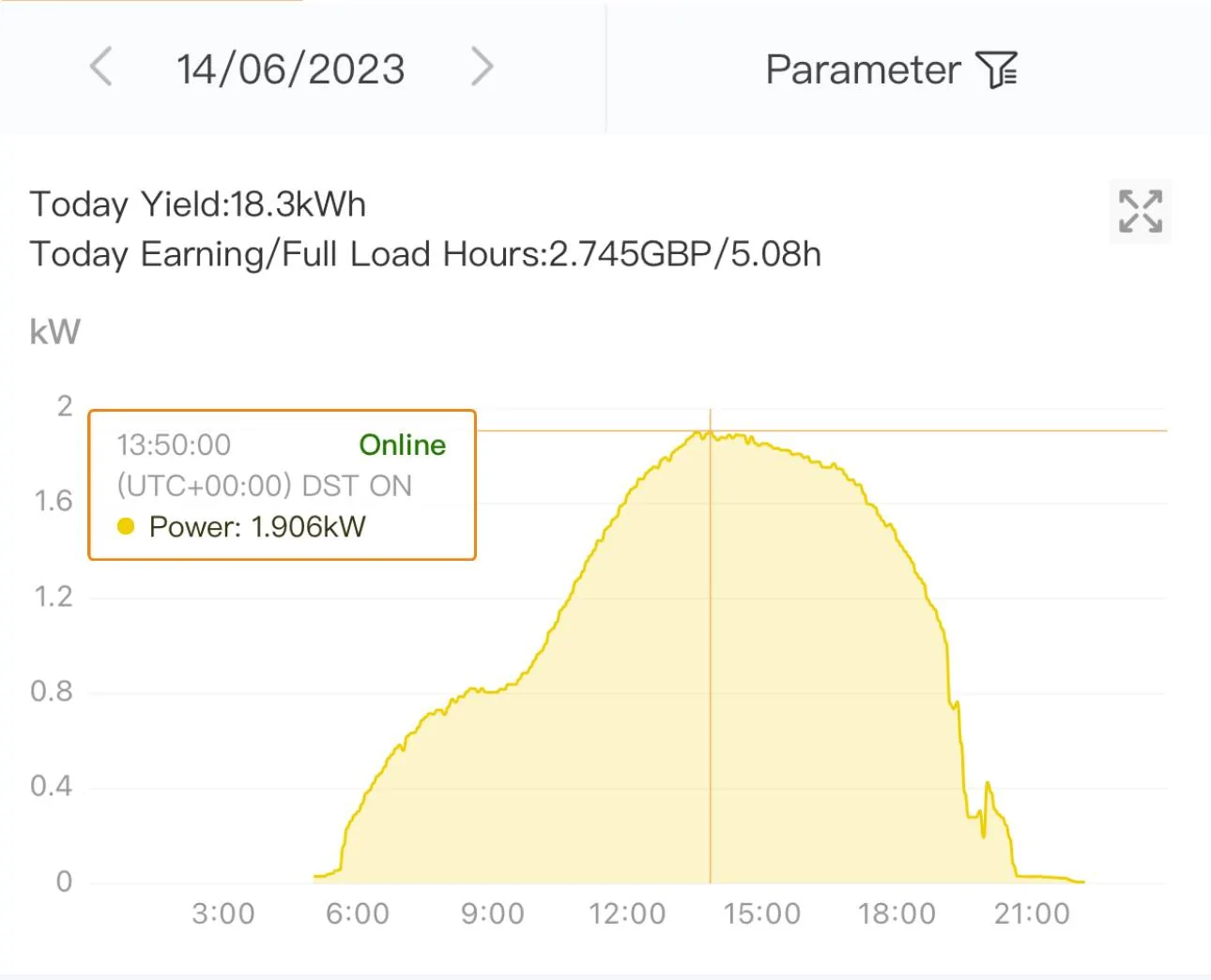

I moved into a new build which has solar installed but on a split East/West array.. have to say having a south facing roof will make a big difference!
12 panels (4 east/8 west) and a 3.6kWh Solis inverter and then added 10kWh myEnergi Libbi battery and a zappi last autumn. decided on keeping the battery and EVSE the same brand to make sure they play ball nicely (and in an easy way!). read a few posts where people struggle to stop the batteries discharging into the car. Having it all as myenergi products means it was a simple tick box in the app to stop the Libbi discharging to zappi.. Also having one app to manage it all makes life easier. Was only able to monitor generation from May last year and it was June which was the best month for generation for me. I get a peak generation of ~2kWh and about 18kWh generated through the day.

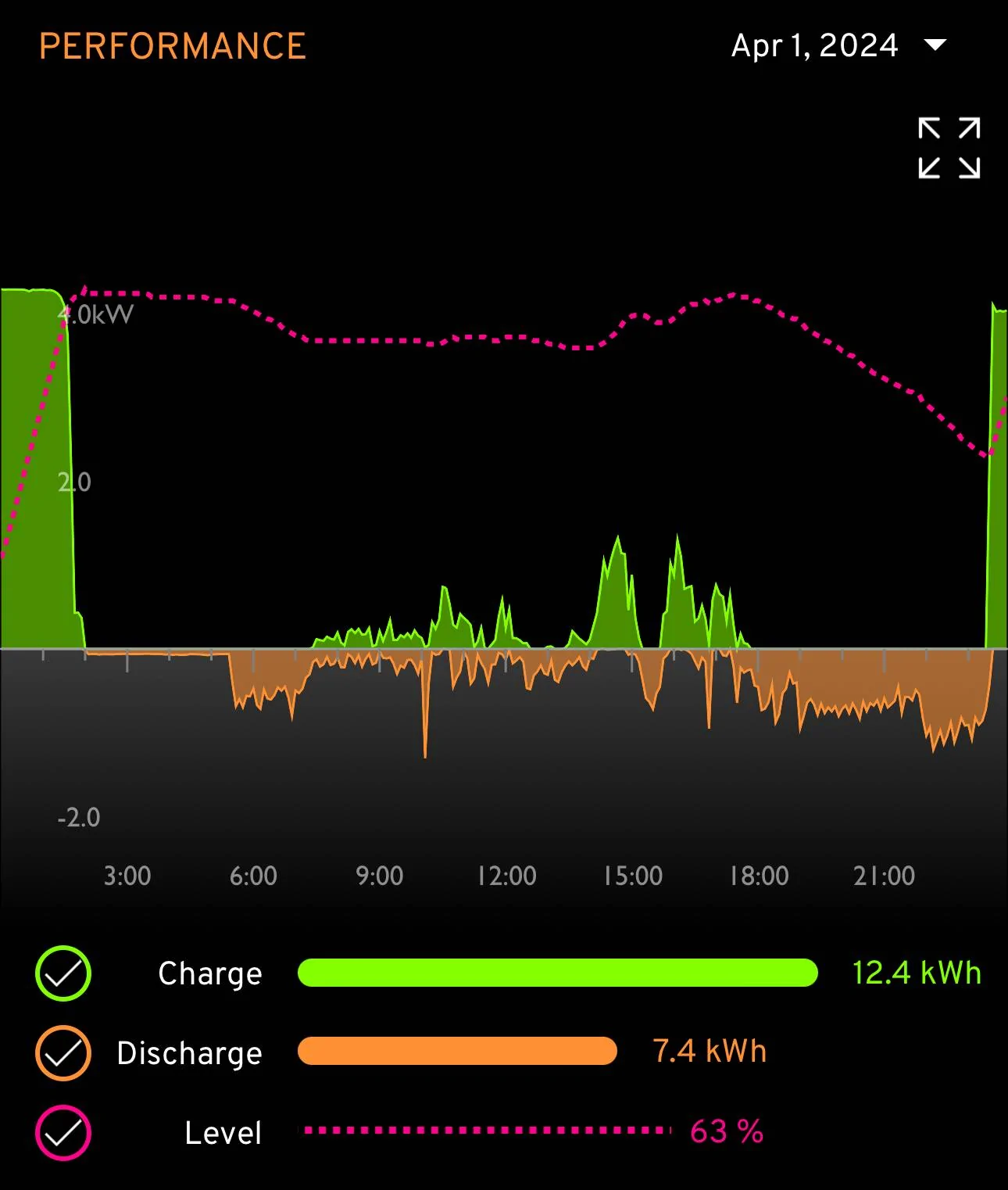

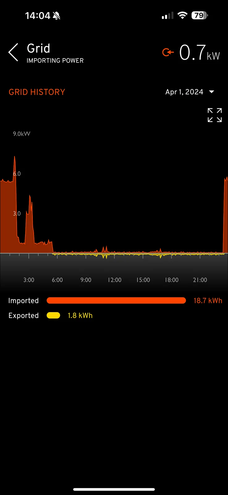

Filled battery, ran washing machine, dishwasher between 00:00-5:30 - imported ~19kWh.
ran house the rest of the day from battery, with solar topping up now and again (generated 9kwh).
battery went down to 80% until early afternoon where the solar topped it back up... by the end of the day it was down to 50% so the next day fill was less too! no other import in the day.
Porsche Taycan Solar install, batteries, exporting and ev tariffs IMG_0873
cost £1.88 for the day and get 30p for the 2kWh exported :D (this is without me charging the car)

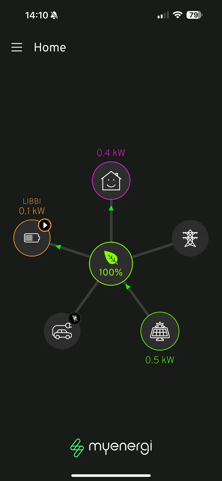

Porsche Taycan Solar install, batteries, exporting and ev tariffs IMG_0874
OI has made the biggest different in cost.. Octopus is also good for paying out during saving sessions (reduce usage for 30mins/1hour) if you have batteries, you can 'dump' energy to the grid and get paid anywhere from £1.25/kWh up to a session where they even paid £2.50/kWh!..

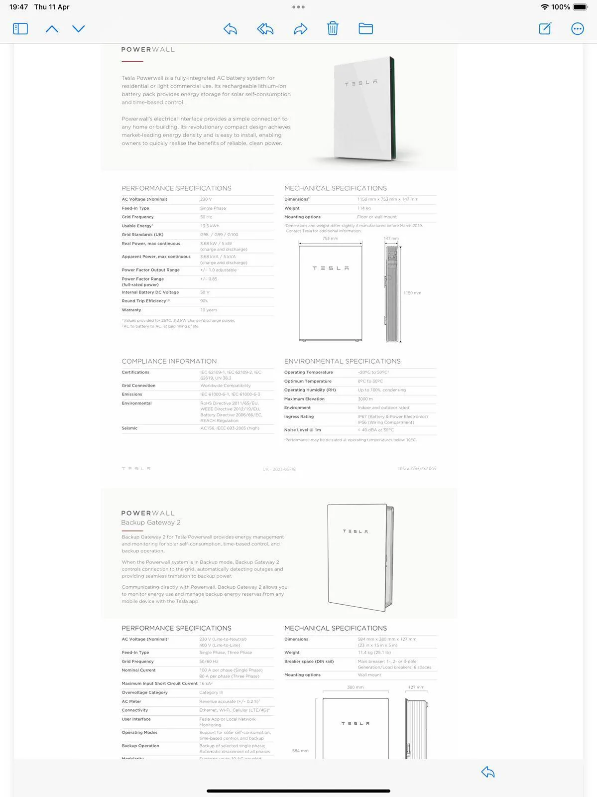

So, chatted through back battery options with installer yesterday, and we have a new twist….
Tesla Powerwall 2 option added to the mix!
They have just become an Tesla approved installer, and when we were discussing the battery back up options TPW was suggested as may not be that more expensive. To get current system to have battery back up was £6-800 more on my basic quote of 13050. So let say 13750 if we split the difference.
Had a new quote for the 18 panels and TpW 2 for £14480 so under £750 more for the Tesla battery pack and also has 13.5kw storage instead of my original 11.6kw battery storage.
I’m thinking it’s a no brainer, and am a bit more excited about the Tesla pw2…
Any differing views or am I making the right option paying a bit more for the Tesla battery?

Powerwall 2 is amazing. I love mine. It very cleverly optimises how it charges to ensure you just have enough battery to see you through, yet leave room for charging from solar if it predicts the weather will be good.
We've found the most reliable weather forecast for the day ahead is how much the PW charged up overnight! Definitely worth if you are on a low rate tariff overnight.
Only downside is that its AC coupled, so cant soak up any lost excess, where your panels are generating more than your inverter can convert.
