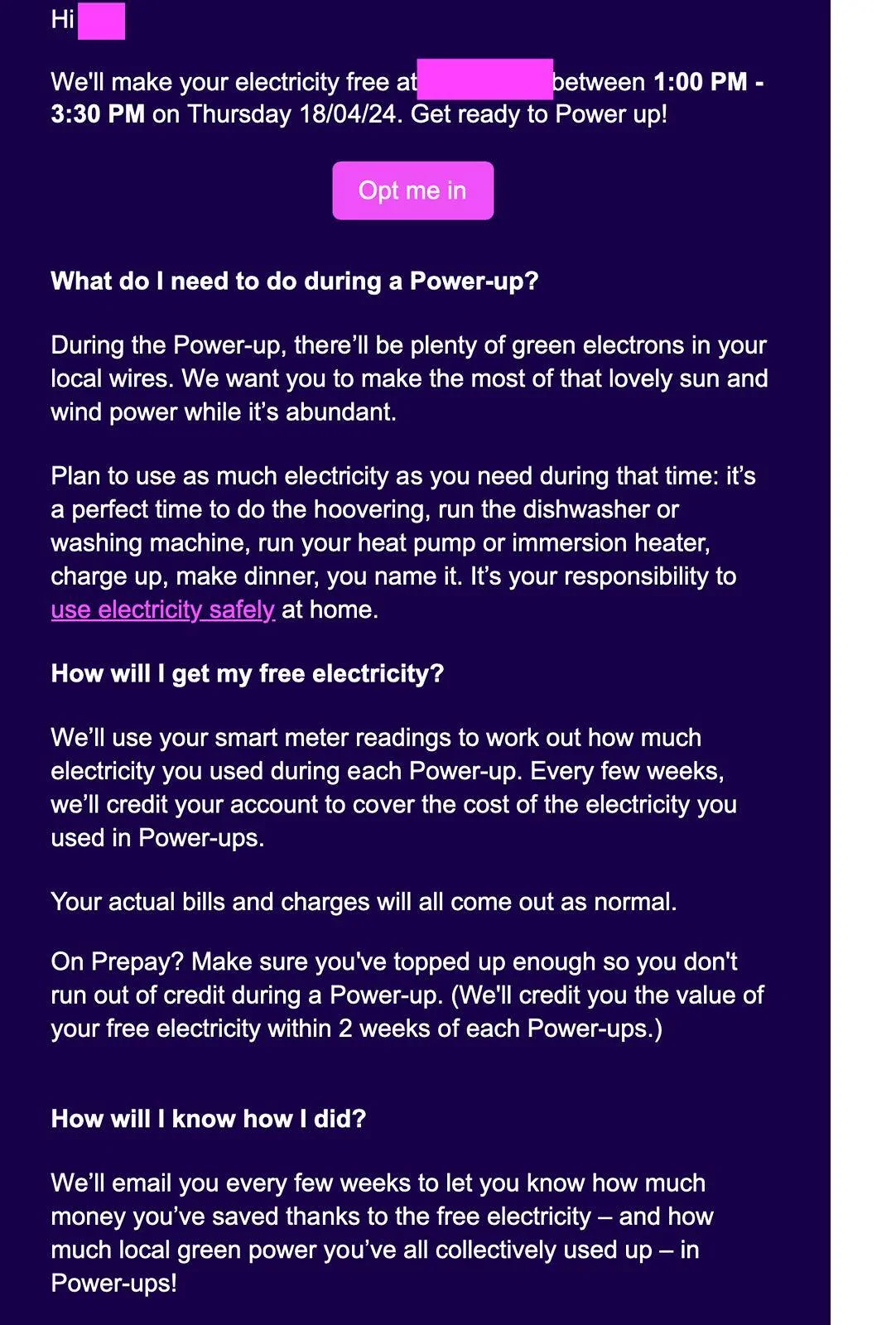

Yes that's the thing, Power-Ups. I think you're right that it is region specific but thought that was for specific events rather than an overall availability.
Corkage Time
Jan 31, 2024
Taycan ST
Here's an example of the email notification that Octopus send:

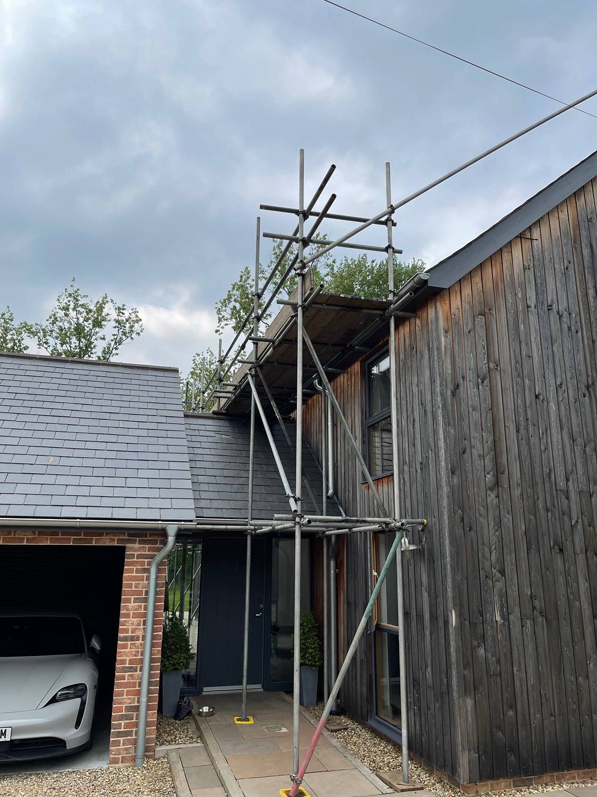

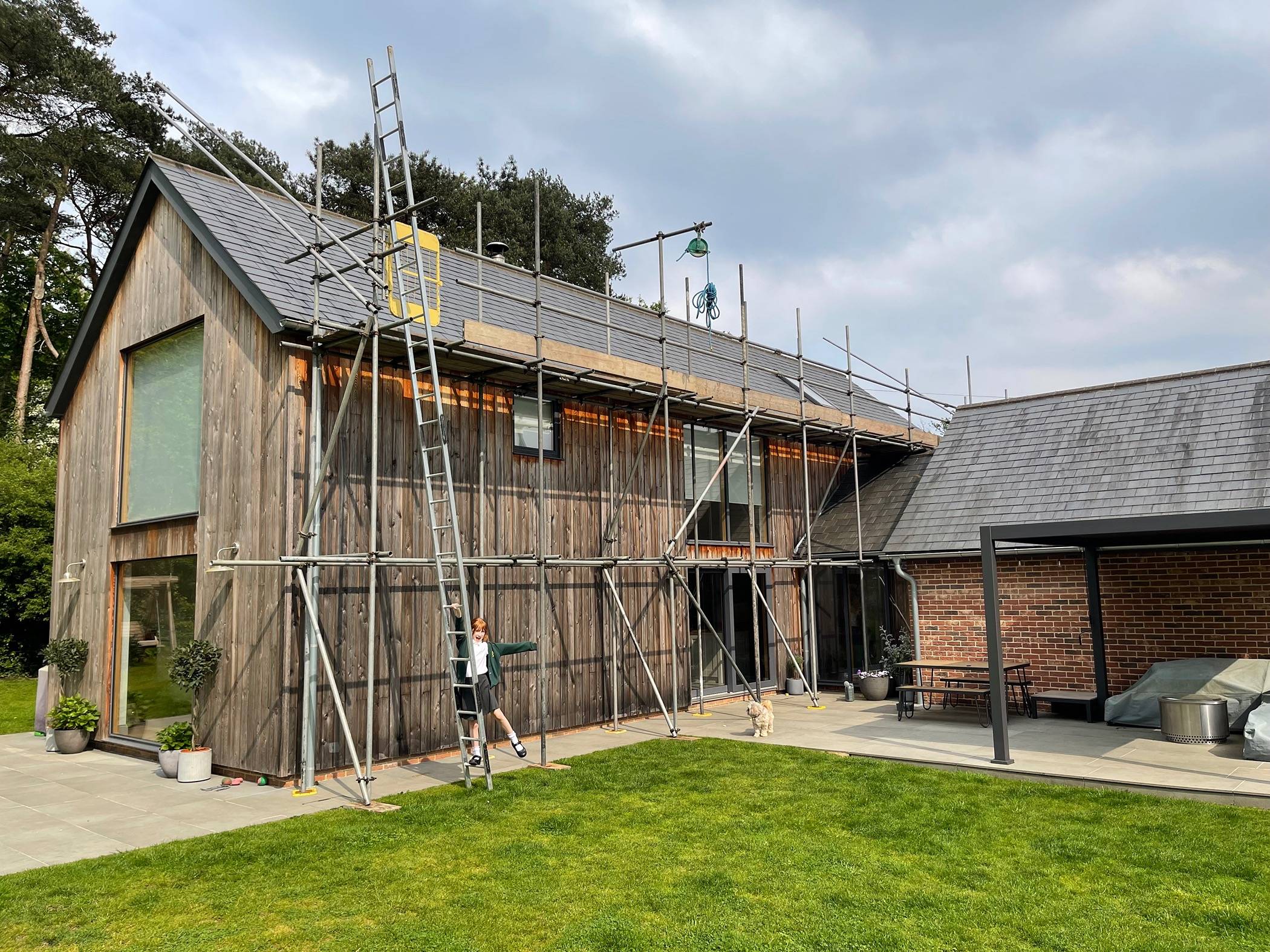

Scaffolding up! Tiles being stripped and prepped Saturday and Sunday as having the panels inset into roof. Install of system starts Tuesday.

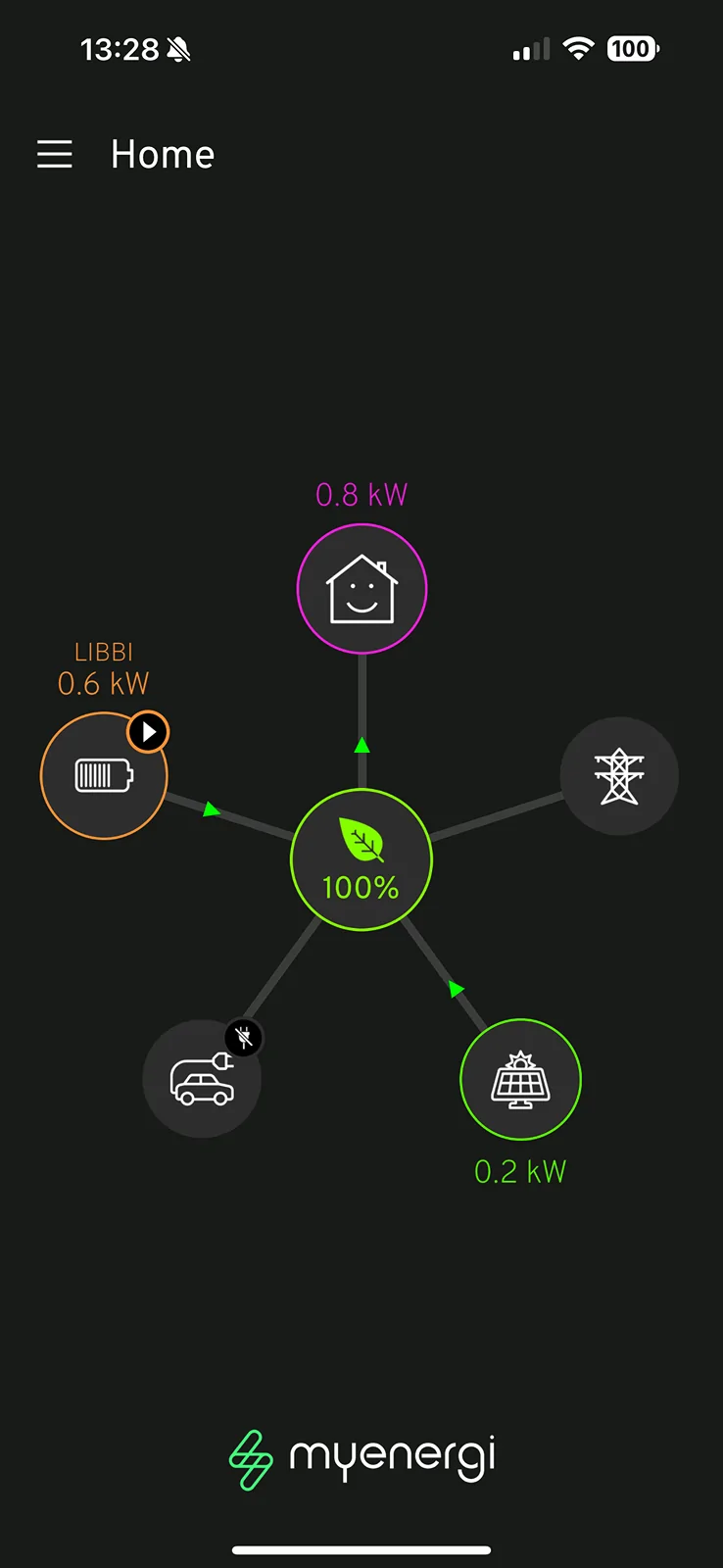

I might be wrong here but I don’t think a CT clamp from a Zappi will work on the PV live wire as that would be DC. CT clamps work on AC. The Zappi will calculate the PV figure from house use and grid return but if there is a battery it can’t “see” that separately.
Sorry it’s the live from inverter (to consumer unit) so AC. Can be wired into zappi or wirelessly (if the run is awkward). In the set up of zappi mark that input as generation as you’ll see a separate source in the myenergi app.
Just clouded over here:
Porsche Taycan Solar install, batteries, exporting and ev tariffs IMG_1053
the reading from the ct clap to what the data from the inverter shows directly is pretty accurate… myenergi data about 100w off
I prefer having everything on a single app rather than switching to the solis one..
It will work on that wire. I see your battery is a Libbi- so that will commicate with the other MyEnergi kit. Mine doesn’t as it is a different make, but communicates with my inverter.
If I was starting from scratch I would probably try to get it all the same make but I think the MyEnergi stuff is more expensive for reasons that aren’t entirely clear to me.
