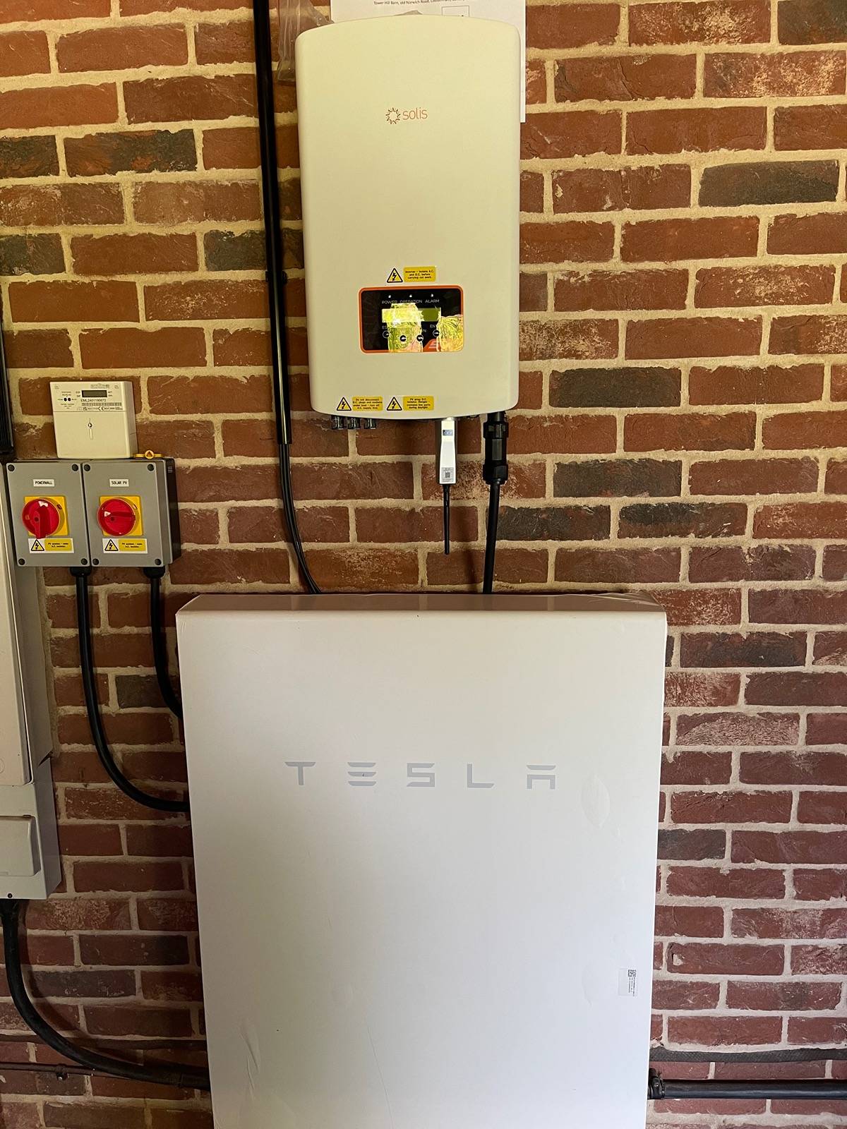

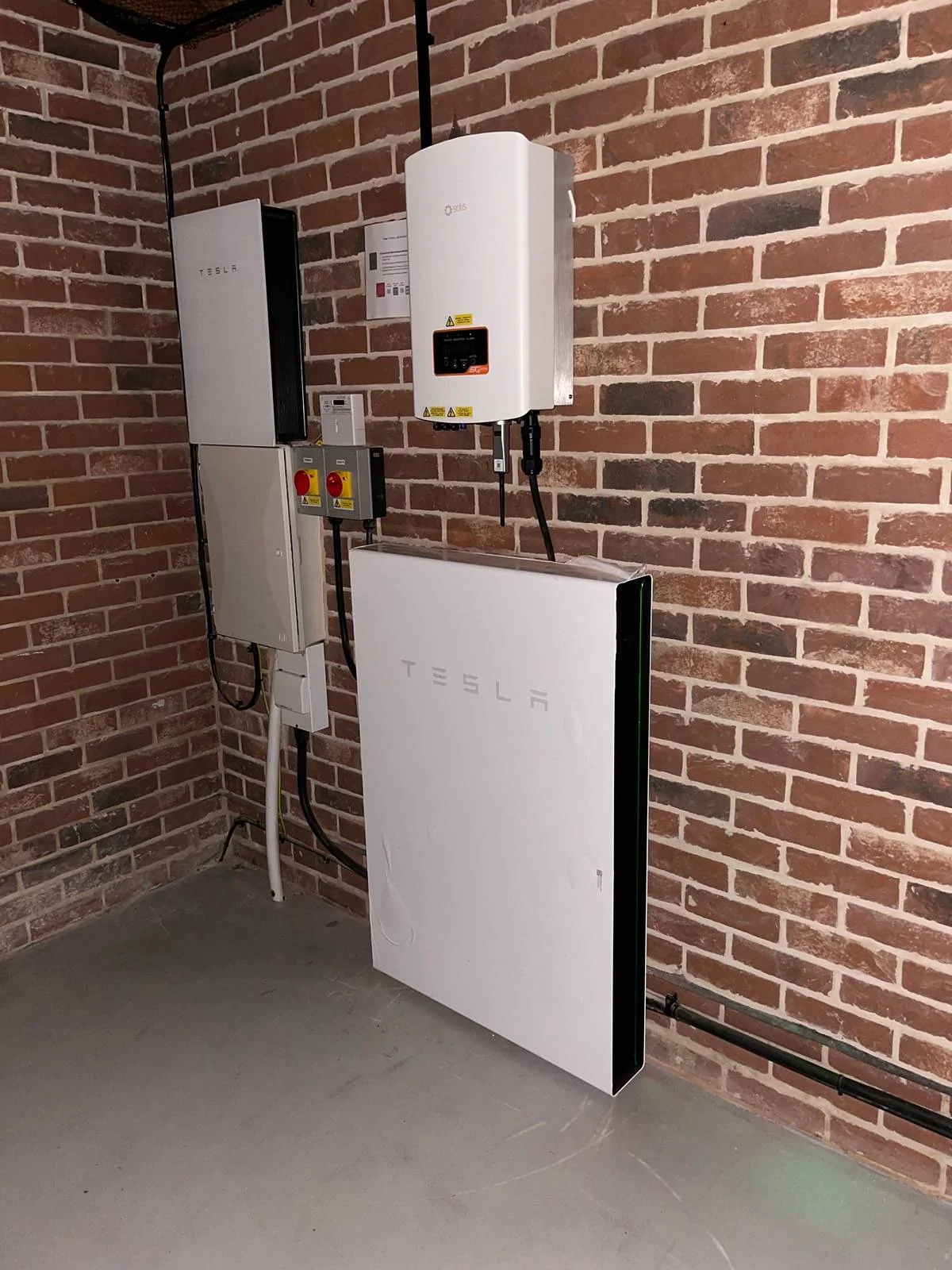

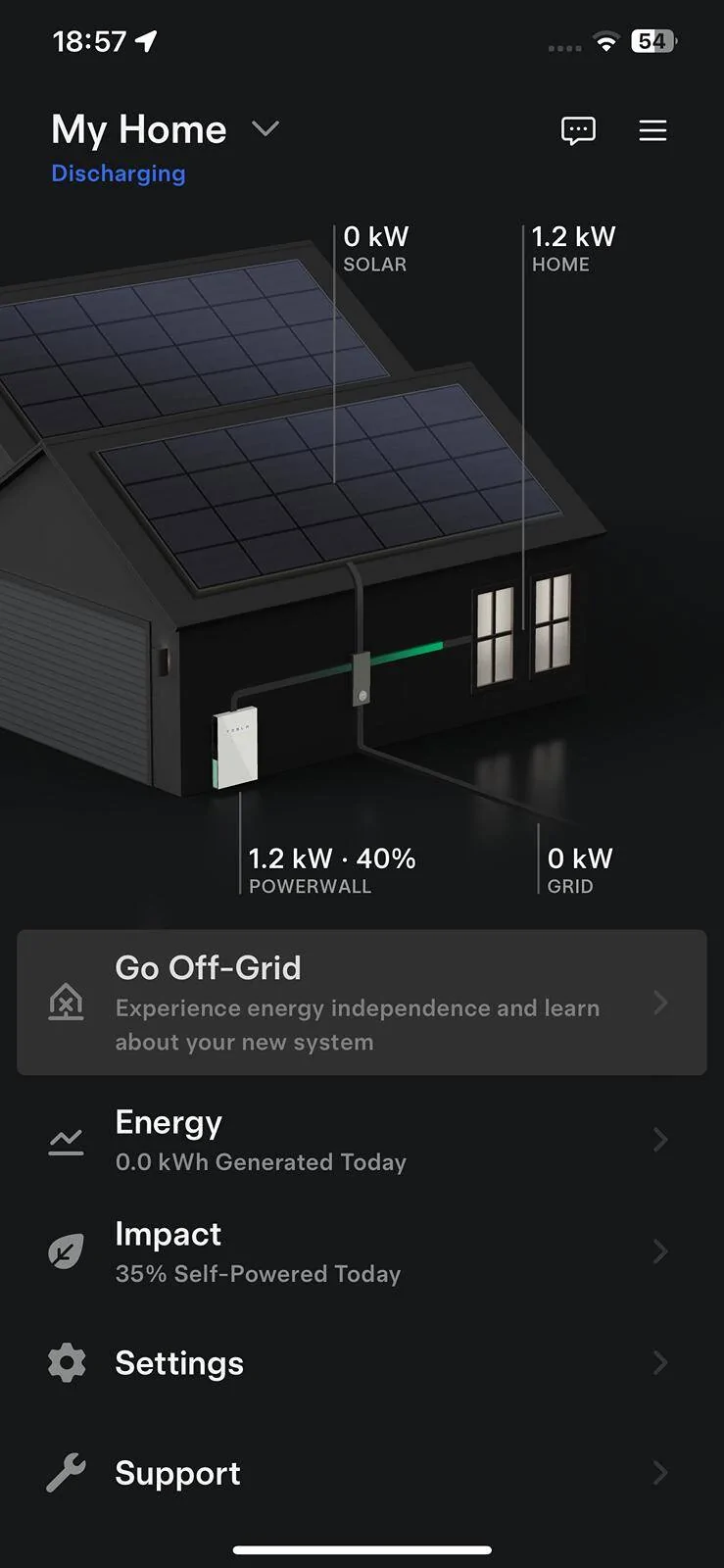

Powerwall installed and working. Solar panels, well…roof guy decided the ‘in roof’ proposal wouldn’t fit, so didn’t strip roof on planned day. After some discussion now they will but possibly without a tile trim at bottom which after reviewing internet pics I’m ok with and in some cases look better ( still in roof, flush, but panels run to gutter). We are away next week in France, the perfect week to me to do the panels but the missus is adamant this won’t happen as doesn’t want people working on house whilst away. Madness imo but given up arguing, so solar delayed by a week until we are back.
Today charged powerwall at 7.5p overnight and ran house of it all day including the temporary air con unit ( as well as hybrid/ ev/ hot water). Should use the 13kw capacity today with the air con on, so 13kw at 7.5p vs 28p is £2.60 saved today. Doesn’t sound much but extrapolated out over the year is £950 yearly saving at current electric rates, so happy with that. Solar when up and running will obviously make this saving more.

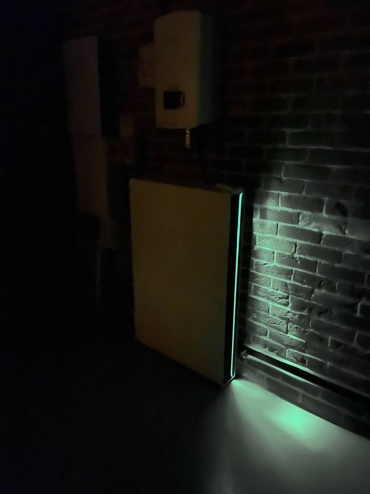

Plastic protective coverings still on PW and gateway. Love a green glow…
