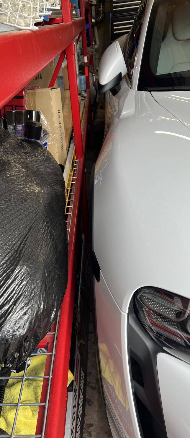

Yea, RAS does make it impossible for me to park the Taycan as tightly as I used to park a Model S, which is almost the same size, but no RAS. It also requires very shallow angle approach. This is as close as I can get (there is a "lip" in front of the Taycan, so I cannot just pull in/out straight). You can see the rear is not as close as the front, as the back swings out when I pull the front closer to the side. Side note, all of Taycan's electronic parking aids (cameras, 3D view, ultrasonic sensors) are completely useless for parking within less than a foot of any obstacles.

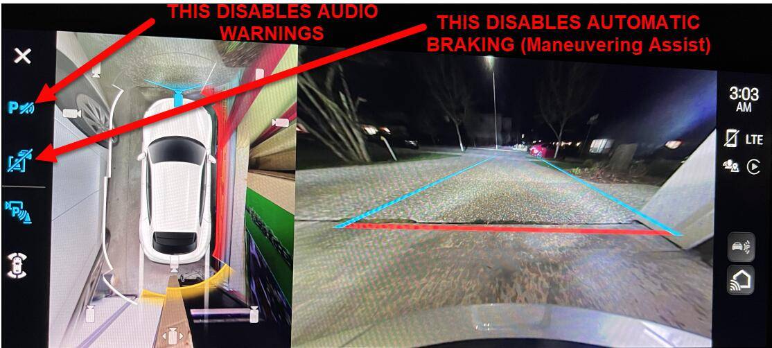

Do you have to wear ear plugs to park? I can’t imagine all the sensor beeps and shits that instead of warning you annoys the hell out of you while parking.
There is a mute button on the screen while the parking assistant is active. As someone with a similar garage situation (prompting me to start this thread), I am very familiar with the mute button.
and few times the car would just brake hard by itself to “avoid” a crash, which freaked me out.
The same screen has a button to deactivate the automatic braking, too.

Do you have to wear ear plugs to park? I can’t imagine all the sensor beeps and shits that instead of warning you annoys the hell out of you while parking. Also, I have not even came to that close to my garage door and few times the car would just brake hard by itself to “avoid” a crash, which freaked me out. It’s ridiculous.
Two very helpful buttons:
Porsche Taycan Disable Rear Axle Steering? 1683009141844
Also, if you forget and the car does automatically brake, pressing hard on the accelerator to get it going again is not a great idea is such closed quarters - workarounds are put it in park and back in reverse, or in drive and then back in reverse. Tesla has a better solution for when HOLD is engaged, simply pressing on the brake pedal again releases the hold, but Taycan isn't there yet. On the way out of the garage, car starts with auto-braking disabled since it thinks it's already touching the wall on startup, but the noise is still there until I mute it.

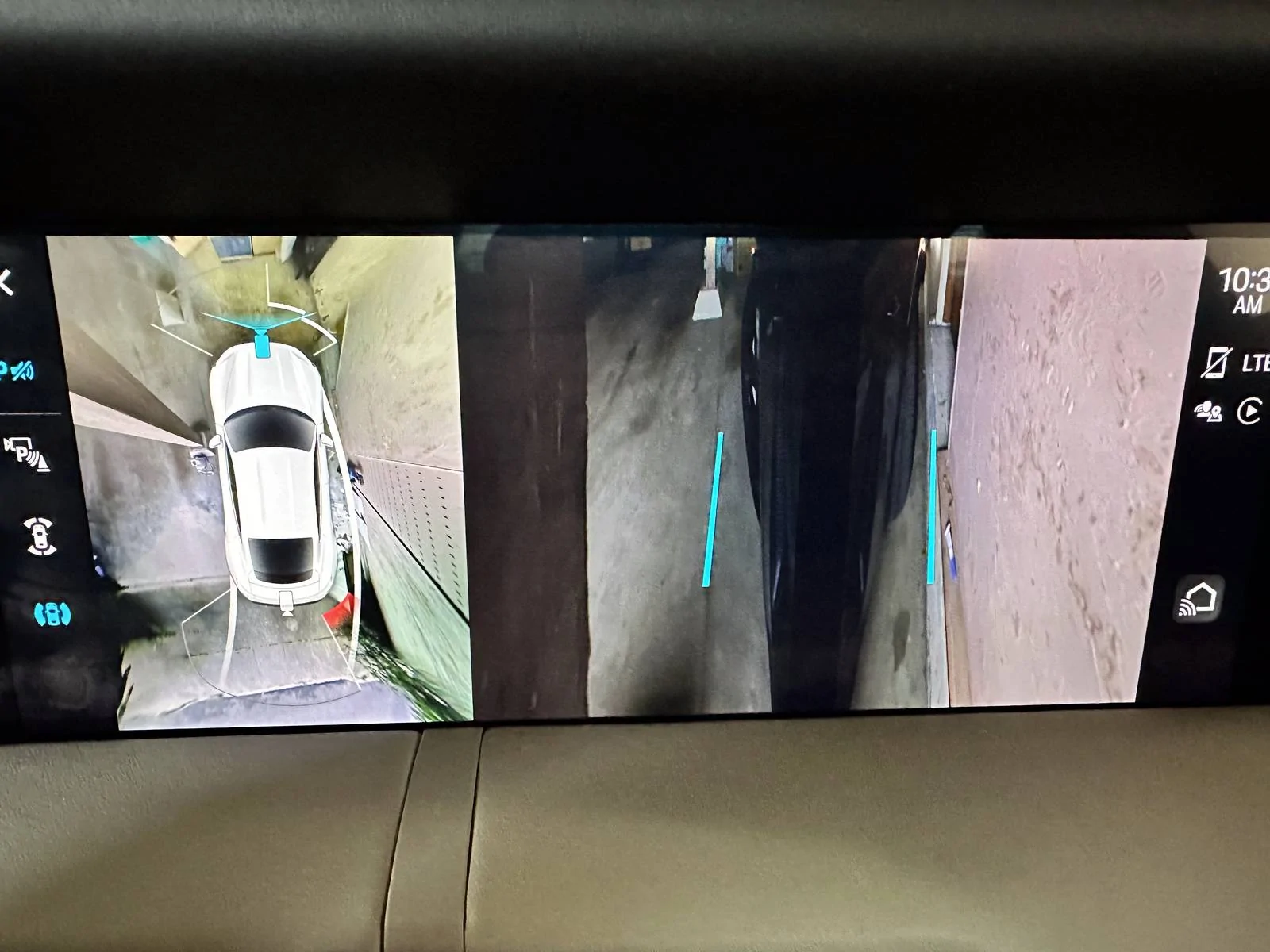

Tried the “side” view, and can confirm it’s useful for narrow spaces where the problem is not front and back clearance (as parallel parking would have), but clearance to the sides of the car (as in my garage).
Here’s a photo. Probably difficult to make out without movement, but what you see on the right half of the screen is the sides of my (black) Taycan. On the right especially you can see the “curb” of my garage, and how close the tire is to it. On the left of the “squished” car you can see one of the pillars, the other problem of my garage.
The light blue lines likely account for mirror width (I don’t have power folding mirrors unfortunately).
This all makes sense, and again, is much more useful in narrow spaces instead of the front/back cameras.
Sadly this view is only available if you didn't spec parking assist/3D view.
