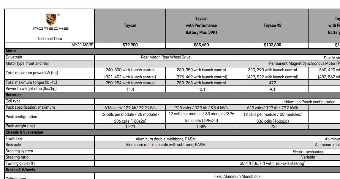

From Porsche themselves. :)
my link from porsche and this technical data sheet conflict by 20 cm . According to your sheet turning circle is reduced 80 cm where Porsche link is 60 cm . But thanks anyway .
BeTay22
Sep 7, 2020
2007 BMW X5 while waiting for more high-power chargers
No, it's not from that post.
Sorry, I was not clear: your document and Ron's both come from Porsche, but the turning circle is different! Yours says 38.4 ft / 36.7 ft but Ron's says 36.7 ft / 34.1 ft. I can't believe MY20 and MY21 would be different. That's what I meant with :eek:, but I guess boomers shouldn't use emoji. ;-)
