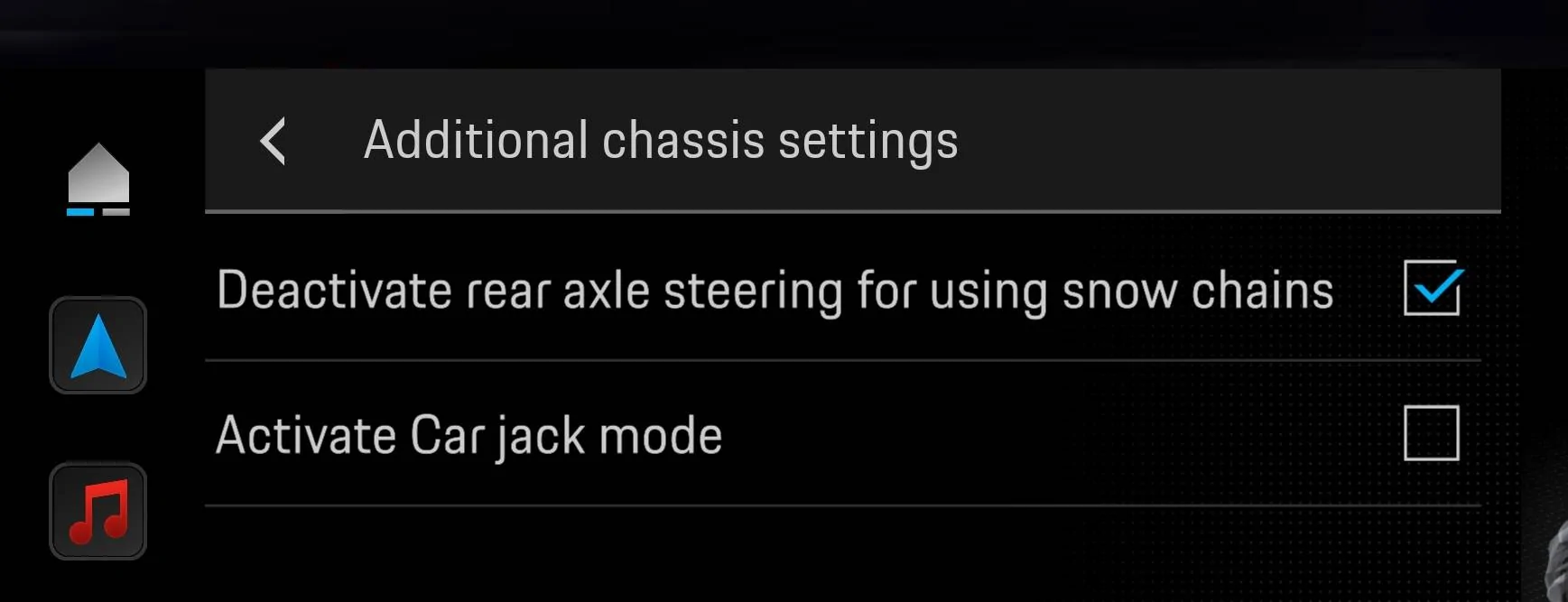

from the manual i have (pdf 2022):
Vehicles with rear axle steering: Deactivate rear
axle steering.
– e Setting
Porsche Taycan Disable Rear Axle Steering? 1682970513200
e Vehicle settings e Addi-
e Observe the different national regulations re- garding maximum speeds.
well, that pasted for sh*t. in english:
Setting > Vehicle Settings > Additional Chassis settings
FWIW.
edit: ninja'd above.. but, maybe still helpful.?

Luckily you guys have an obsessed member with an accute case of Taycanitis who spends his day playing with the pcm simulator.
This should fix the issue? Specially if assigned to the steering wheel button?
sorry but that option is not available in the US.

That's funny because the latest online manual (in the myporsche app) doesn't mention RAS at all. I searched and searched and couldn't find it. I did find the same texts you quoted.
I think it is country specific - doesn't appear on my GTS nor did it appear on my 4S (both have / had RAS).
I used the GB Version of the pcm simulator. Not sure how accurate the simulator is though. I don't get a list of tire sizes in it, for example.

Might it be that the option to disable RAS for snow chains only appears when other PCM settings (e.g. tyre/wheel size) are compatible with chains?
If this option is always in the same menu as Jack Mode (in Additional Chassis Settings), I can confirm that it doesn't appear on my Turbo CT even if I have the R20 Winter Tires selected, since I swapped them recently to all-seasons for the summer and when doing so had to activate jack mode. When I was doing this, I remember thinking to myself - with only a single option in this sub-menu, why does it have to be a sub-menu?

I think we know we're the option is intended to be but as mentioned above it is region specific at best. Not available on UK, US, other regions.
