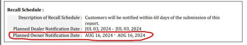

I just got my brake recall notification letter which says wait for follow up communication from Porsche before contacting dealer.
