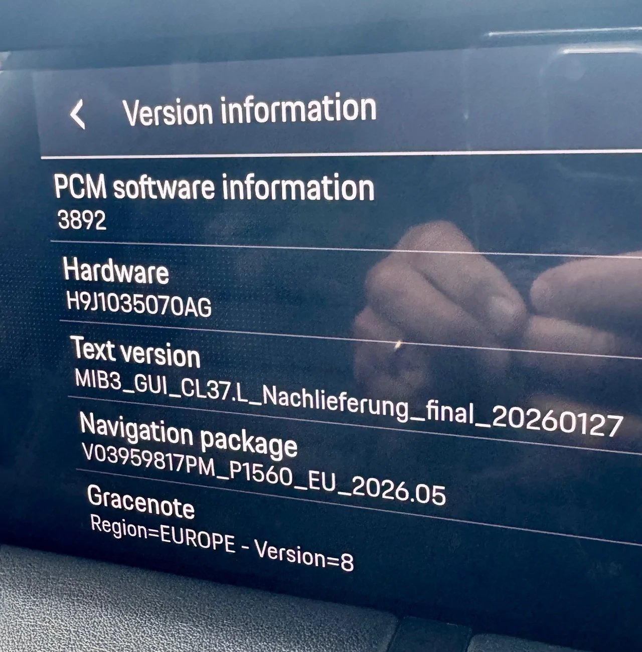

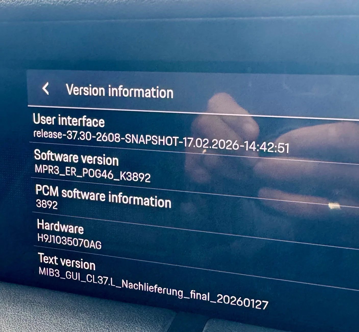

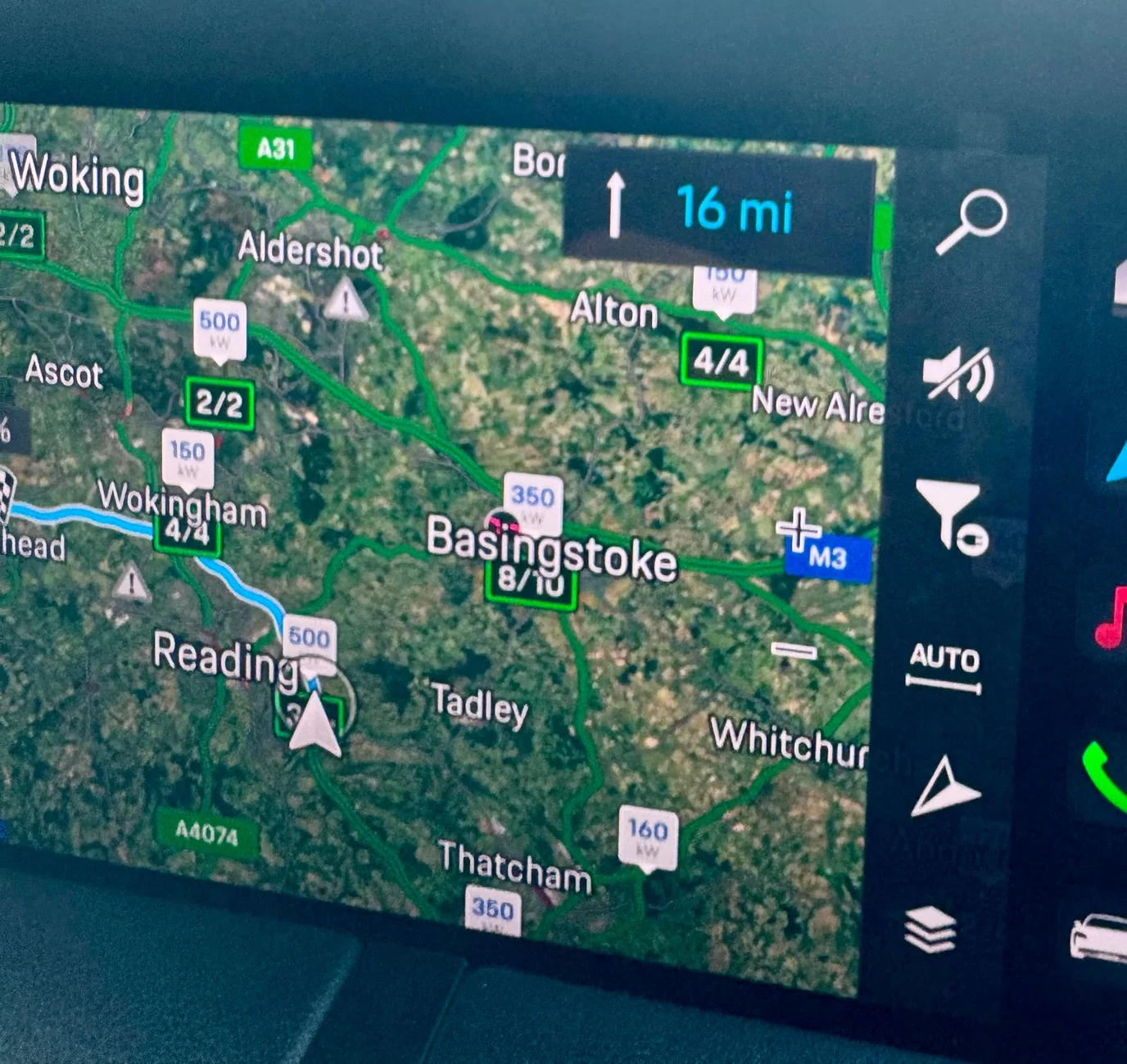

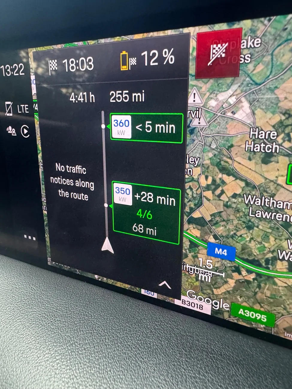

WTG1 done @Jasper4S, 4 hours rather than the 3 as a failed update at the end had to be repeated. No nav restarts on the 30 mins drive home (had 3 on the way there). See the photos for software versions and the only visual difference I’ve seen so far, charger power on the map and a filter for what power chargers you see.

Assuming you’re still close to your car, can you try to make a longer route, say to south Italy? How long does it take for it to get calculated?
On j1.2 route planner, a lot of the workload is offloaded to sever side, instead of being done locally ( Same as with the app) like it was done on j1.1.
We seem to be getting the j1.2 navigation, fully. Wonder if it included the offloading to server side for route planning.
Another interesting test is if the route sent from the app still gets recalculated once it makes it to the car.

I will @chun (test route load for the north of England was pretty quick)
Route to Palermo took around a minute would take longer calculating alternative routes. Route sent from app does show as “calculating route” momentarily but touching start route gets it loaded.
Obviously not extensive test, but happy with how it’s behaving so far.

Question. How do you get to this screen with the version? I just cannot find it!

Those sound like map updates. It’s a one-time notification and loads in new roads and new images for satellite view.
To see current version, go to "instellingen" scroll down to "systeem" and click "software-informatie" and then "versie-informatie"
