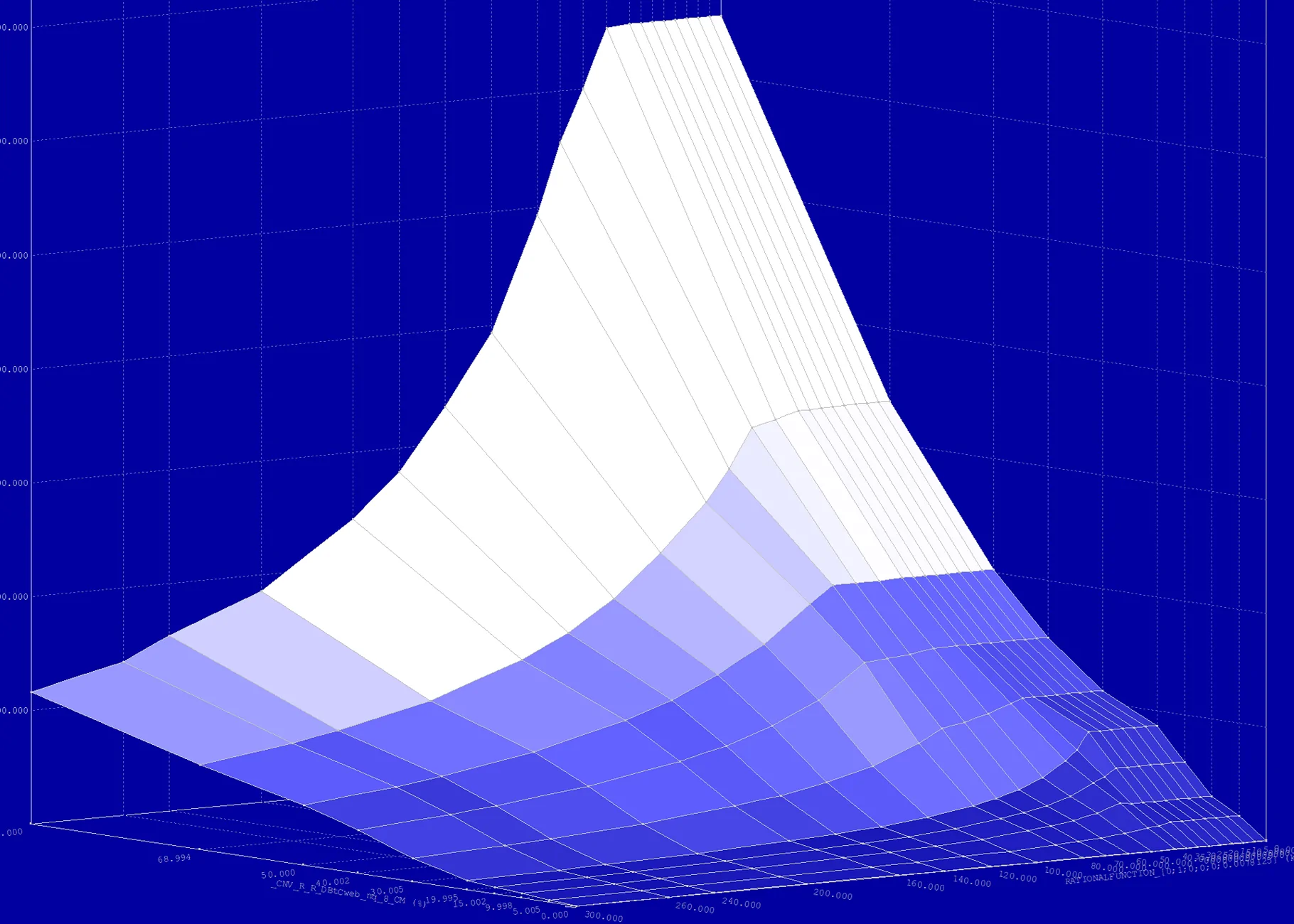

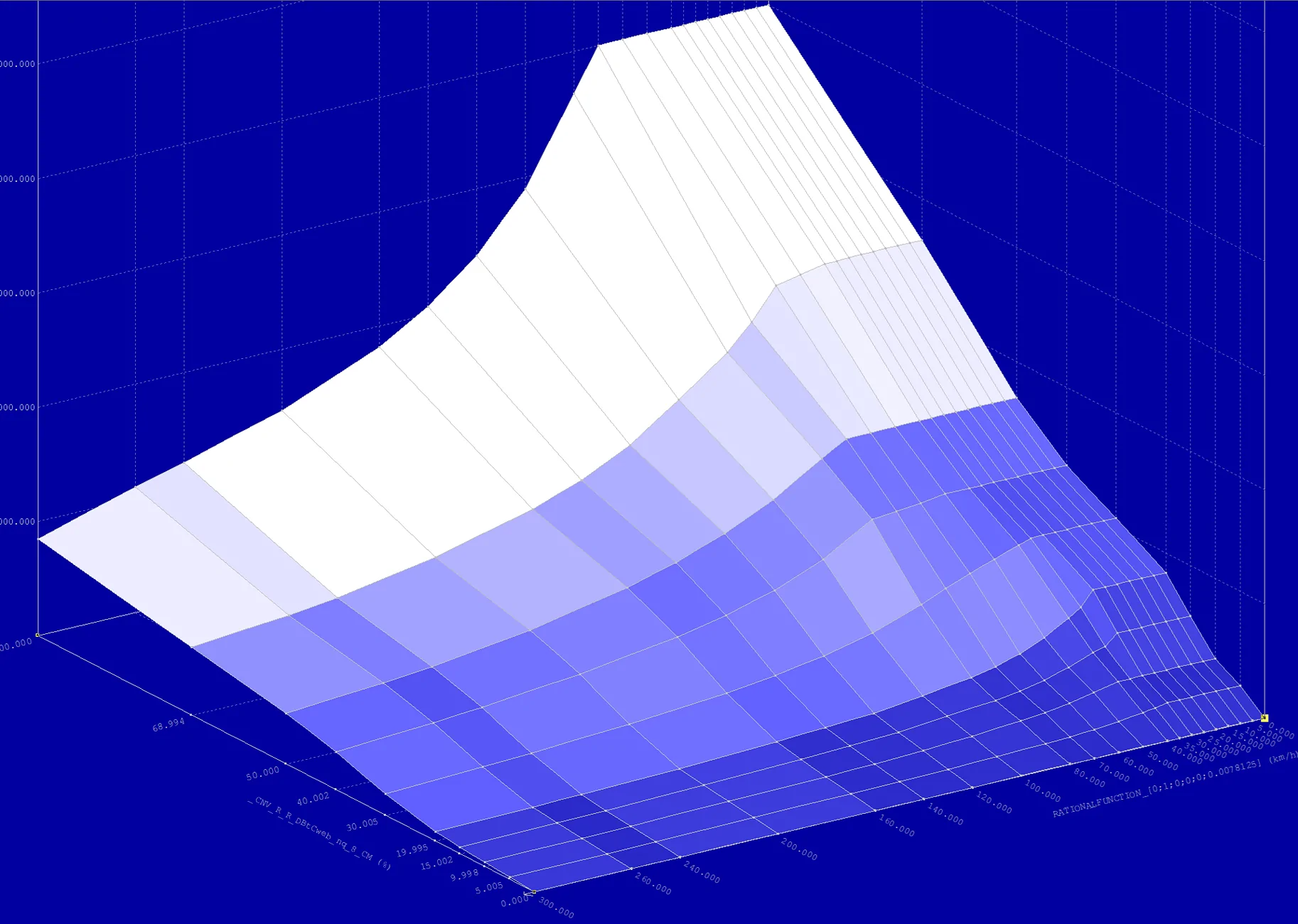

1. Drive it in Sport. Half of what you guys are describing is probably the gearbox shifting 2->1. Drive it at least in sport to avoid that.
2. I did change the throttle curve on my FL Taycan 4 to match the Turbo S, because it felt sluggish otherwise at the lower end. By default none of our tunes do that, we just extrapolate it up, as changing the default feel of the car is not the best thing to do.
3. The throttle maps are not linear by any stretch of the imagination. They all have the low speed boost that any car has. This is the J1.1 4S:
Porsche Taycan EV throttle response 1783725113855-e4
And this is the J1.1 Turbo S in comparison:
Porsche Taycan EV throttle response 1783725336758-yd
The notch is very similar, but on the Turbo S you just have more request, because the range the pedal has to cover is bigger. There is a slight "lull" in torque request increase around the 50% mark at lower speeds after the initial "boost" ramp.
Note that on the 4S it makes no sense to request as much torque at low speed, as the rear motor is physically incapable of producing it anyway.
Switching between modes does not change the throttle mapping, it only changes the amount of filtering applied.
FWIW, I drive in sport and have your tune. The tune did help with throttle response some.
Good to see the graphic chart showing exactly what I’m trying to describe.
