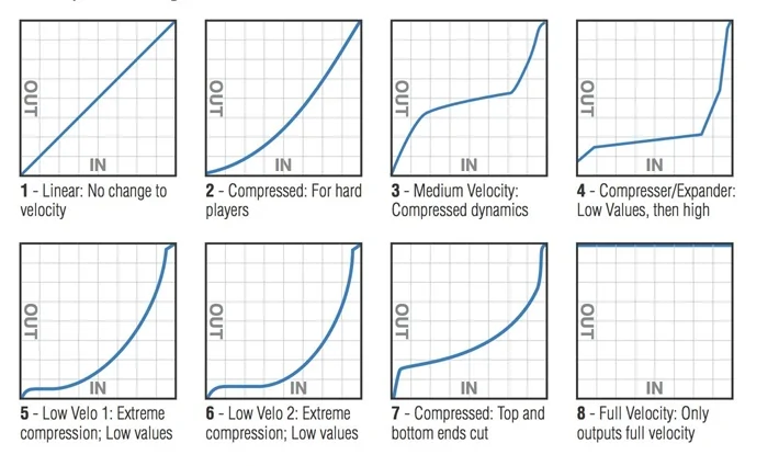

It's similar to "velocity curves" for electronic music keyboards/drums/midi guitars, which determine the level of control signal sent by the instrument to sound generators in response to a particular level of strike force-
Porsche Taycan EV throttle response velocity curves
I don't remember what the Taycan's throttle response curves look like (presumably they differ between drive modes), but I personally prefer the pedal finesse of my Turbo CT MY22 to anything else I've driven (on road or track). It's so easy to control all the way from crawling in traffic to flat out acceleration and balancing the throttle around corners.
Keyboards and/or sound generators curves can often be tailored by the user, but I suppose allowing drivers to do similar with throttle mapping would risk loss of control or damage to transmission.

It’s easy to control crawling or flooring it.
The hard part to control is in the middle. From that chart, my guess is it’s somewhere like #6 but not quite as extreme.
I do disagree with your last point though. Adjusting the mapping would have zero effect on the drivetrain. The only difference would be how far you have to move your foot to get a given result, but the “results” would be unchanged.
I was taking a simplistic view without considering other control systems between the pedal and the motors, where a mapping that more readily surges from low to full power (possibly even unintentionally) could put more strain on components between the motor and the tyres (well, tyres as well I suppose, but they're more expectedly consumable).
