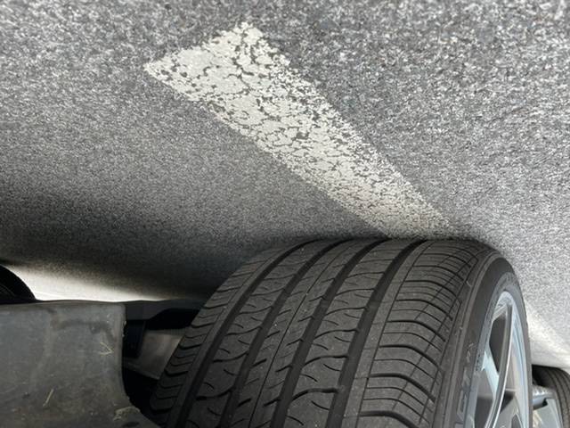

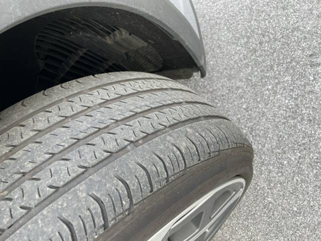

my fronts are far more worn than my rears at 14k miles probably will replace at the end of the summer
Porsche Taycan Front tire wear 688455E2-EEC2-416C-8749-F37678D8E3F2
Porsche Taycan Front tire wear 500E1F57-9766-4239-B8AD-B5D6938E419C
