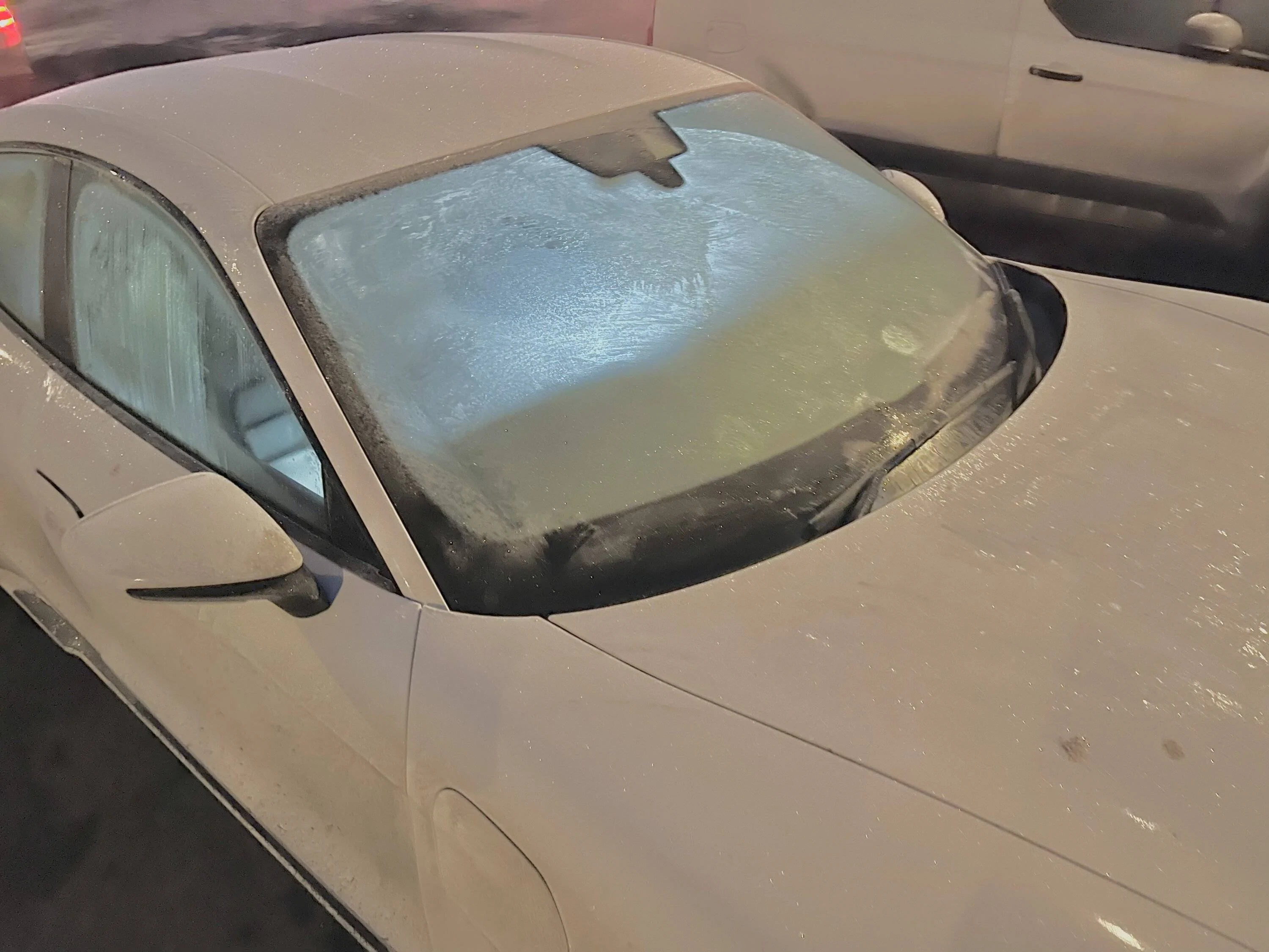

So the other day, when it was -10, my heater stopped working. The fan was blowing, but it was blowing cold air. I tried restarting the car, and I charged it up to 80% overnight, thinking something might reboot. No luck. Seemed to me that the heating element somehow fried. Brought my car into the dealership without an appointment. They were awesome. Took the car and even found a demo for me to take so I would have a car to drive. Next day got a call that it was indeed the heating element. Had to be replaced but it was on back order. No idea when I would get my car back. Could be a month or more. Thank goodness I can rely on my dealership, they have always been awesome to deal with (unlike some others I have read about in various posts). I have a car to drive while I suffer like so many others from the world wide supply chain debacle. Has anyone else experienced issues with their heaters?

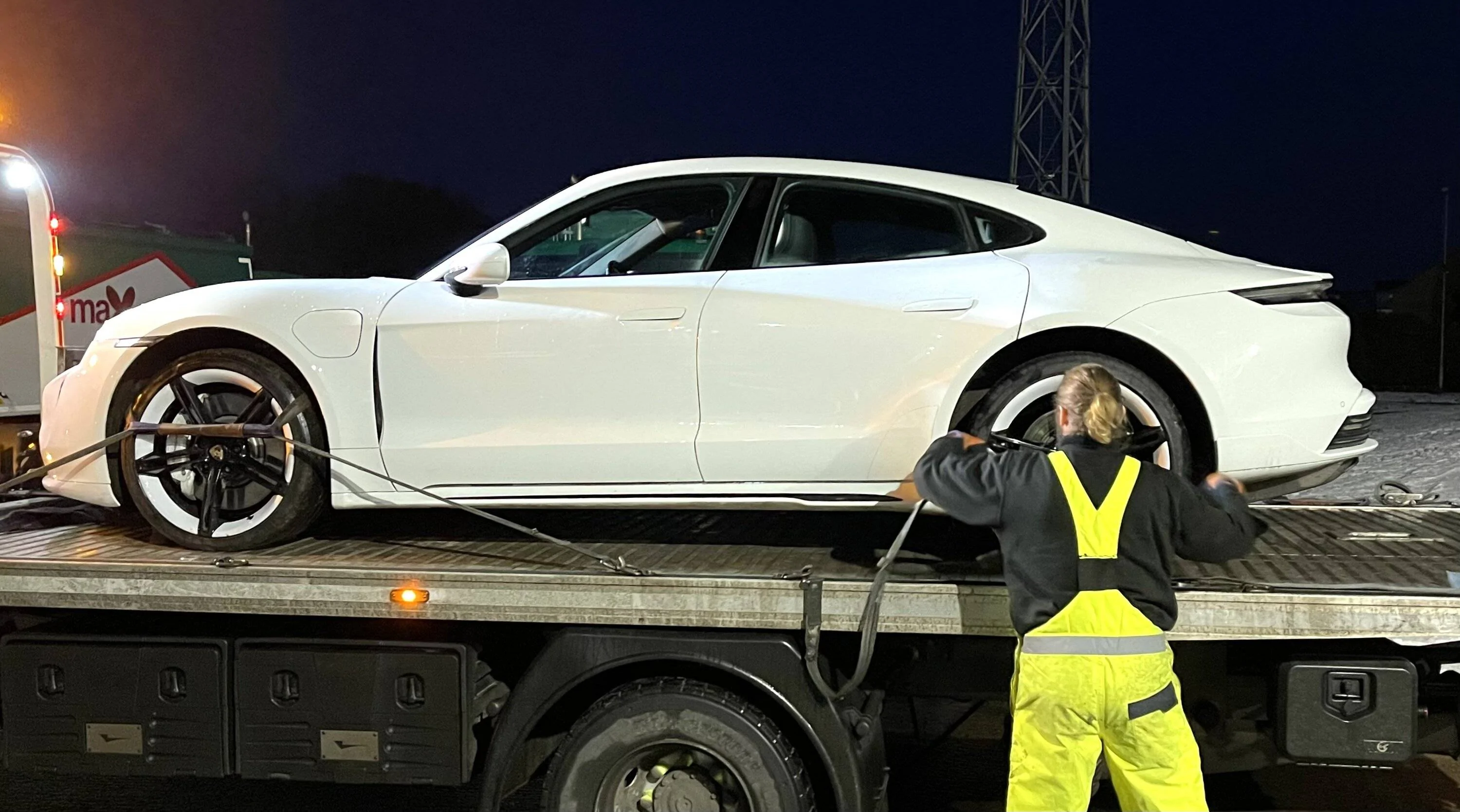

The heater function in the Taycan is simply not fit for purpose; my heater matrix was replaced in January and the car has now been off the road a further 3 times since the beginning of November, totalling 29 days, for exactly the same problem.
It is a Worldwide problem and Porsche assist told me “thousands are being recovered”
- 40 alone at my local Porsche dealer.
The inside of my car froze solid while driving it recently,
