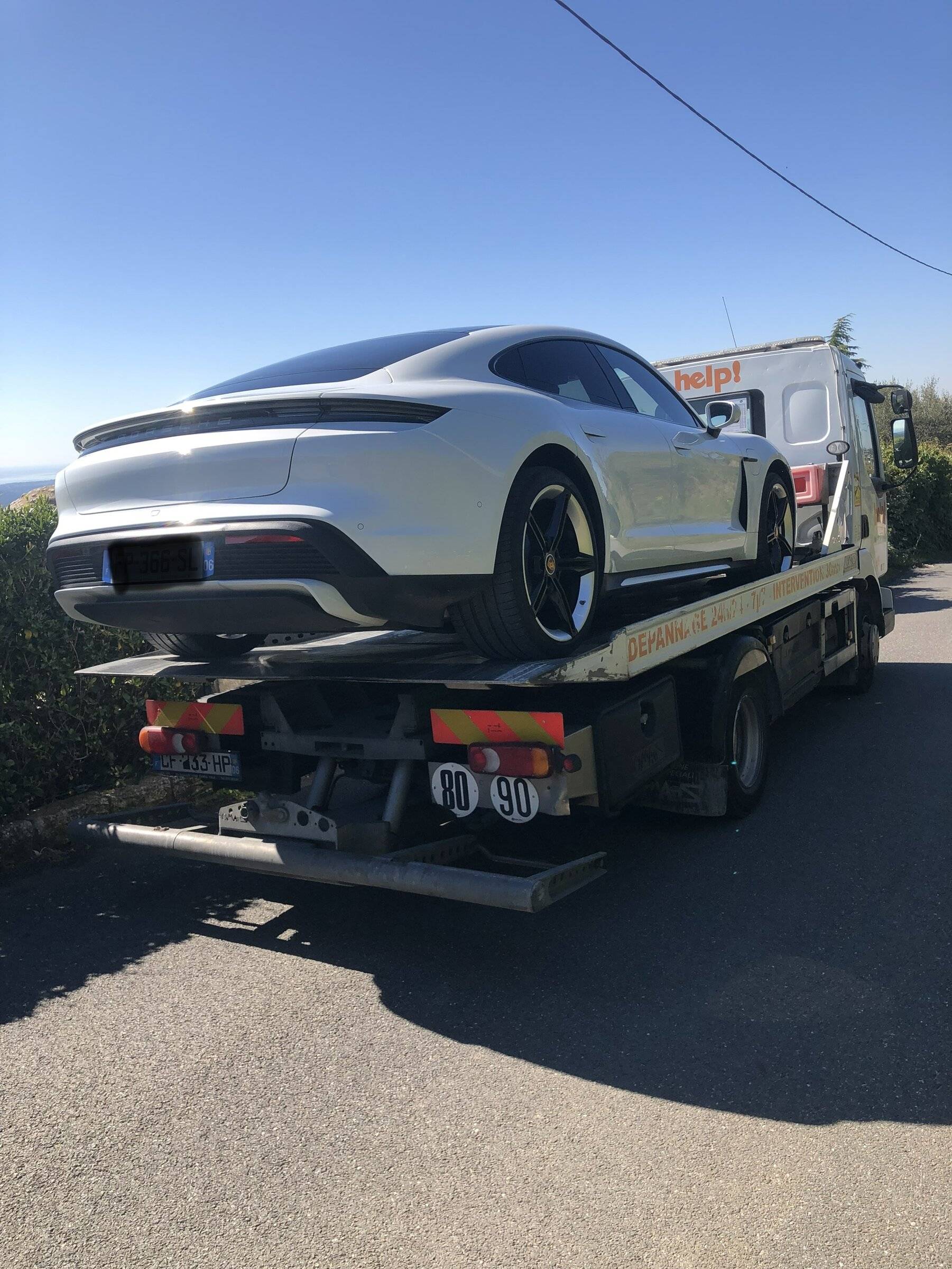

Picked up my car on Thursday, after yet another Gateway communications change. As well as a change of USB connectors.
SW update (recall??) WNA5?also performed as well as several updates to the PCM and navigation. 2 year service was also performed as the car is planned to go on long trips in April and May. Service Agent confirmed they had performed checks and necessary updates to all ECU (100+) in the car as well.
Yesterday evening with outside temperatures down to 4 Celsius, the heater refused to work. On the way to the airport to pick up family for the Easter break. The car steamed up quite quickly with all passengers and luckily the seat heaters and steering wheel heater worked.
Very disappointed to have further problems.
Flatbed to Dealer as this is a Safety issue here.
Porsche Taycan Heater issues anyone? BFF51EF7-AEF9-41A1-995A-DD08729AC27B
Still waiting for a loaner or rental car 12 hours later. Excuse by Porsche Assistance. “They are unable to find a suitable rental car. Only City cars were available!” The dealer will not provide a loaner and Porsche France really does not care.
Seems so many of the cars have these issues after 2 years?
I do need a car with 4 seats at least, for the Easter break when all visitors are arriving.
Of course no warning or fault message in the car and guess only visible with the PIWIS system
