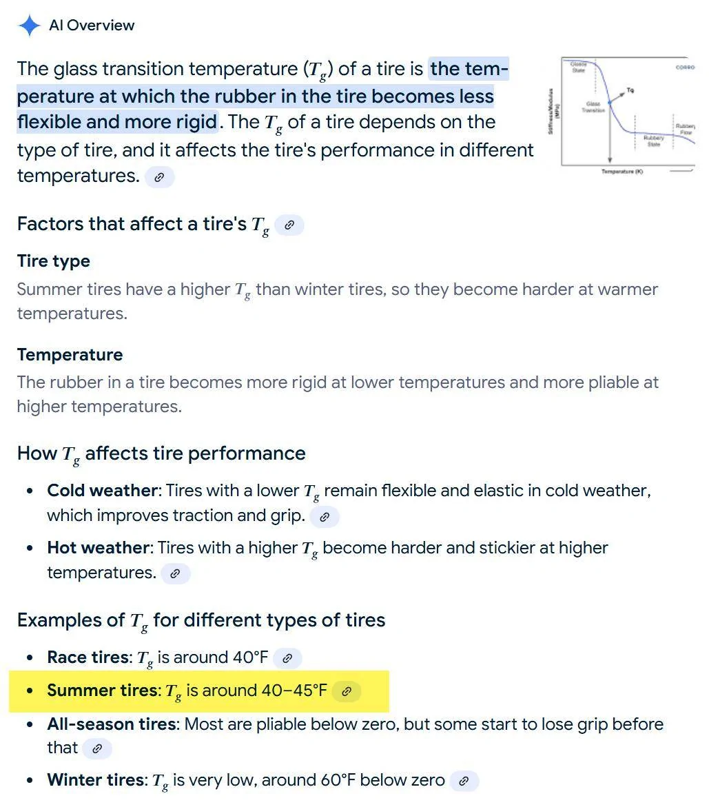

Now, to say that summer tires turn to glass at 45F....wtf?
What I said was (emphasis added)
summer tires start turning into "glass" at about 45F
I was referring to what is called a "glass transition temperature". An excerpt from Google AI below
Porsche Taycan Help for Tires needed! - brand new owner 1737530225186-5
drove on my summer tires this afternoon at 30F, and they didn't shatter.
I never said they would shatter. I said that at temperatures below freezing, some of the soft compounds become more brittle and can start cracking internally, which would weaken the tire structure. You driving on summer tires at 30F is not going to have zero traction. Heck, you could drive on just rims and still have some traction, especially on dry pavement (check out some police chase videos online). I used to hobby with RC cars. Sure, you could put hard plastic tires on them and still race around the street, but putting rubber tires significantly changed how they accelerated, turned, decelerated. When you drive on summer tires at 30F however, your stopping distance from say 50mph is significantly increased, even more so in snow or ice.
