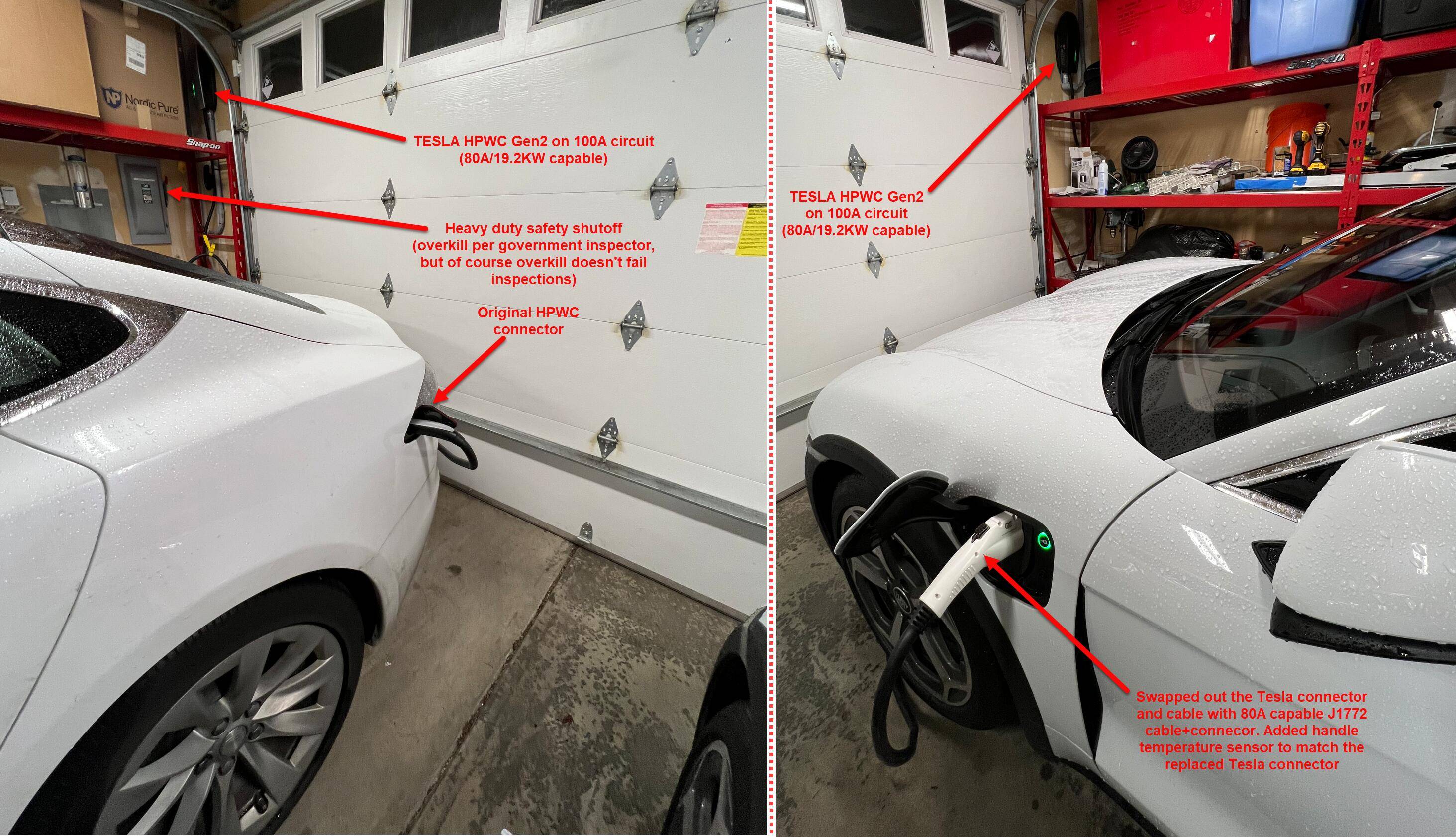

Thanks for your suggestions. It was tight removing the adapter from the Taycan as well. How did you replace the cable permanently. Will really appreciate if you can post a link to that product.
The TeslaTap Mini gave me no troubles removing from the Taycan, only the HPWC Gen2, it was going on easy onto Mobile Connector Gen 1 and HPWC Gen 3.
Replacing the cable was not rocket science, but you have to be comfortable with some DYI. Here is a video going through the process on a Gen 3, Gen 2 is similar (see my notes below)
Now, a few things to note.
  1. The new cable needs to be capable of handing the max current you plan on using it. I use my HPWC's at their max 80A, so I had to find a cable and J1772 capable of 80A, which took some time - I eventually found some used ones on ebay. If you plan on using less, make sure you put a sticker inside to never change the rotary dip switch above the J1772 cable rating
  2. Instead of changing the cable, you can reuse the Tesla cable and swap out the plug. 80A are also hard to find, and expensive, but here is one: https://qccharge.com/products/j1772-plug-assembly?variant=39410347999391 .Not cheap, I've seen them on Alibaba for $50 but you have to order in volume
  3. You don't need the bypass circuit since mentioned in this video since you can just change the Tesla Comms dip switch instead.
  4. In the video the guy used a 10K resistor to essentially fake out (disable) a temperature sensor. J1772 handles don't usually have temp sensing, but my cable had extra signals available and I like going the extra mile on my projects, so I put one in and connected it anyways. You will also have sufficient signal cables if re-using Tesla cable. I used this thermistor as it seemed to match the ones found in Tesla handle teardowns: https://www.digikey.com/en/products/detail/epcos-tdk-electronics/B57164K0103J000/739847 . It's been working just fine charging my Taycan at 80A.
Also, there is a place which advertises they will do the conversion for you: http://www.umc-j1772.com/index.php?route=product/product&path=67&product_id=175 . They even let you choose the length of the cable you want.
If you are only using 48A from the HPWC, perhaps a bit more money but lot less hassle would be to pickup a J1772 version of HPWC Gen3 instead? I decided on the conversion because I wanted 80A shared between 2 cars (only Gen2 HPWC supports this), plus I already had them wired up in the garage. Here is my setup right now:

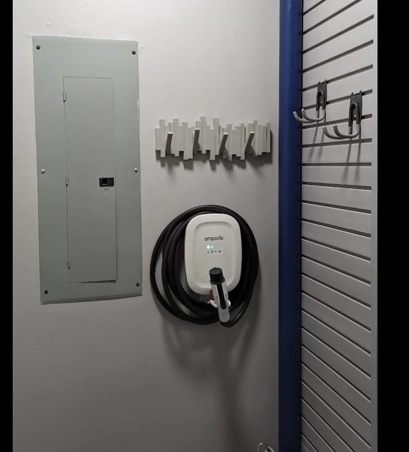

Just did this with Emporia charger.
You are going to love your GTS. Thanks for your feedback and suggestions. Unfortunately Oncor, here in Texas, does not offer any help on EV chargers. I am upgrading to 60amps and replacing my Porsche wall-mount charger. Does anyone have an opinion on the Enphase HCS-60 vs. the Chargepoint Homeflex Hardwire? Thanks
The Tesla is getting replaced soon, which means I will be converting the other HPWC at that time.
