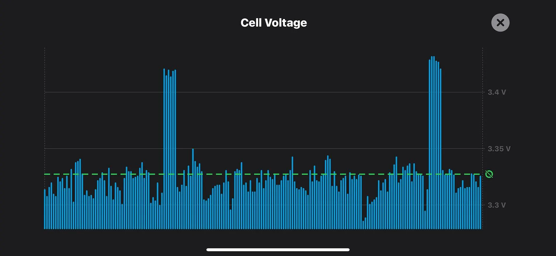

will be interesting to compare notes about development and results. I have already had two modules replaced in my battery so my initial graph has a cell voltage deviation of about 170 mV!

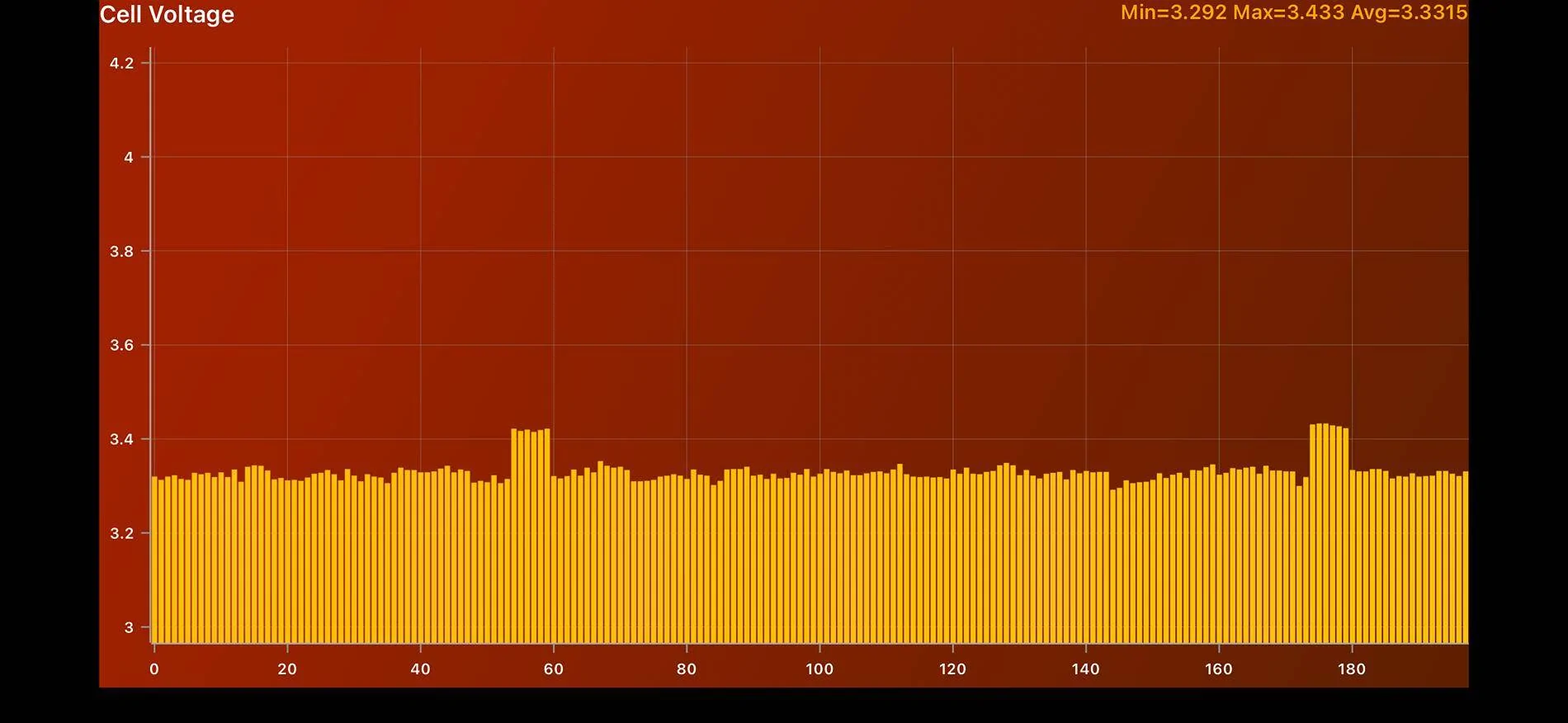

I assume that the 2 groups of higher voltage cells are the battery modules that were replaced in @Scandinavian 's Taycan.
How does the battery management system handle charging when some cell/module voltages are higher than that of cells in other modules?
During the charging process, do their relatively higher voltages result in the other modules being charged to a lower voltage than would be the case if all the modules were roughly balanced in voltage?
I remember some posts in other threads indicating that as a HV battery gets older, replacing some of the modules would not be a good thing because the replacement modules would have higher voltages than those in the rest of the battery.
Maybe @Dr Bob or other battery experts would comment.
Yes the two modules with higher values are the ones that have been replaced.

Firstly, I have no clue of the details how Porsche operate their Battery Management System (BMS). However, battery balancing is quite straight forward to understand but maybe not as simple to implement. Li-ion batteries can either be top balanced or bottom balanced. You cannot do both. Most systems use top balancing. So charge is applied to each cell (or module) and that increases the state of charge as Li ions move to the Cathode and that increases the voltage of the cell. To make the battery most efficient you want all cells reaching the 100% limit during charging at the same time – ie their voltage reaches the max at the same time. That will be a fully top balanced bank. Unfortunately every cell is different and will have a slightly different capacity (ie different internal resistance etc) so the voltages at the top will not be all the same– and this gets worse with each cycle – so the BMS has to alter various cells to bring their voltages all together as they reach 100%. Thus as you charge out of the voltage plateau (over say 80% SoC), the battery will see differences in cell voltage and start draining some cells and charging others (note the BMS cant see the voltage differences until SoC gets over 80% ish). The balancing can be a long process as the wires to each cell are small diameter and current cannot flow too fast. Charging to 100% and not discharging for a while can allow the current to flow in and out of the higher and lower voltage cells – but I have no clue if this balancing continues to happen in the Taycan after you turn it off.
Now, what happens if you dont balance it. Well we will end up with a range of voltages in the cells as the top one reaches 100% charge. It could be the cells with the lowest voltage could be a few percent of charge short of the 100%. That % short in a number of cells has therefore reduced the total amount of charge from what you would have in a fully balanced battery. Your SoH will thus be lower. If you then discharge to low SoC, you will find some cells reach the low voltage value first while other cells could be significantly higher. It could be that some cells in the battery have a much lower capacity than others so will be a high voltage cell at the top end and yet be a lower voltage cell at the bottom. Some cells, however, will have similar capacities but one will be higher in voltage than the other both at the top and the bottom. However, as we are top balancing – and assuming all cells are balanced and reach 100% SoC at the same time, the variation in voltage will then be apparent at the bottom end – which is why the voltage spread is always worse at the bottom. The bottom end cannot be balance if we are balancing the top end.
You can operate a Li-ion battery without balancing but you loose capacity when you charge and some cells will reach the bottom earlier, again reducing range.
What I am not sure about with the Taycan, is what happens at the bottom end. One thing for certain is that it will not start balancing at the bottom end. You cannot top and bottom balance in the same battery. Balancing is a long process and going to 100% and discharging is not enough time to balance. The instructions to hold at <10% (or whatever SoC is chosen) earlier in this thread to reset the battery must be to let the BMS record what the voltages are so that that data can be used to calculate SoH or range once you get back to full SoC.
The information on Peter's car is interesting. The two high voltage cells/modules (measured at the bottom end) show they are significantly higher voltage – which is almost certain to be higher capacity cells, so on charging they will get the same charge as the other cells – until they get to over 80%. The BMS will then compare voltages but as the capacity of the new cells is higher, their voltage will not be as high as they only got the same charge as the others. It is possible then once in the top voltage knee, their voltage is the same as the rest. The BMS will then be actively balancing the cells and the new ones will eventually end up with the same voltage as the rest. The new cells will show up at the bottom end of the SoC with this higher voltage difference.
In building a battery bank, you have to use matched cells ie reasonably close capacities. These new cells are different but will not show up if the top end balancing is done right until you go to the bottom end of the SoC range where there will be a significant difference in voltage. The range will therefore be determined by the bulk of the old cells and not reflect the higher capacity of the new cells.
My driving style is to seldom go below 20% SoC and never to go below 10%. That's when a bad in-balance can happen.

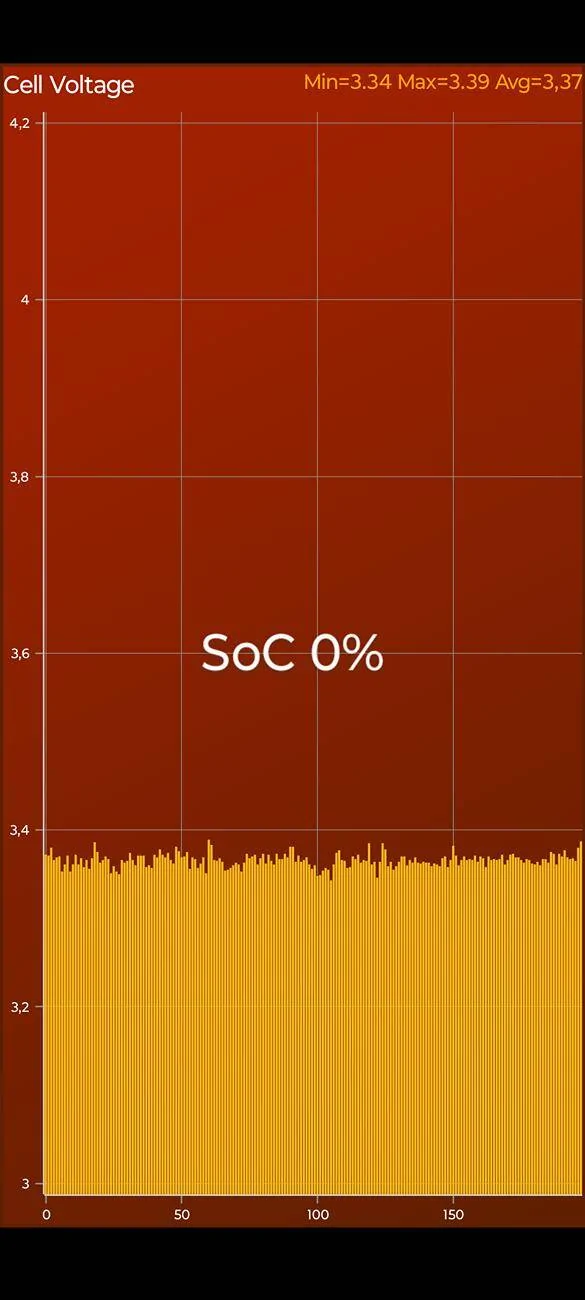

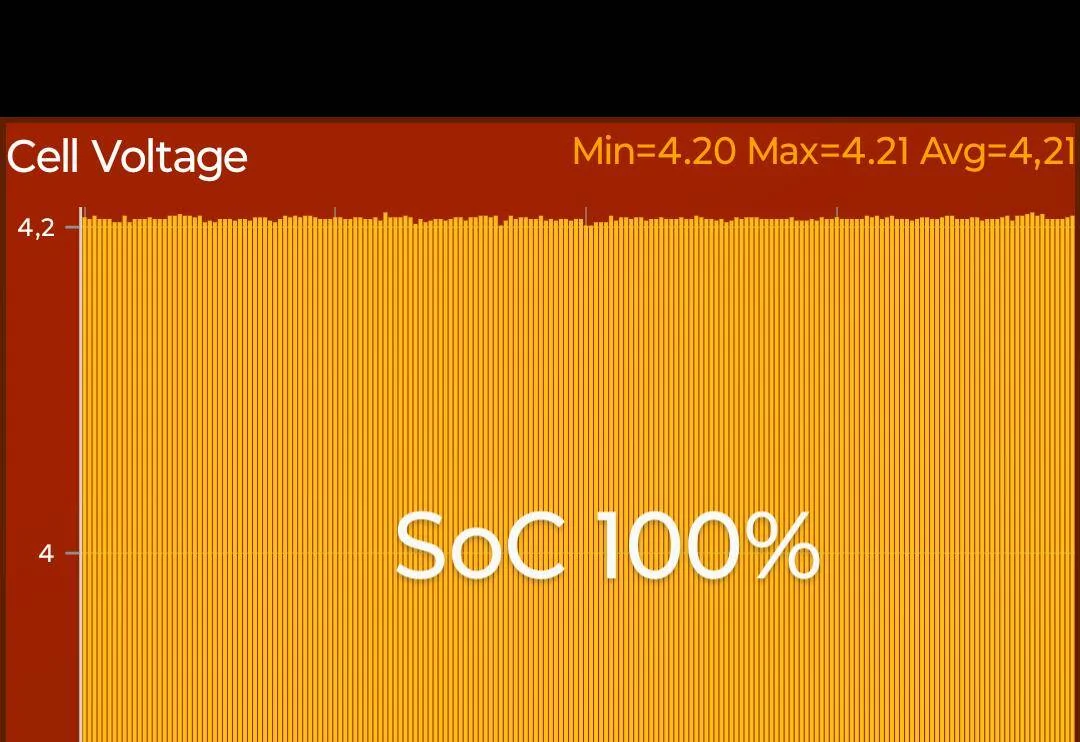

As you can see by my pictures, the difference in voltage is only visible when de SoC is low.
The lower the SoC, the better visible.
My cells are different by 1,47% at worse (0% SoC).
The higher the SoC gets, the lesser the difference if your battery is healthy.

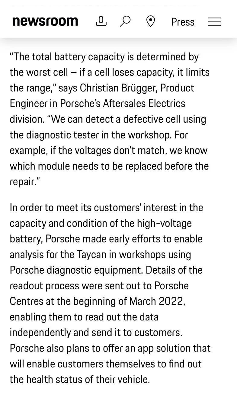

From this article, my understanding is that Taycan uses bottom balancing?
https://newsroom.porsche.com/en/202...h-voltage-battery-reparation-sales-26854.html
All that script says is that they are using voltage to show a difference between modules. Lets go back to what I said in my previous post. You can either top or bottom balance. You cant do both as full balancing will take many hours (ie 10+ if well out of balance) so you cant balance at the top then balance at the bottom. All the cells/modules will be different, so there would be too much current to transfer in the short time you go from 80-100% SoC (while top balancing) then re-balance at the bottom end as you get down to 20% SoC as you discharge to zero. Car makers therefore top balance so that all cells reach the max cell voltage at the same time (4.? volts) but then on discharge as all cells have slightly different capacities, there will be a voltage spread around the 3.3v that is shown in Peter's voltage graph earlier in this thread.
You can bottom balance but then that requires you to discharge to <20% and keep it there for hours so that all voltages are identical at 0% - but then there will be a big difference in cell voltages when charging to full and charging will stop as soon as the first cell reaches the max voltage leaving a lot of cells short of 100% charge. Car users prefer to be at 100% rather than 0%, so top balancing is universal in EV systems. (note – I am using the words cells and modules interchangeably – Porsche seem to focus on module voltage?)
So Dee is saying you can see the voltage difference at low SoC hence the voltages will be similar at high SoC - hence it is Top Balanced.

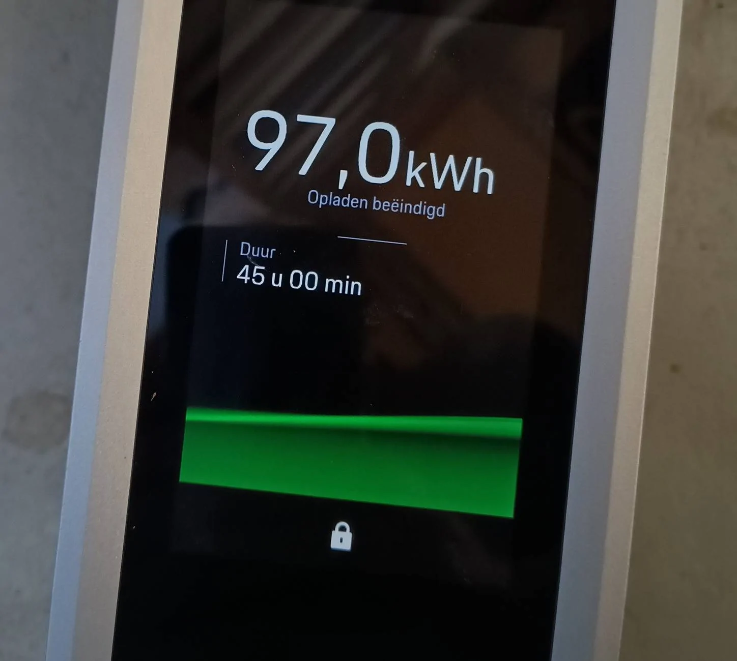

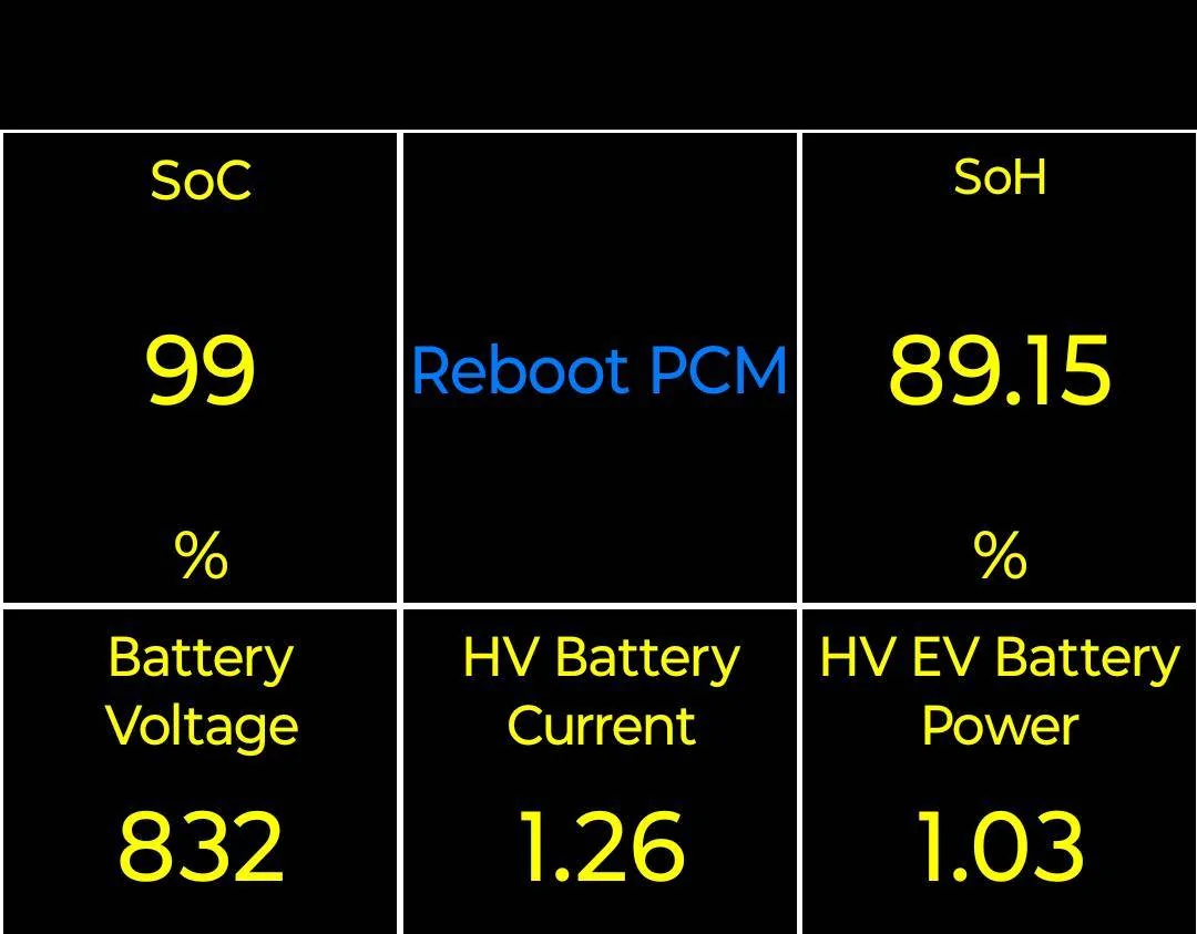

Ok, I'm done charging at a slow rate of 2kW.
Consumption is 97 kWh and it took 45 hours. ?
Porsche Taycan How-to Recalibrate your SoH. IMG_20240913_075352104_HDR
Assuming the useable battery capacity is 83kWh ("0"-100%) means I lost 14kWh.

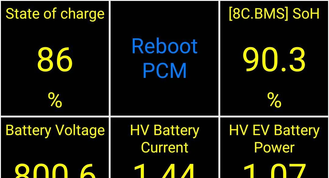

Ok, back to my SoH.
Did it improve?
Nope.
Porsche Taycan How-to Recalibrate your SoH. Screenshot_20240913-095418
Actually it got worse, from 89,5 to 89,2.
Battery voltage at 100% is still good though.
Porsche Taycan How-to Recalibrate your SoH. Screenshot_20240913-095455~2
Porsche Taycan How-to Recalibrate your SoH. Screenshot_20240911-074734~2
Conclusion: no improvement.
So now I'm curious if I see any difference after my battery recall (and brake hoses and A/C) end of October.
Of course I'll keep you updated.
To be continued.
