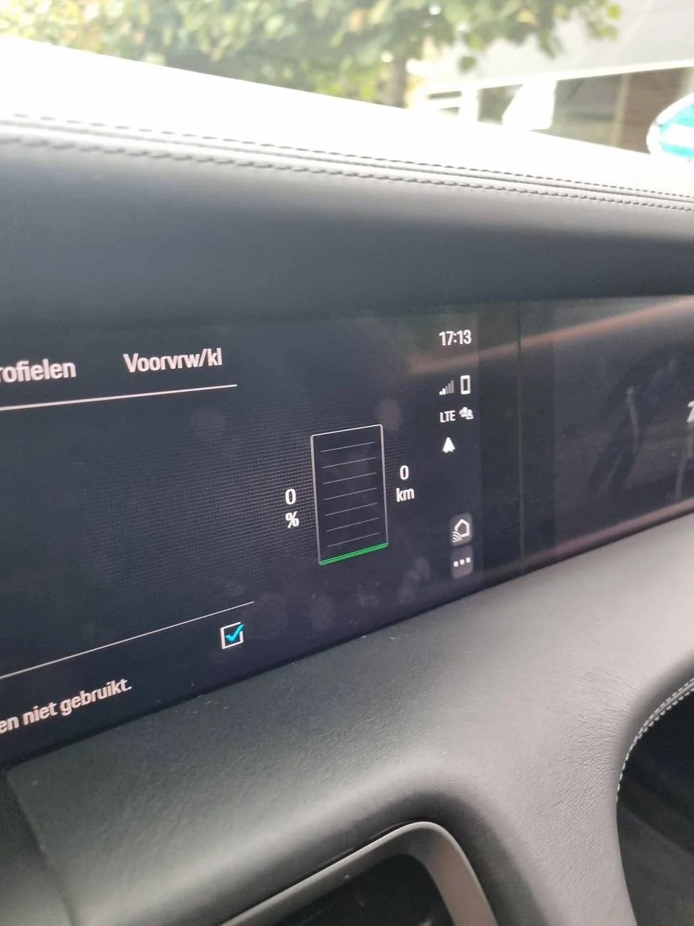

I have no OBD scanner to check before/after, but I start the recalibration process today.
Current SOC 0% 0km. Good start. I will let it rest now until tomorrow morning (say 12 hours rest in total). Then I will charge is using 11kwh home charger to 100%.
Then let the car sit another day/night.
See what happens.
Any other tips/tricks?
Greetz.
See what happens.
Greetz.

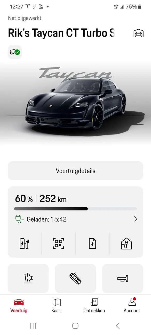

This morning after 12hr+ at 0%/0km SOC I discovered it "regained" 2%/4km....i left it the day before with 0/0. Now I am charging it to 100% on 11kwh. This afternoon (local time) it will reach 100% and will leave it at 100% until the next morning. Currently SOC shows 60% (252km).

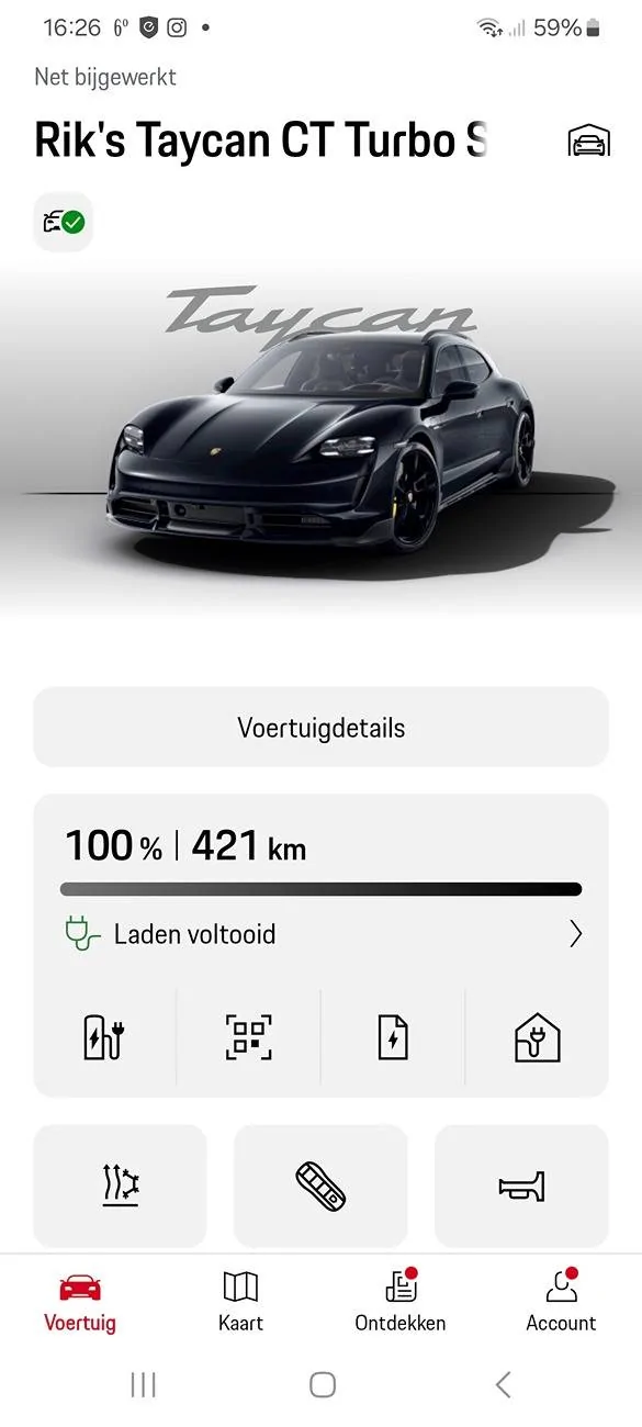

421 km / 100% now. I will take the charger off and let the car sit overnight.
I went through the same process and my SOC is identical to yours.............260 miles @ 100% charge. It will be interesting to watch over the next few weeks/months.

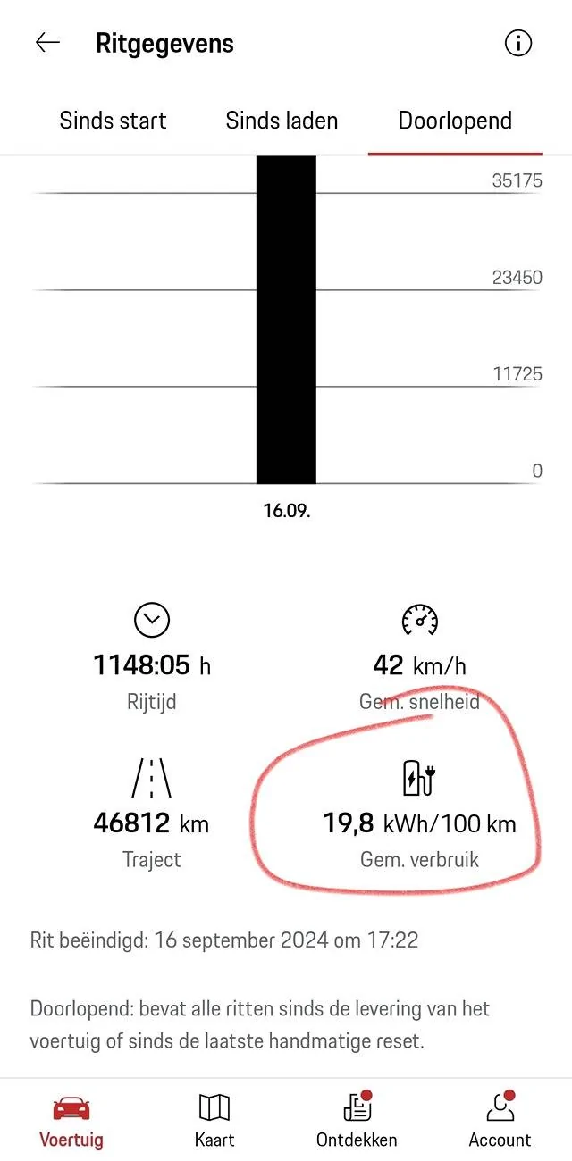

Excellent range with those wheels, what's your consumption?
I think my range on the GOM is so positive because of the "faulty" average consumption in the app/pcm....perhaps I should reset or not....
If I calculate the current say 421 km based on say roughly 80+kw battery (allowing for some degradation)..it comes close to that 19.8kwh/100km. Mind you, my driving style doesn't come close to that 19.8kw/100. As such the GOM reading for me is not realistic.

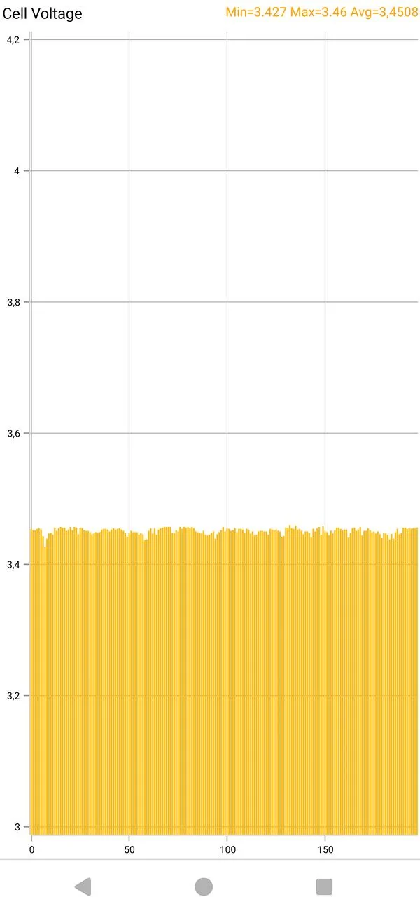

Attached are my charts before and after rebalancing. I couldn't get to 0% but was able to get to 8%. Battery SoH had minor 1% improvement from 89 to 90%. One interesting observation was back in May my batter SoH was at 88%. I don't see much range improvement after the rebalancing yet.

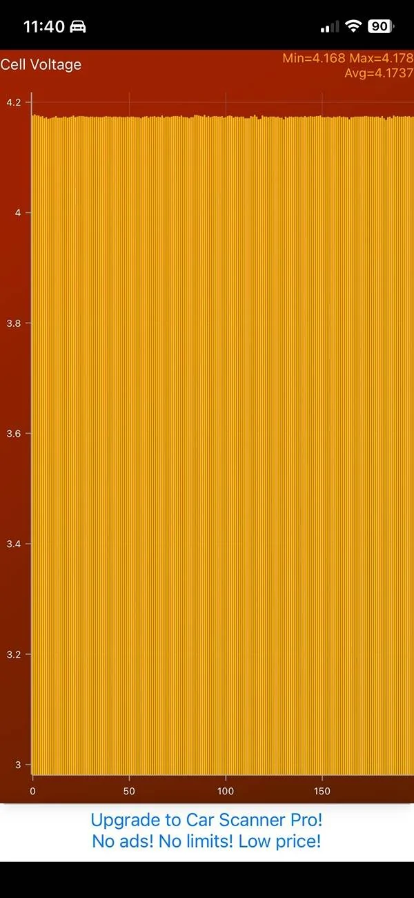

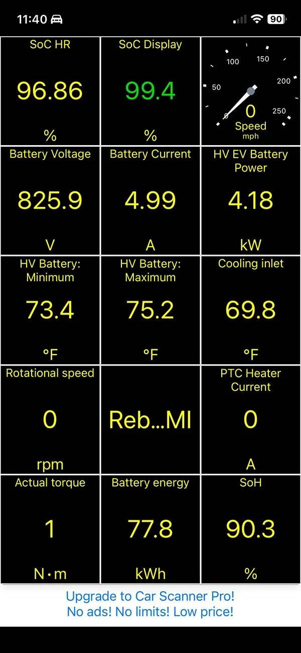

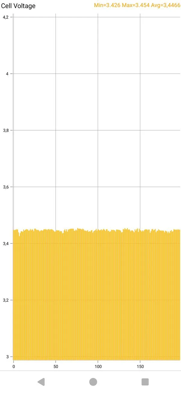

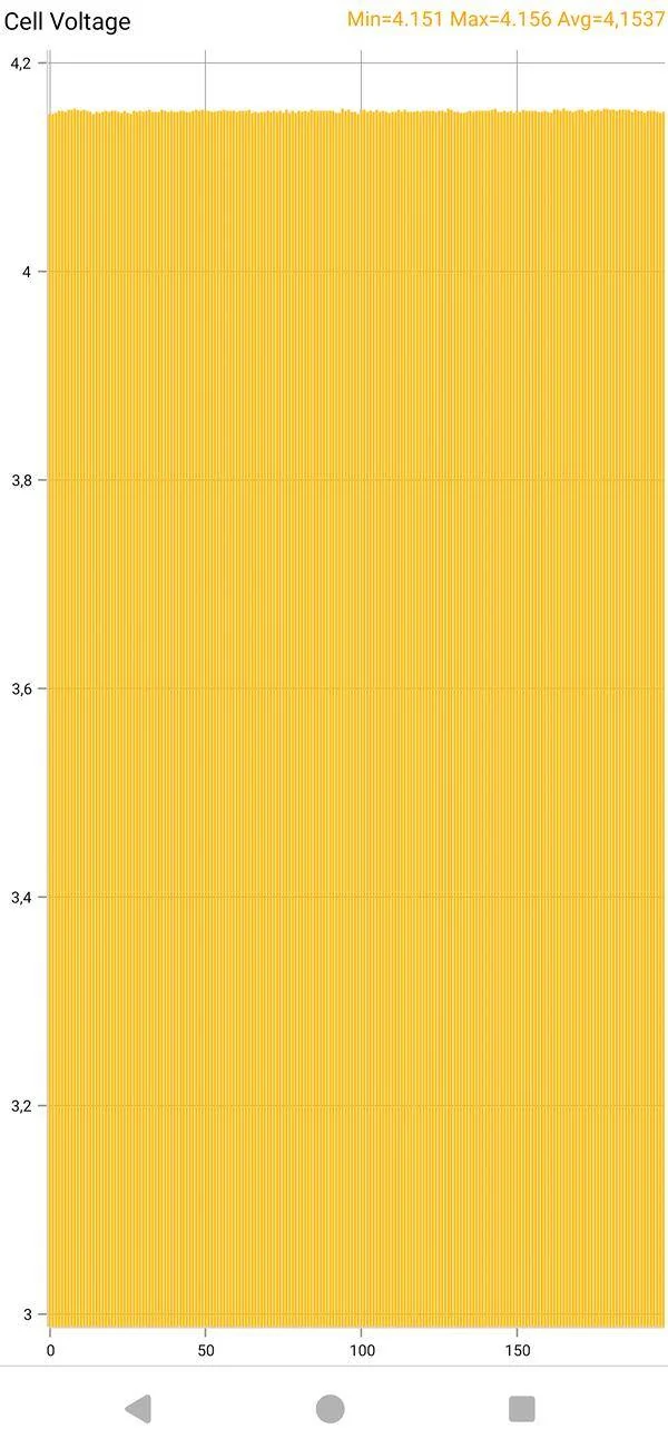

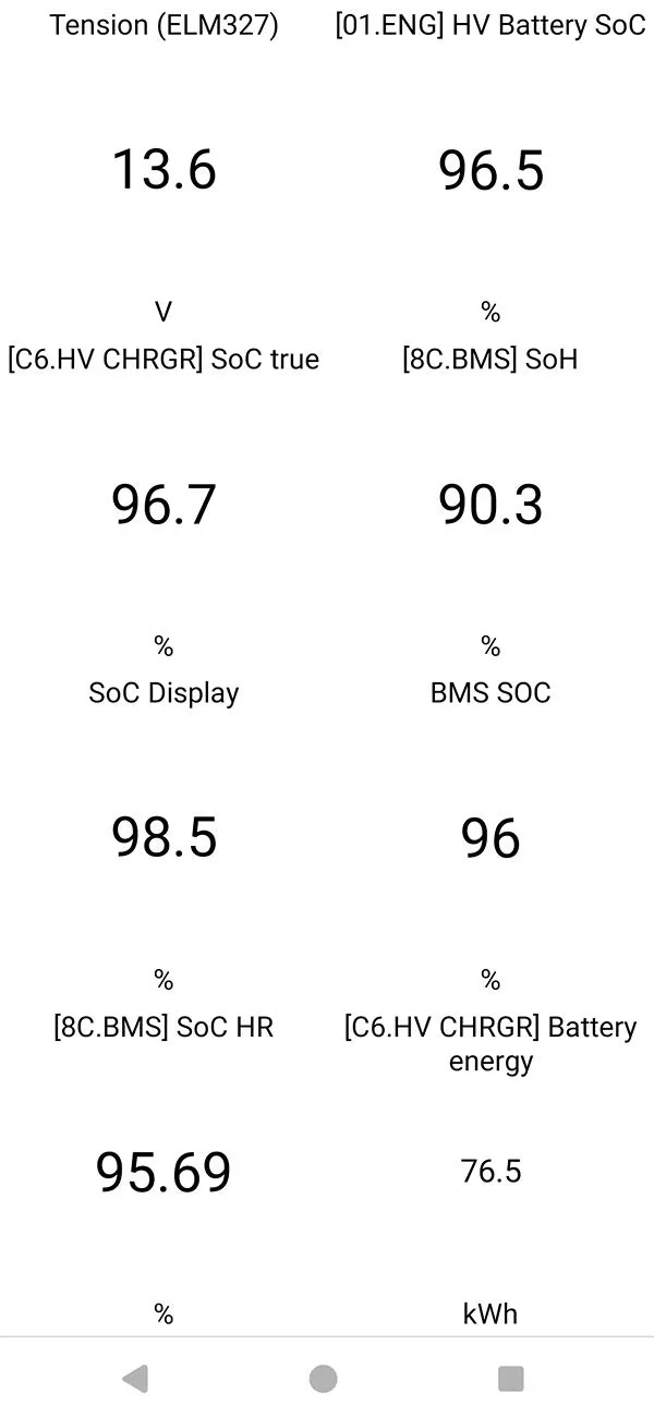

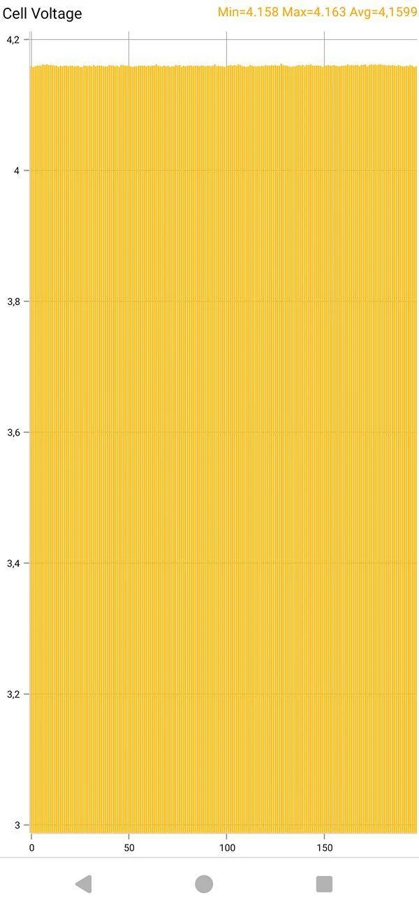

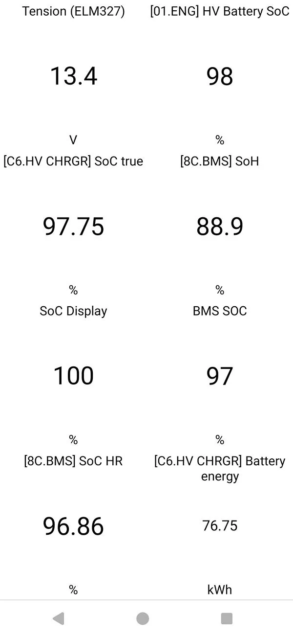

similar procédure: I went down to 9%, let it rest for the night, charged it to 100% the day after (AC 22kW) in 4hr, unplugged it and took it back 7hrs later.
SoH went from 88.9 to 90.3 [68500 km]
I didn't see much difference on the cell voltages before and after the 7hrs
before and after :
Porsche Taycan How-to Recalibrate your SoH. 1000028516
Porsche Taycan How-to Recalibrate your SoH. 1000028535
before and after :
Porsche Taycan How-to Recalibrate your SoH. 1000028517
Porsche Taycan How-to Recalibrate your SoH. 1000028534
for the record, voltages were more unequal at 9%:
before and after the night:
Porsche Taycan How-to Recalibrate your SoH. 1000028438
Porsche Taycan How-to Recalibrate your SoH. 1000028498
