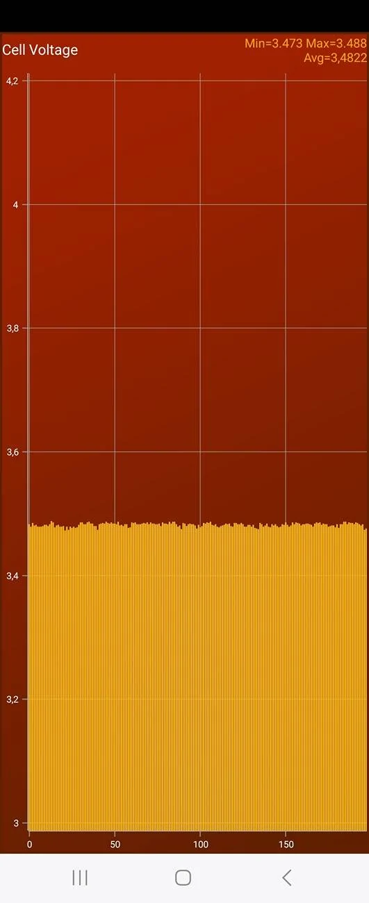

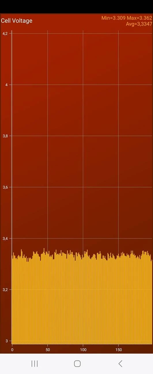

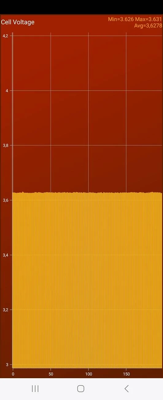

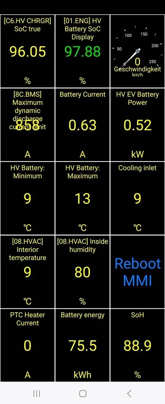

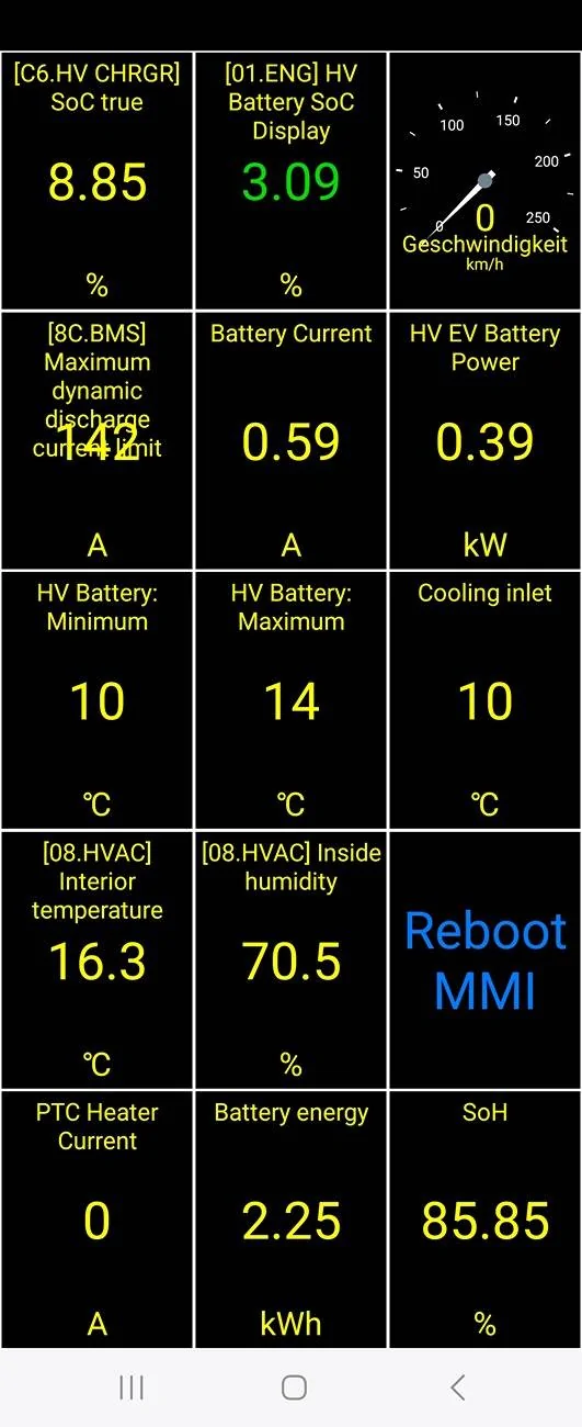

I noticed completely flat voltage readings combined with wobbly SoC cell readings.
Anyone know whats going on Here? Can it be fixed?
Porsche Taycan How-to Recalibrate your SoH. 1000045396
Porsche Taycan How-to Recalibrate your SoH. 1000045397
SoC readings were flat at high SoCs though.
I do not see anything unusual about SoC deviations as I have the same thing after recalibration and BMS is managing it the way it sees fit. I am more concerned about voltage, which is an indication of potentially failed module if one is out of line by a big deviation.

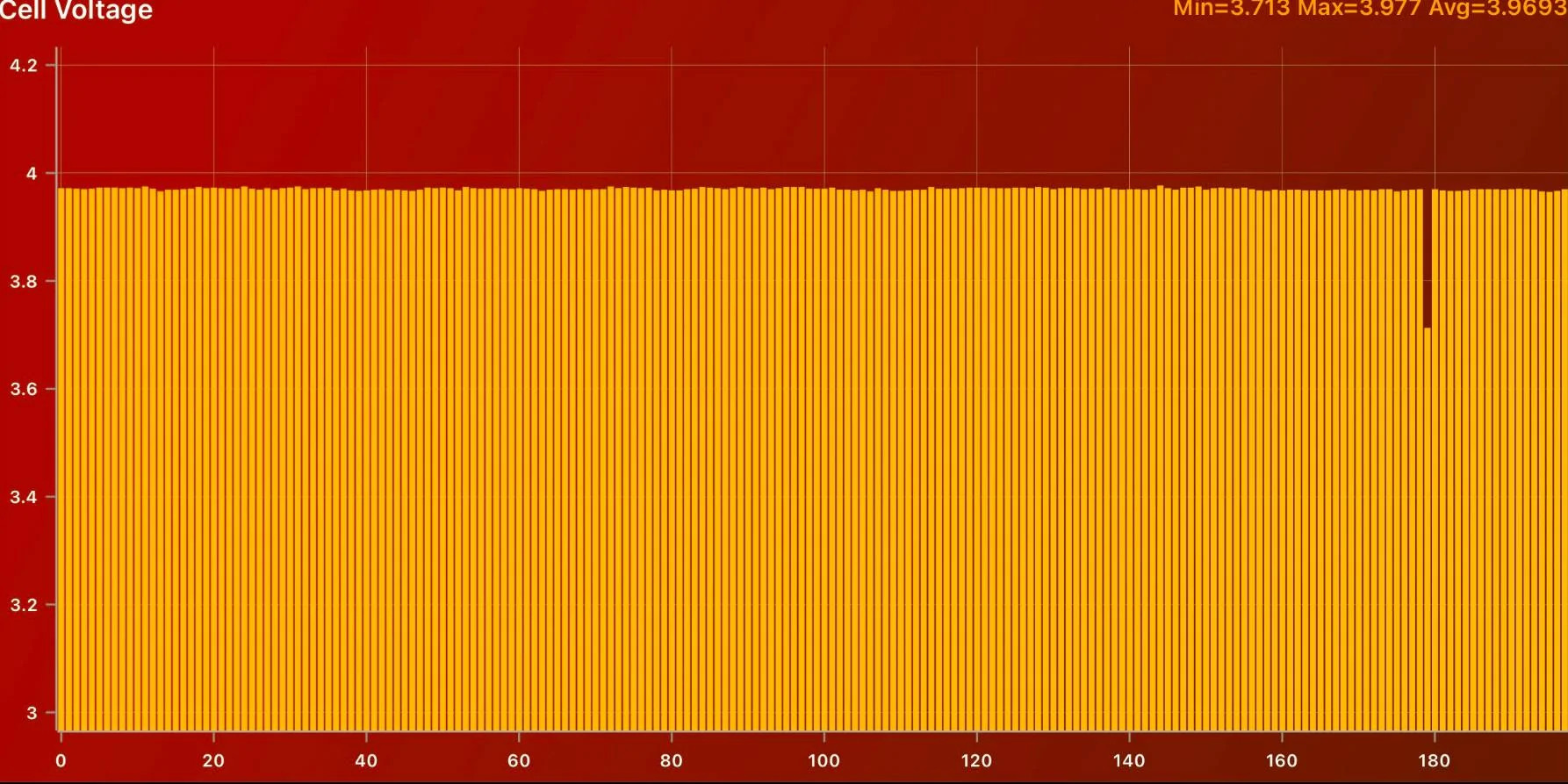

Your battery looks absolutely fine. More worrying when your battery looks like this!
I believe I am in for another battery failure
Only one bad cell! Nice! ??
This is such a "good" failure, very clear.
You have had a few cellblocks replaced previously and not the entire pack, right? Surely that does not look good unless you have zoomed to a crazy scale.
I see the same on mine and believe it's completely normal. Had the voltage curve been completely linear each 1% SoC would equal 8mV or someting like that. So that 5-6mV difference shows up as a small difference in SoC sounds reasonable when factoring in that the curve is not completely flat.
The way the modules are wired, if one goes bad the car goes into a Red Circle of death and cannot be moved.

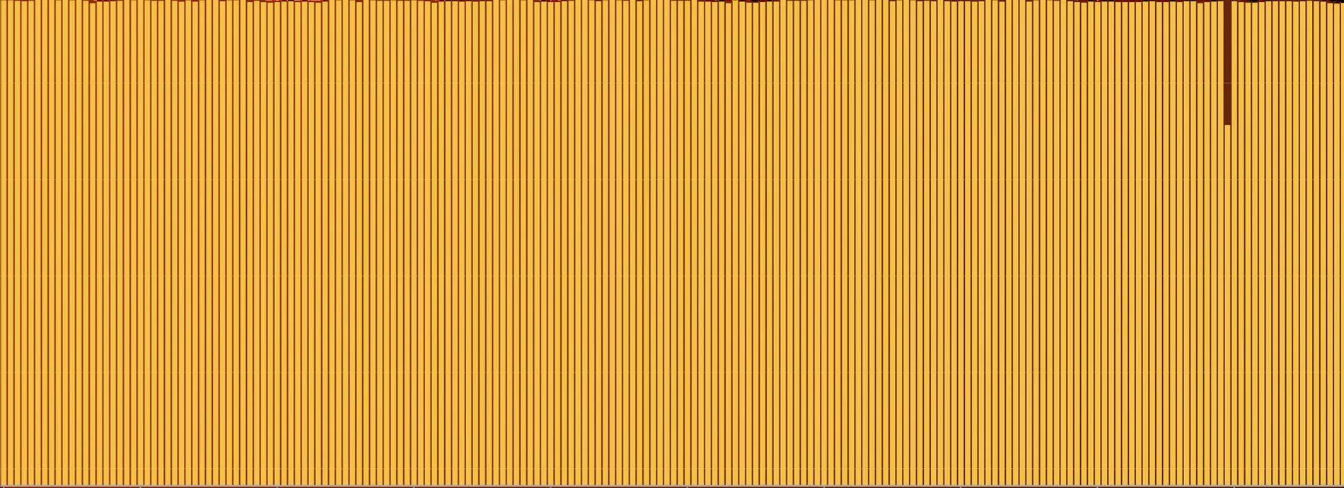

It is the same scale as CarScanner always shows, but I do not know why the photo became so different.
’I have had two modules replaced before and now it looks bad again.
’Here is another attempt at showing the normal picture scale
