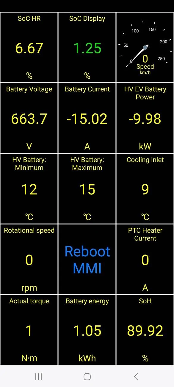

Trying the rebalancing process once again since now I am equipped with carscanner and the MC+ Vgate. Works well!
Loads of useful data I must say. I started with 88.1% and currently I read 89.66% on carscanner, this after leaving it overnight with 100% SOC.

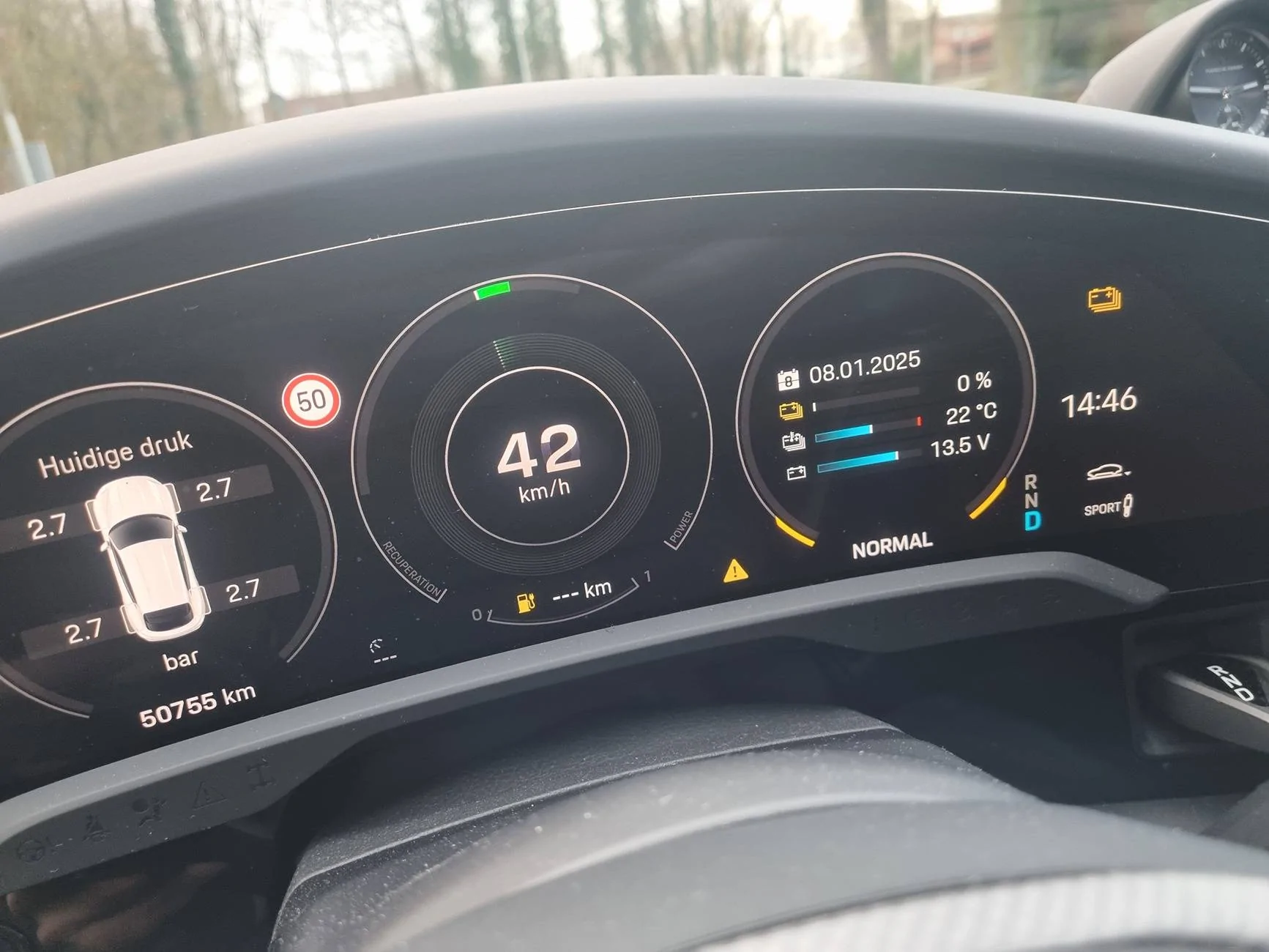

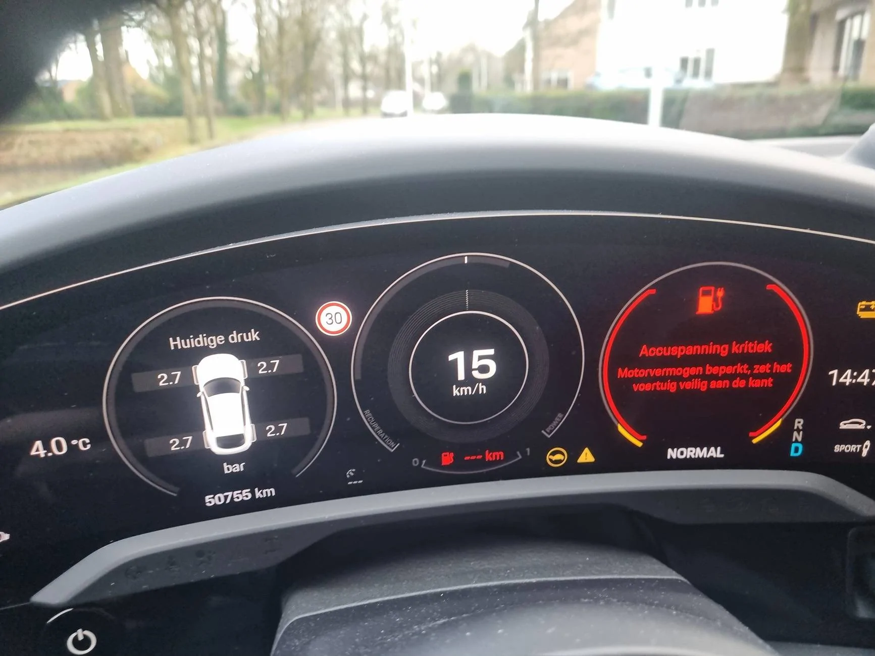

Today I drove it empty 0% (see pic) and I believe not much was left in the battery. well at least there is quite some more juice in than I expected!
I leave it overnight now at 0% and see what happens. Tomorrow morning I start the charging process to 100% and leave it at that charge overnight again. Let's see what happens. But did gain something already. From initial first check 88.16% to now 89.66%. Perhaps can hit 90%, let's see.
It was great to see the red critical battery warning pop up, as well as the snail icon :).

What you have done by going bottom to top slowly then allowing time for the passive rebalancing to take effect is to fully rebalance all the cells in the pack and recalibrate (relearn really) the whole min/max *SoC* algorithm.
This is NOT SoH. Only if the pack is really horribly out of balance (if you rapid a lot and never leave the pack to rebalance) will you pick up a few tenths of SoH which is what you are finding.
You don't (and in fact definitely shouldn't) leave the pack at 0% overnight. There's no need. It's the top of the pack that needs to sit to rebalance not the bottom.

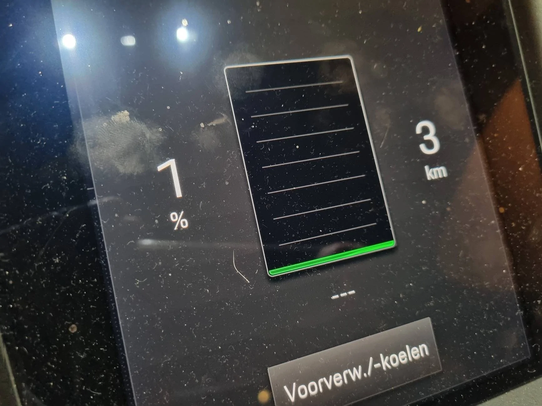

I let it sit today at 0% for about 8hrs....and just checked Carscanner. Now at 89.92% so up a bit. I have just started the charging process....i will get it up to 100% and leave it for the day (tomorrow). Let's see if I can hit 90%....would be great.
Fun fact. I let it sit for 8hrs at 0% (well 0%) and just woke the car up and I was at 1% / 3kms without charge. Something happens, for sure.
Tomorrow another carscanner check! To be continued!

Now I am monitoring closely and went down to zero (0%)....and let it sit at zero for about 8hrs without communicating with the car (no apps etc). Currently nearing 90% SOH....and as we speak the charge starts to 100% again. Tomorrow another Carscanner check!

Having said that, today I managed to empty the battery within 200km!!! Haha....great fun time on the road though....until the power backed down on me....and just at that point a BMW M popped up next to me at the traffic light....I was then forced to look at my navigation...:)

The part that you should be capturing are cell charts with SoC and Voltages. Those are useful to detect outliers that can potentially lead to bad cells.
I did....looking good earlier. All stable with very minor disprepancies. Will post all tomorrow for reference
