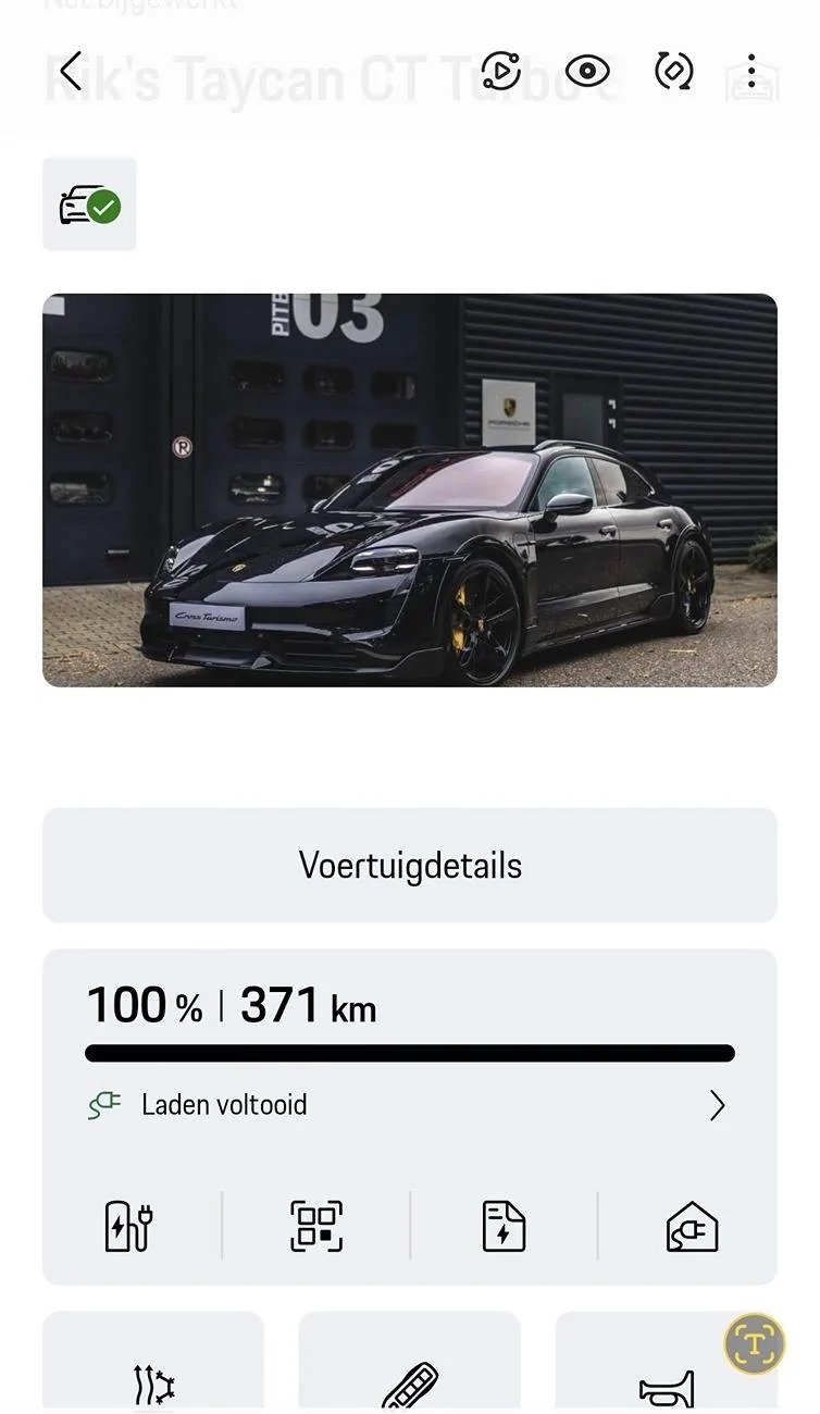

Pretty happy with the result after the waiting period sitting at 0% and the subsequent charge to 100% (with the results attached).
Now I let the car sit for at least 6.5hrs and check the carscanner results again.

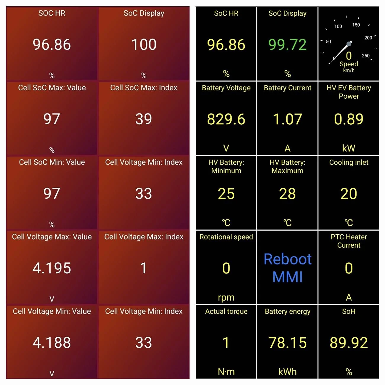

I started the process at 88.16% and currently (pre final check after the 6.5hr+ waiting period at 100%) the SOH reads 89.92%. 1.76% difference. I expected less, so this is a win.
Whatever happened, something did happen!

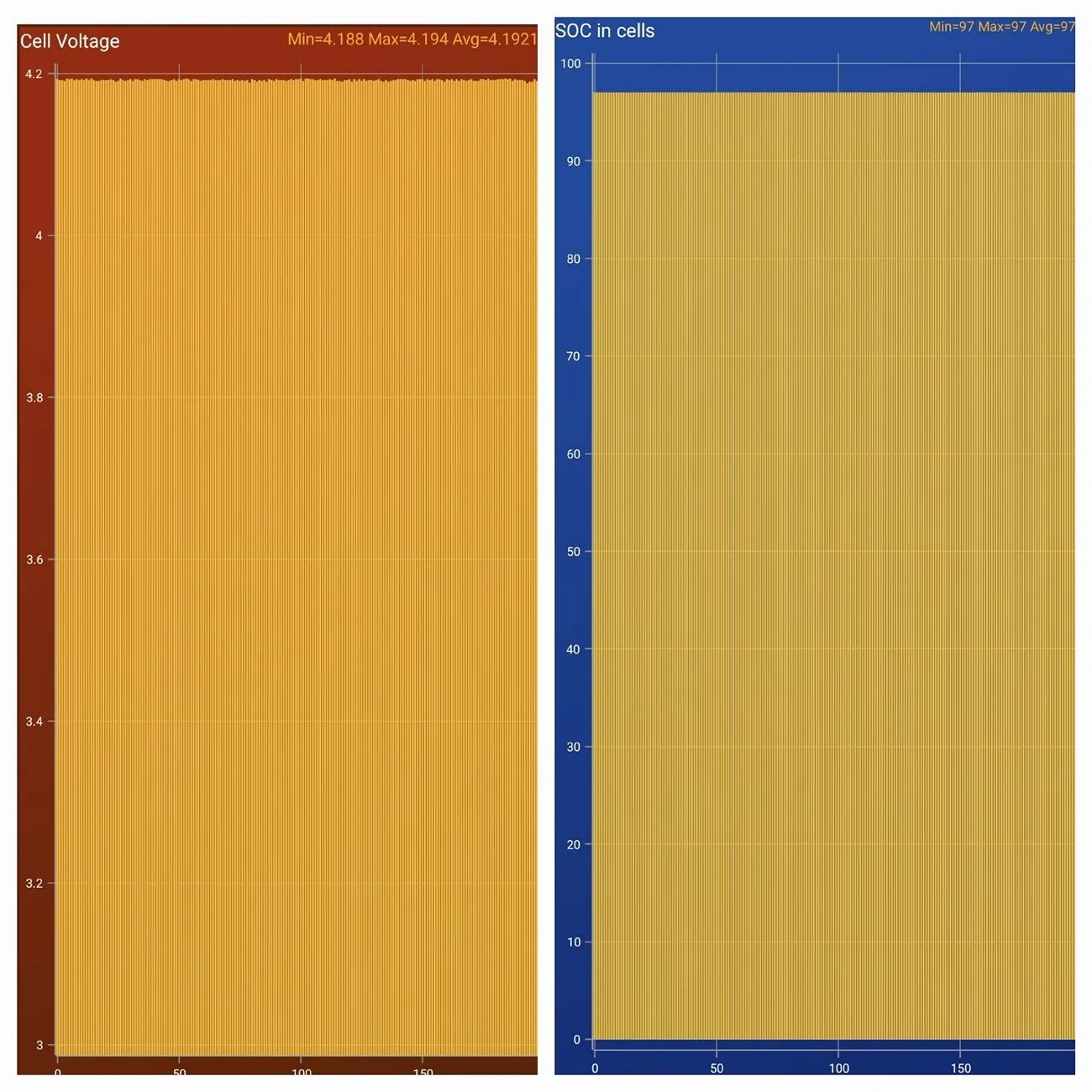

6mV diff in cell voltage (min-max)
and evenly charged cells.
may i conclude this looks healthy?
I think what you are showing is a healthy state after SoH recalibration.
I see you have 50k km, so that is a really good SoH level for the mileage.

Your battery looks absolutely fine. More worrying when your battery looks like this!
