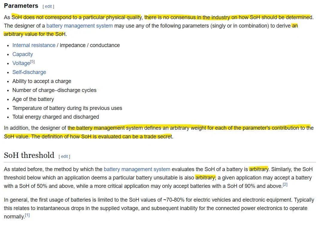

https://en.wikipedia.org/wiki/State_of_health#SoH_evaluation
Since SoH generated by a BMS is arbitrary, owners do not really know if the SoH value generated by the Taycan BMS is calculated the same arbitrary way for all Taycan models or for different model years. "Arbitrary" does not necessarily imply "consistent".
As apparent SoH declines, perhaps the BMS 'readjusts' the relative weights of parameters measured to "boost" the reported SoH value.
How would an owner, or anyone without access to the BMS software, know?

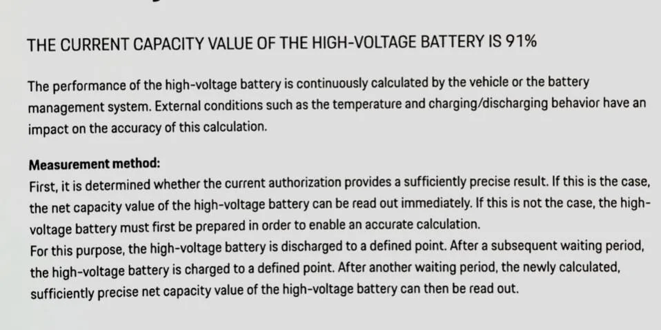

The SoH measurement method used by Porsche when determining SofH is shown below.
The pre-amble mentions that temperature and charging/discharging behaviour (?) affect the calculation
From this, the SofH is a snapshot rather than an absolute value and may vary.
This becomes critical only if the manufacturers warranty milestones are in doubt (80% at 3 years, 70% at 8 years, up to 100k miles).
It is unclear to me what part (if any) the ‘unused’ capacity plays in the calculation and the purpose of this.
Charging time efficiency? Battery longevity?
If I remember correctly the waiting time referred to is a minimum of 6.5 hrs.

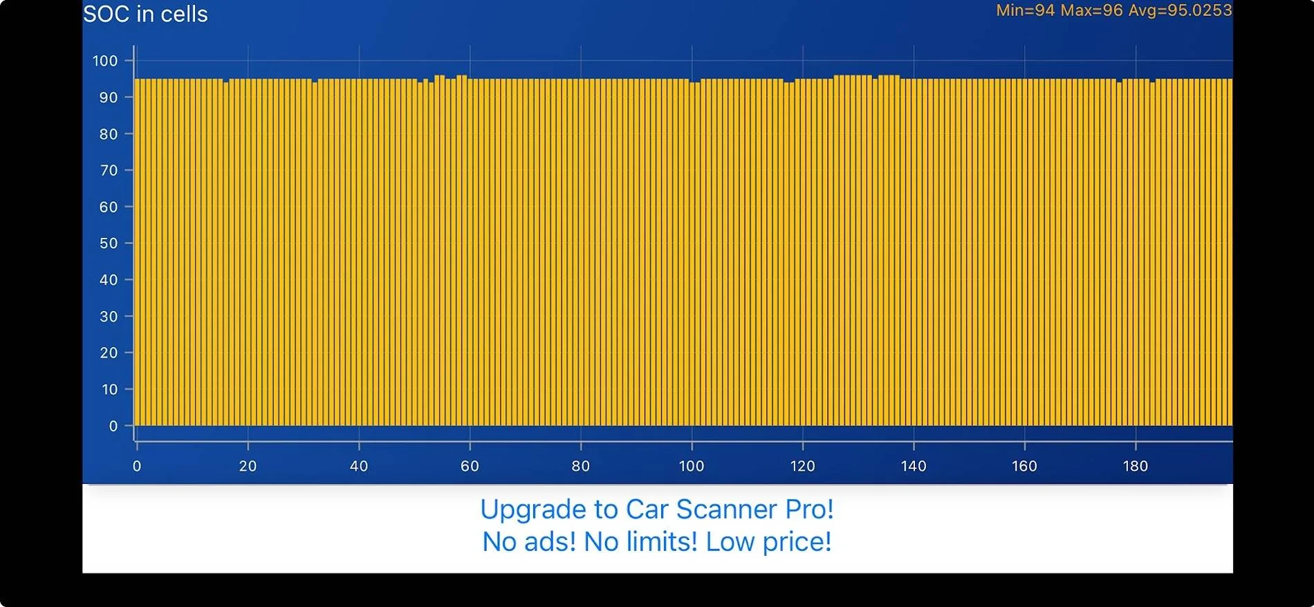

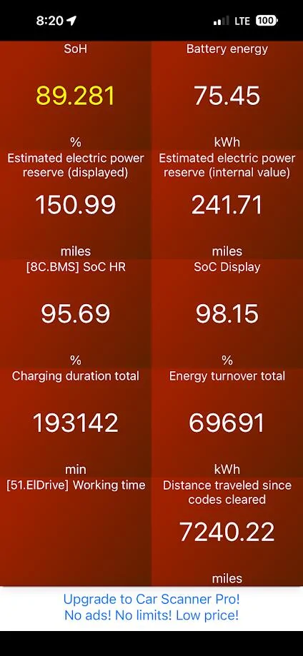

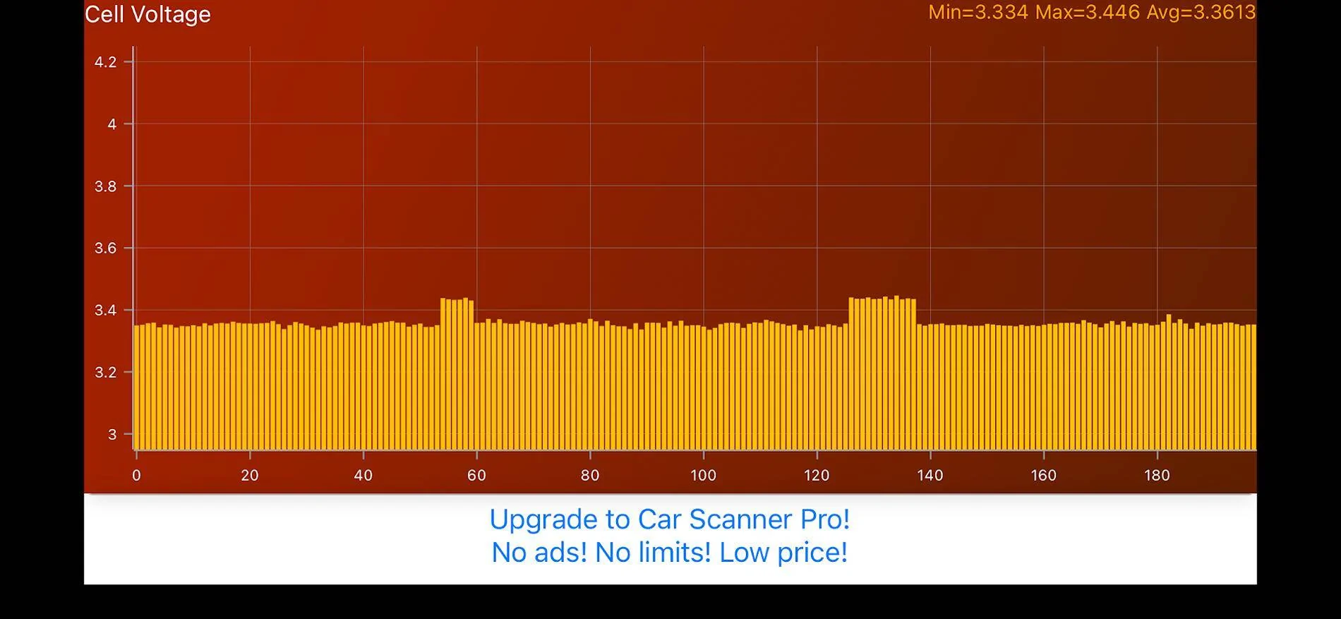

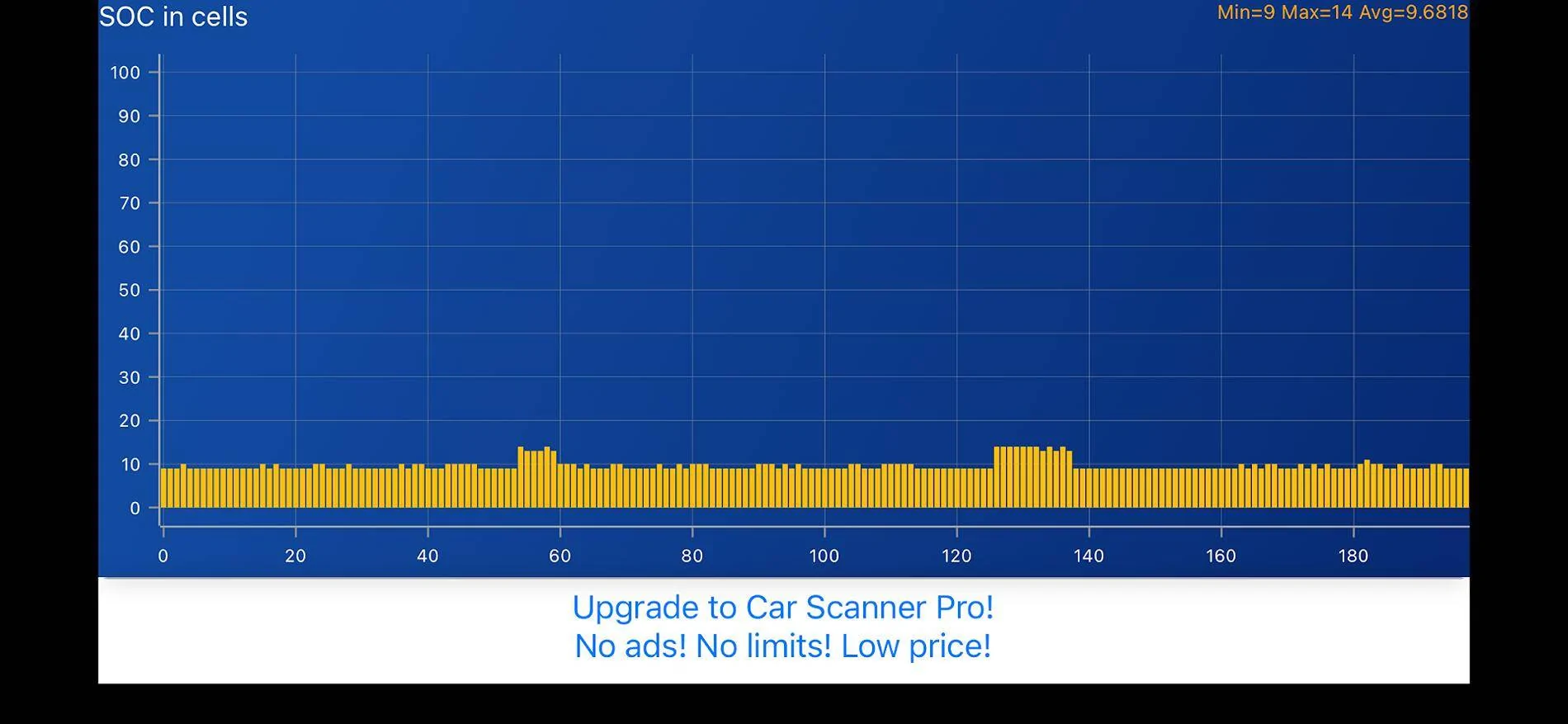

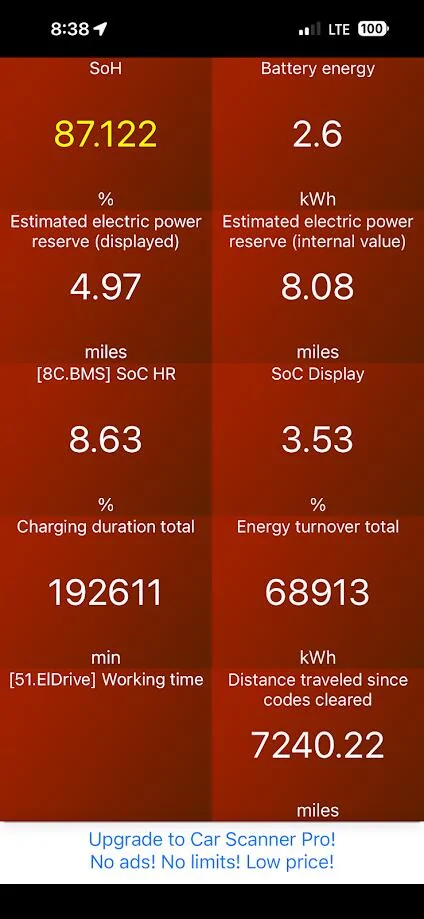

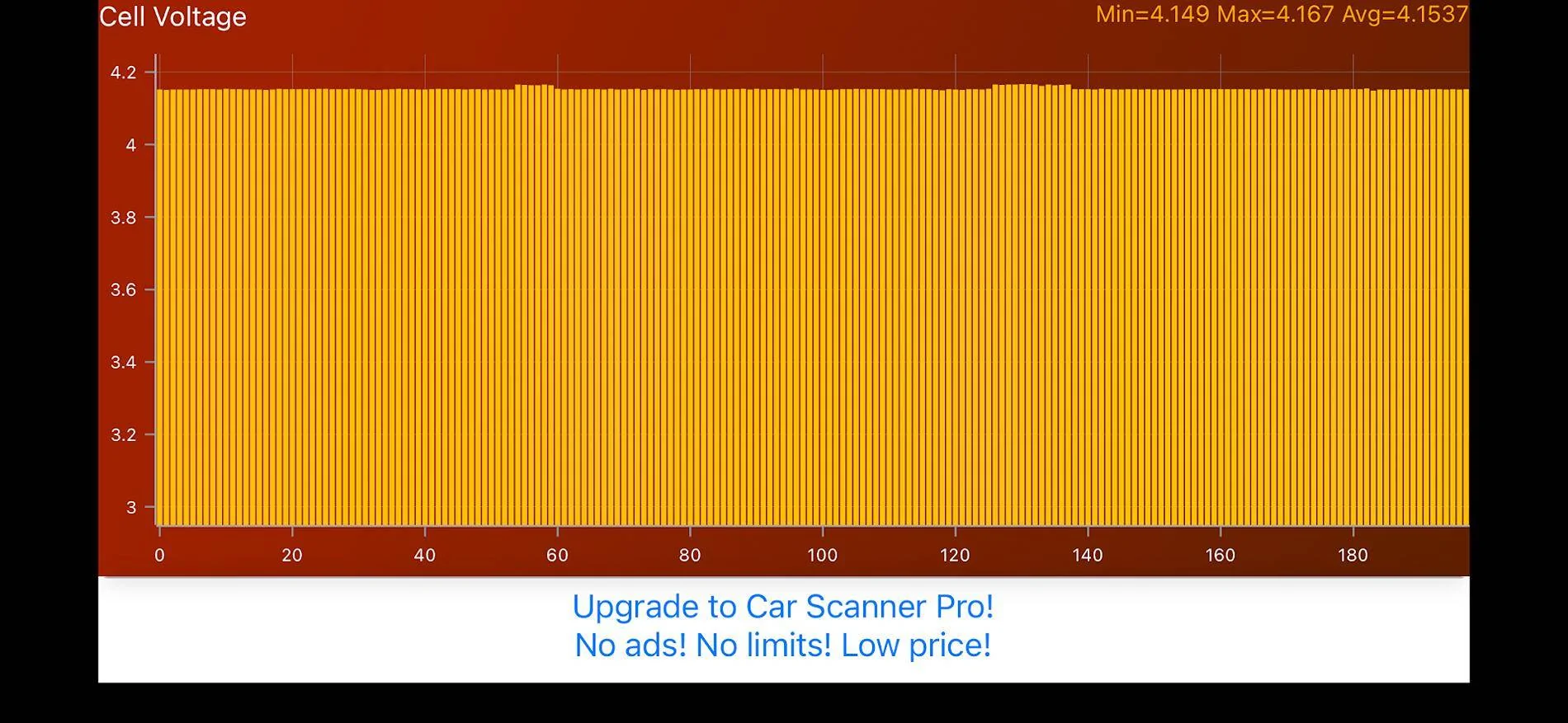

Some further pre and post Data.
My car is 2020 4S, 22 inch Mission E, 24k miles, Lead Feet - vast majority of charging v. abusive on High Speed EA Chargers throughput its life, Car kept mainly in HOT climes, including 3 summers in California desert often at 100-120 degrees Fahrenheit (not used much in summer).
Process
1) ran down to 4% - left for 72 hours at that - carscanner "pre" readings taken.
2) charged at home using PWCC set at 40A or 8.8kw from 4% to 96%, left for 8 hours overnight.
3) Next Morning "post" readings taken.
Gained over 2% in SoH. Range at guessometer is about 7% higher than I would normally see - we will soon see in the real world.
Below first image is pre - second is post.
Porsche Taycan How-to Recalibrate your SoH. IMG_3490
Porsche Taycan How-to Recalibrate your SoH. IMG_3514
Porsche Taycan How-to Recalibrate your SoH. IMG_3493
Porsche Taycan How-to Recalibrate your SoH. IMG_3518
Porsche Taycan How-to Recalibrate your SoH. IMG_3499
Porsche Taycan How-to Recalibrate your SoH. IMG_3515

@CaliPorsche Thanks for the information.
Has your Taycan had any HV battery modules replaced?
Ever had any yellow or red electrical errors?
CaliPorsche
DAVE
Jul 14, 2023
239
249
California ??
2020 Taycan 4S, 2022 Cayenne S, 964 Widebody Speedster, AMG
yes - covered elsewhere here but 3 of the 33 modules were replaced in March this year
770
4,618
3,742
Ah, so it is likely that the modules with higher voltages in your diagrams are the ones that were replaced. And, if the dealer followed TSB, those modules have post-2020 battery chemistry.
CaliPorsche
DAVE
Jul 14, 2023
239
249
California ??
exactly .....
